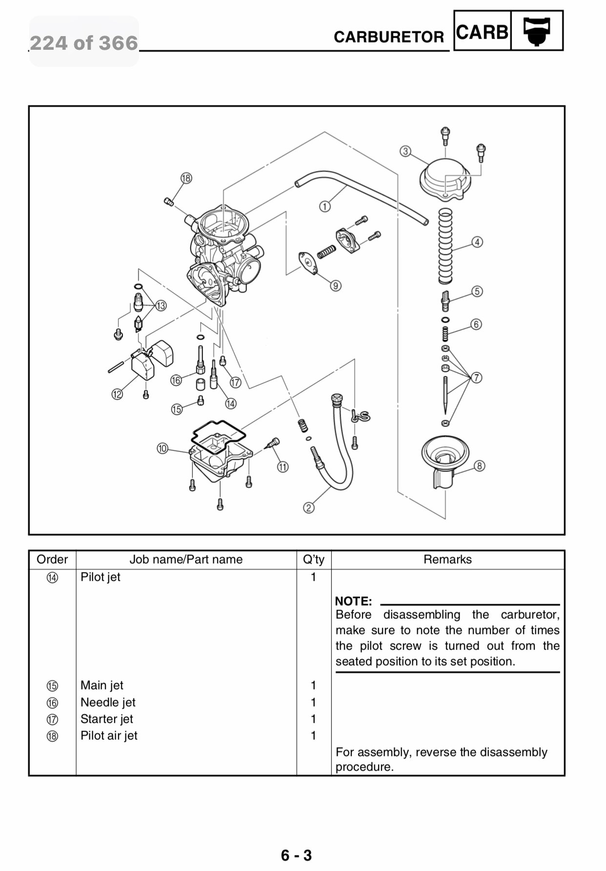

I would download the manual and start to go through the carburetor settings and even go as far as pulling off and cleaning it yourself.   Making sure that it’s properly dork and the right fuel/air screw was used in the carburetor when it was rebuilt.

Double check  your  carb..  Some carbs  have the  idle air needle , but also  have a  fuel   needle.  Here is a video on a carb either the same or very similar to the  constant  velocity carb you  have.  If there is a fuel  adjust valve , that is most likely  the one you  need to  adjust.  I didn't think  of it because my  carbs  have only  had the air bleed screws.

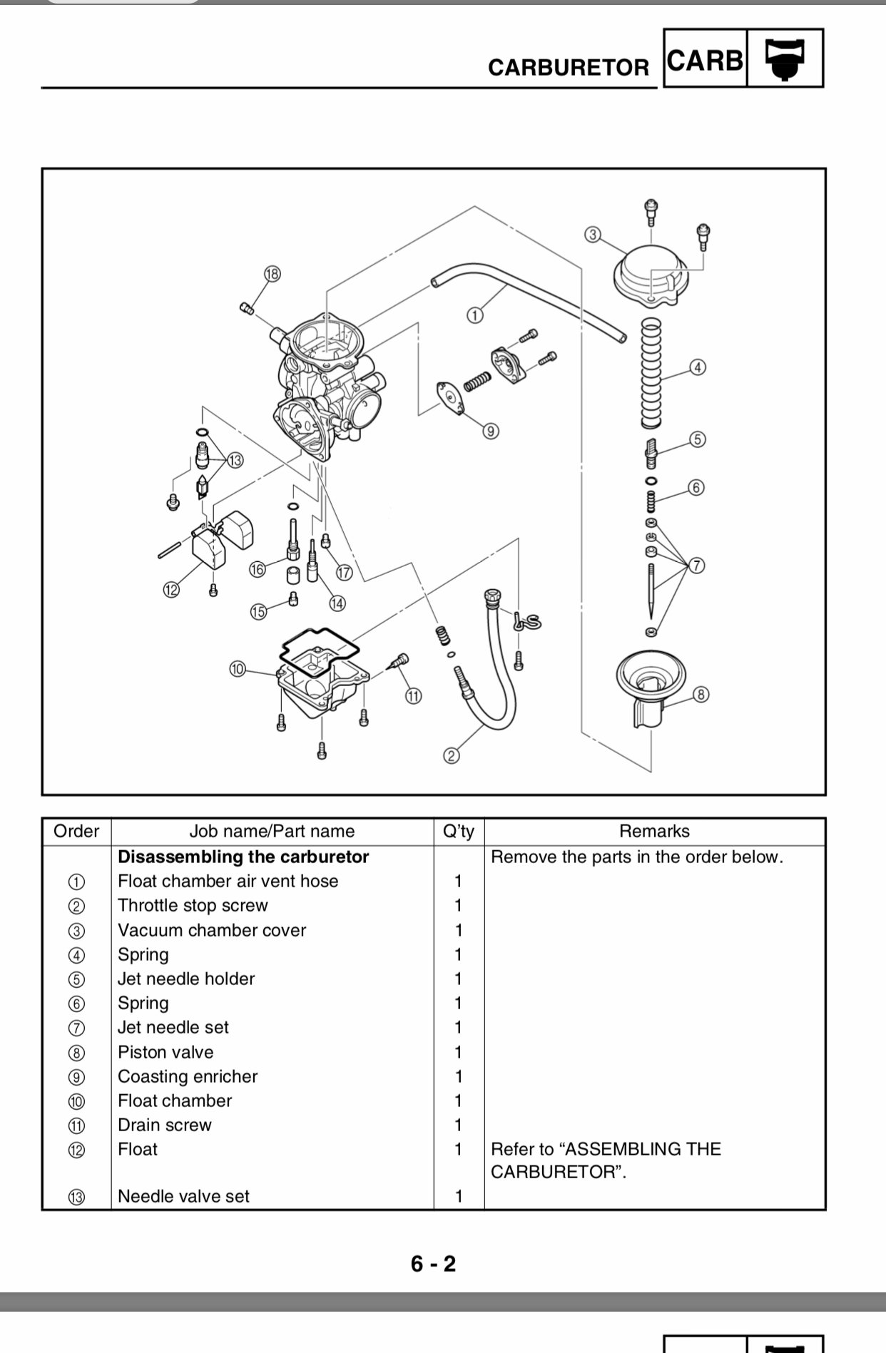

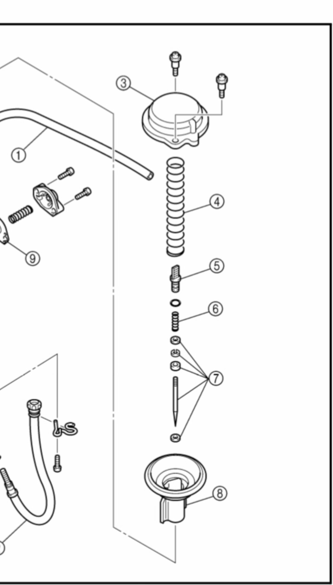

I'll buy the bike off you 🤣  haha  have you looked at the needle in the carb (frank can help me out as to what its called:wacko:)  In my carb, the needle was on its lowest setting (letting the most fuel through as possible)  I havnt got the carb back on the bike yet, but I'm hoping that will help solve my problem.  If you take off the top cap on your carb, there should be a spring and below that a needle that you see the top of.  If you take the whole rubber suction thingy out, you can get to the needle and adjust the c-clamp.
yep haha vacuum slide.  Lol I wouldnt have known that was there until @Frank Angerano said something about it for my kawasaki bayou.  And btw, the chinese carb didnt have a adjustable needle---  I had to back the air screw out almost all the way lol.  Thats why it was running kinda bad 😅
but yeah, when I got my chinese carb in for the polaris, the needle was set to the richest setting possible..  I moved it to the leanest  (highest on the needle) setting it offered, gonna see if that works...
