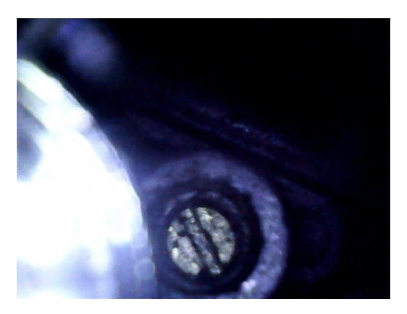

@pablo Blake sorry I didn't see that post about the screw.  So that is your air/fuel screw obviously.   You will see a lot of  threads down there so don't think its buried all the way.
Before you touch it what i always do is tighten it to a SNUG position and count the amount of turns that it takes before its snug. Should be in the two maybe two and a half turns in range.  Write that down because you will want to set it back at that position later on after the carburetor is cleaned out.
Adjusting that screw while the engine is running is quite challenging and takes a custom mini screwdriver and some small hands and patience.  There is a method to it as well by listening to the engine run.
The manual also tells you how many turns to set the screw at and it should be in the same area of where you found it.
