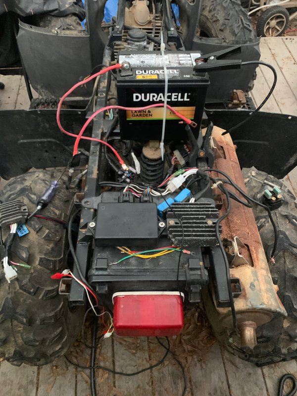

Well I found the problem I had a flawed wiring connection in my high tech testing facility.
IMG_3573.thumb.jpeg.c1eaa3eb058ddffd3162d96b17447ee8.jpegSee the red wire that's supposed to be hooked to the negative battery post, it goes down to a little short black wire hooked to the frame, the connection point that is now covered in black tape was the problem.

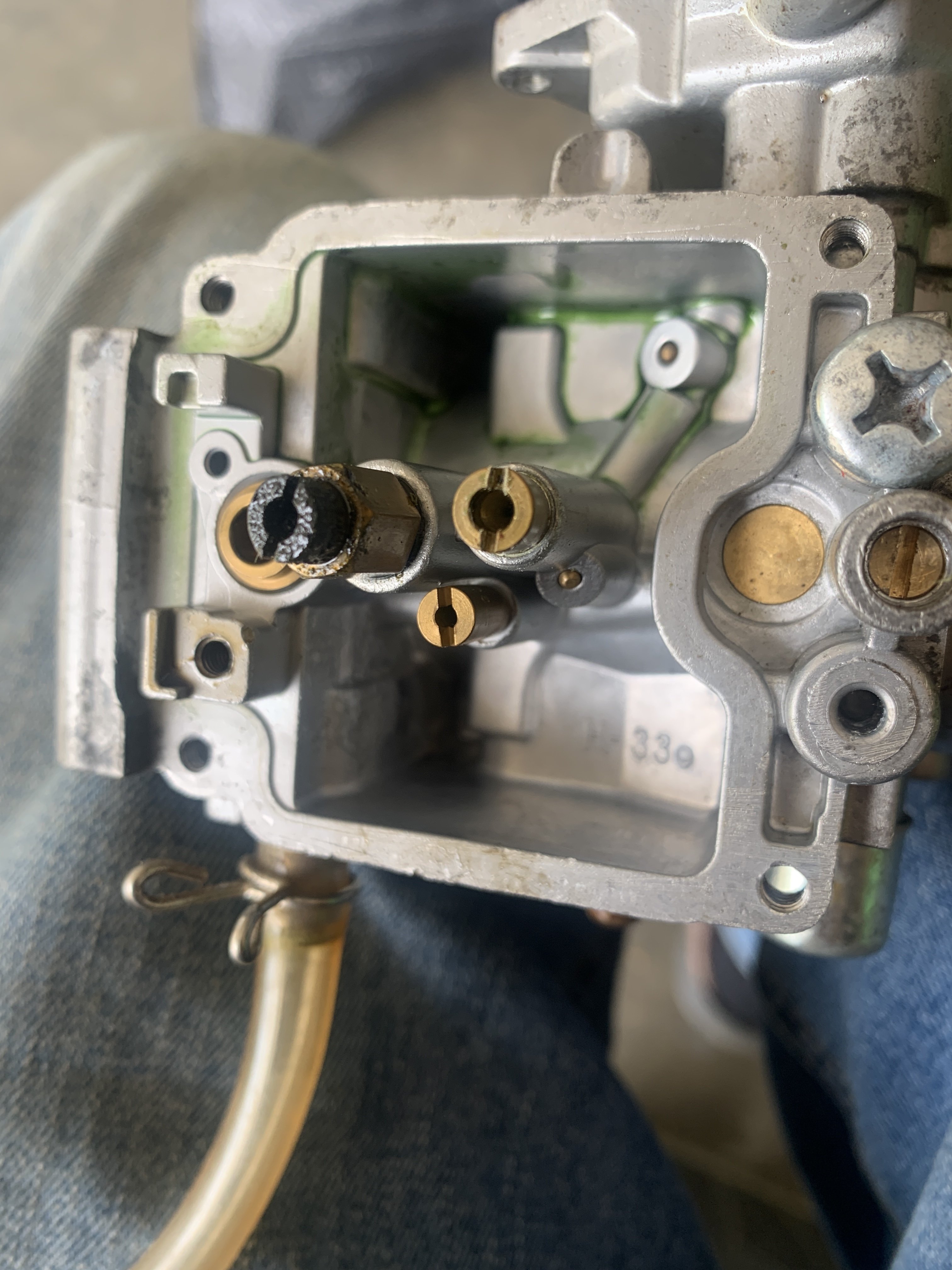

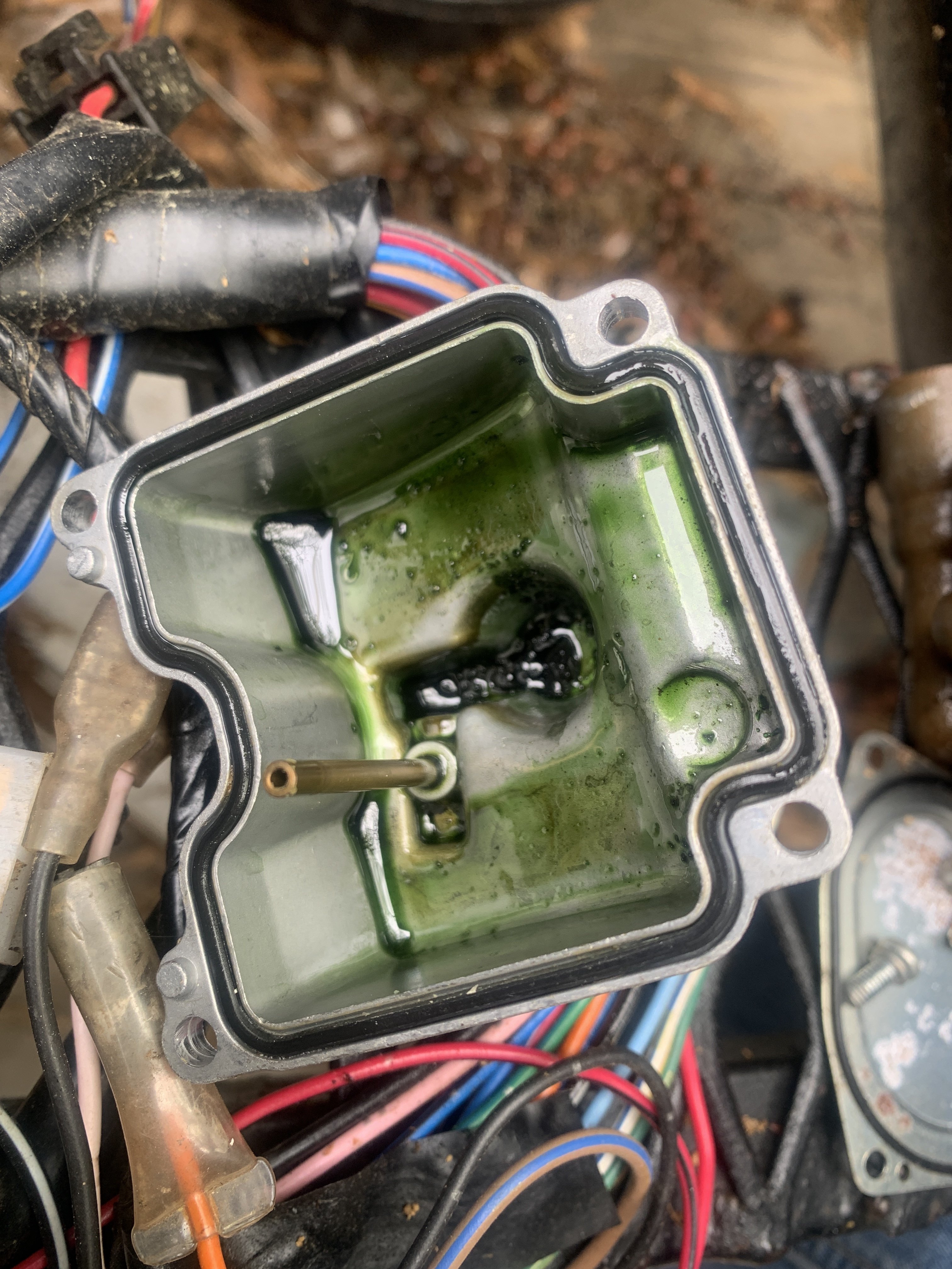

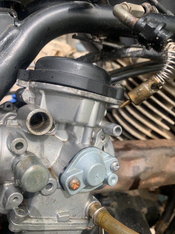

Still waiting on parts to get the big bear going, decided to take 5 minutes to pull the carb and check it out, it is an aftermarket, choke plunger was stuck an hr later after PB Blaster for corrosion and Berryman Chemtool for varnish I  finally got it out.
IMG_3580.thumb.jpg.a55696472d1629b2eeacf523a4186d44.jpgCarb was dirty but not as bad as I expected

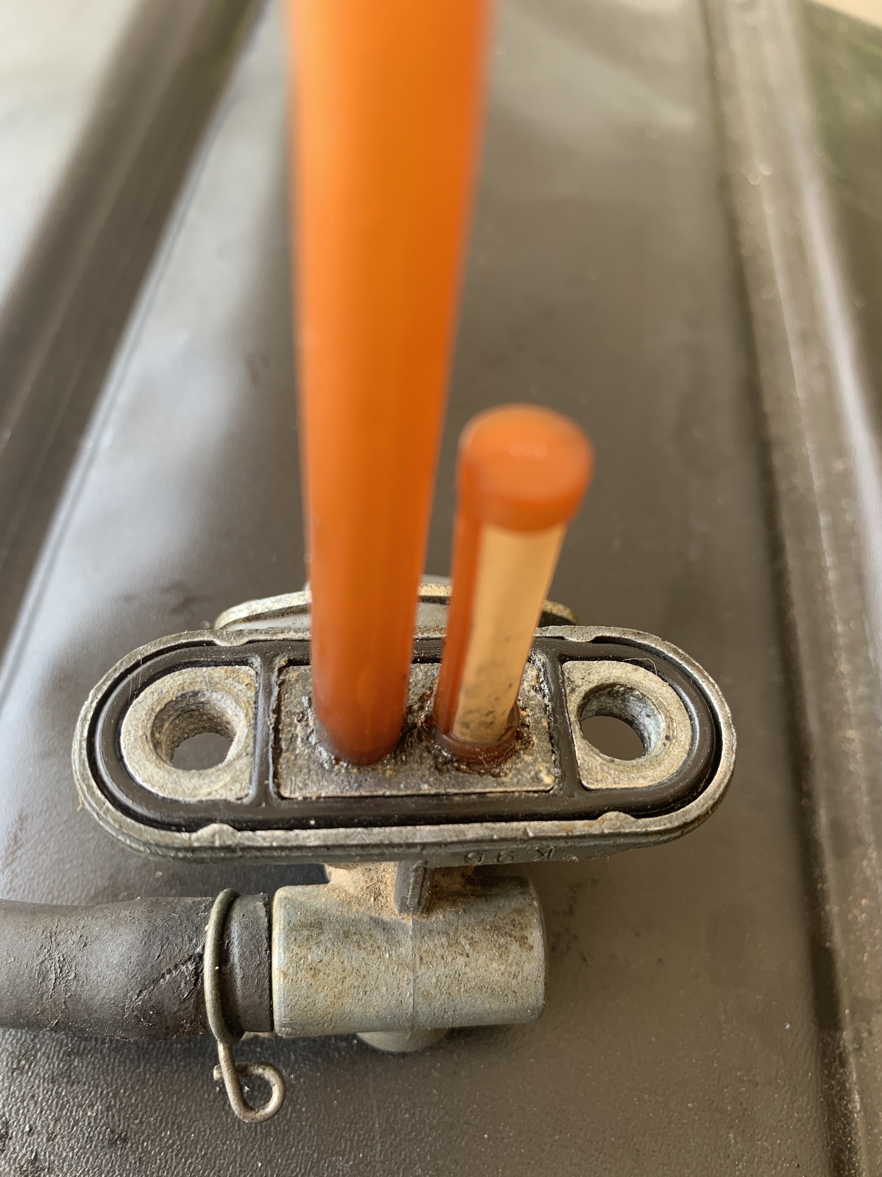

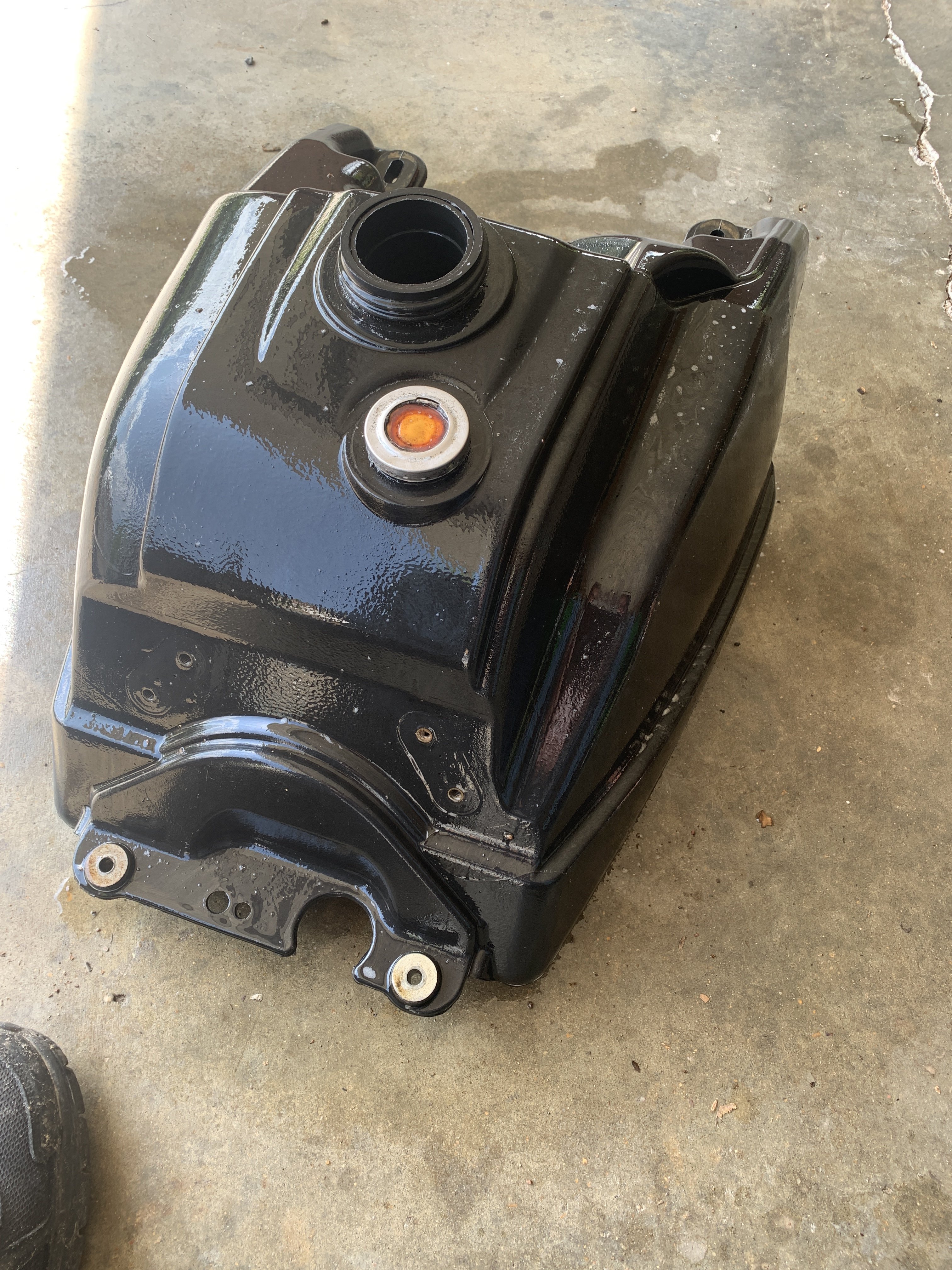

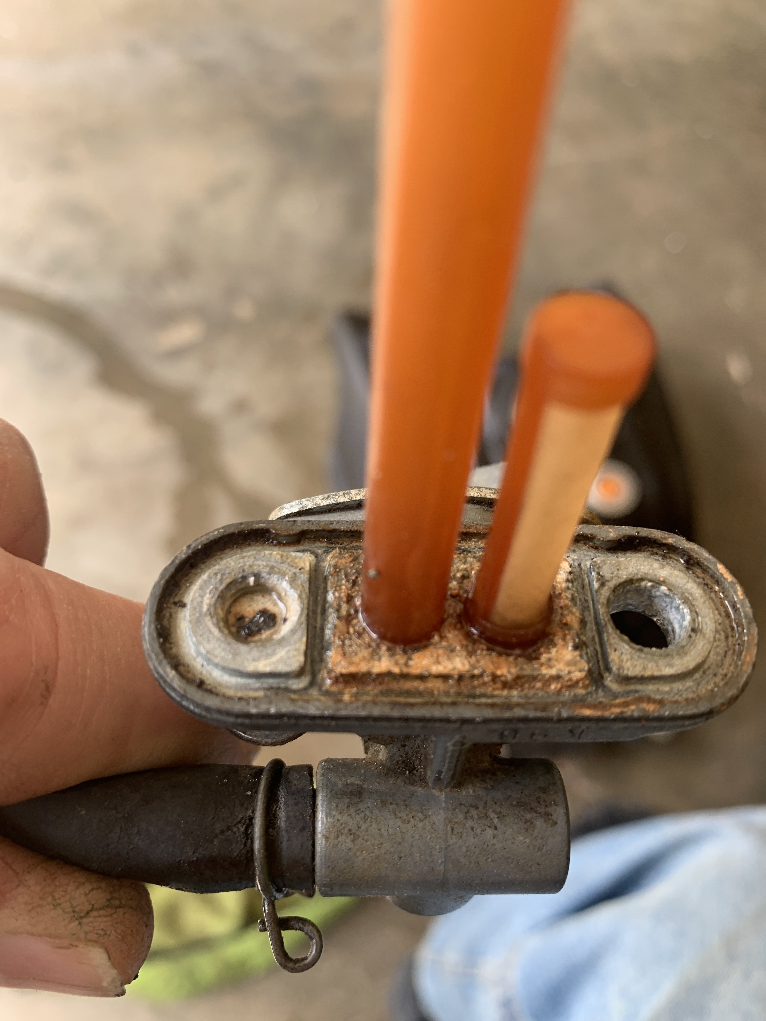

I got my parts in today opened the box and the gasket was broken, the joys of mail-order, still had to clean the tank and petcock out so started on that: not bad:
Tank was in. good shape, petcock not so much, but I cleaned it up, lots of corrosion under the gasket probably was leaking, if it leaks I will replace it, boring stuff but I thought I would share, I like to see photos of revival projects.

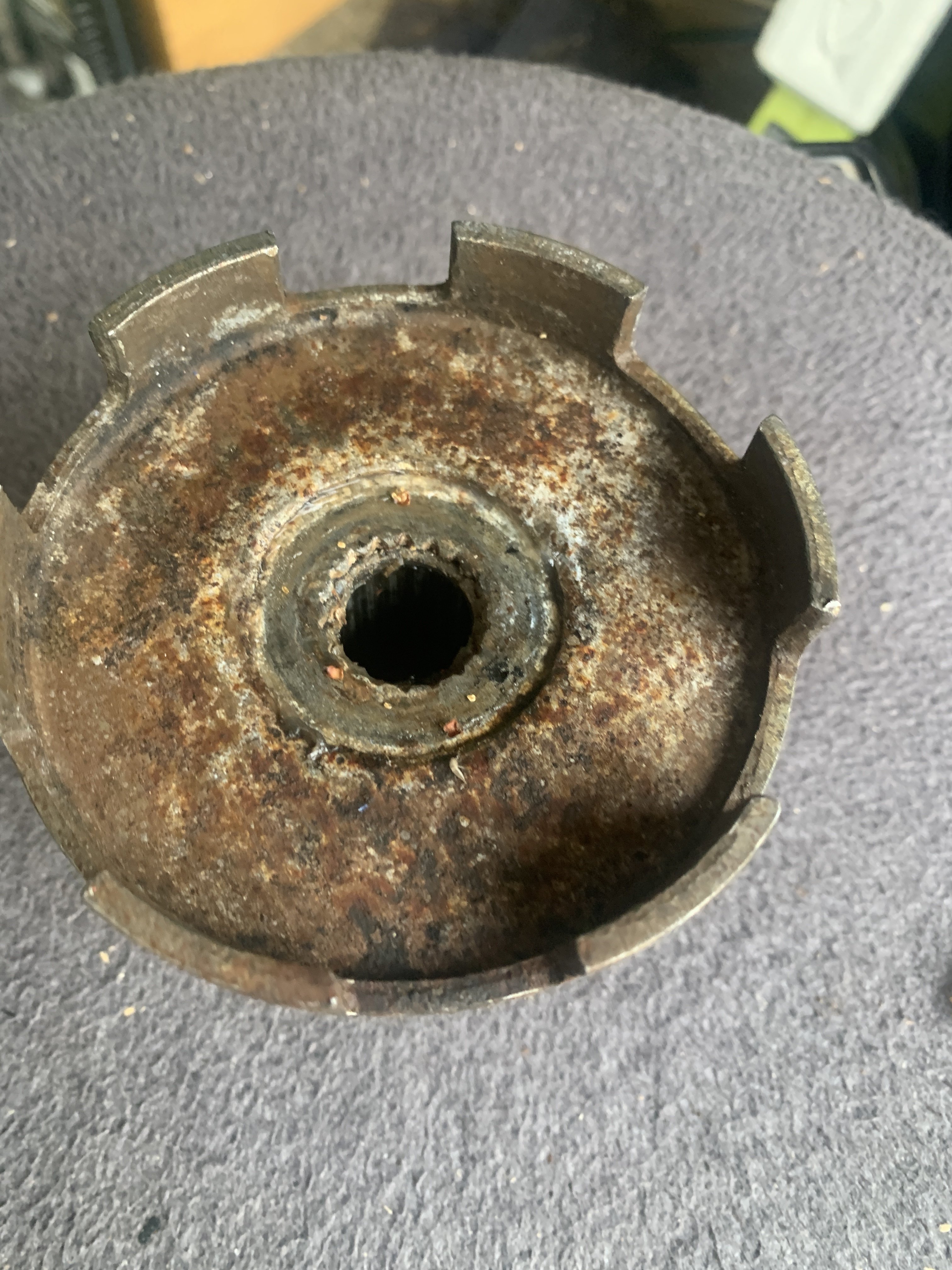

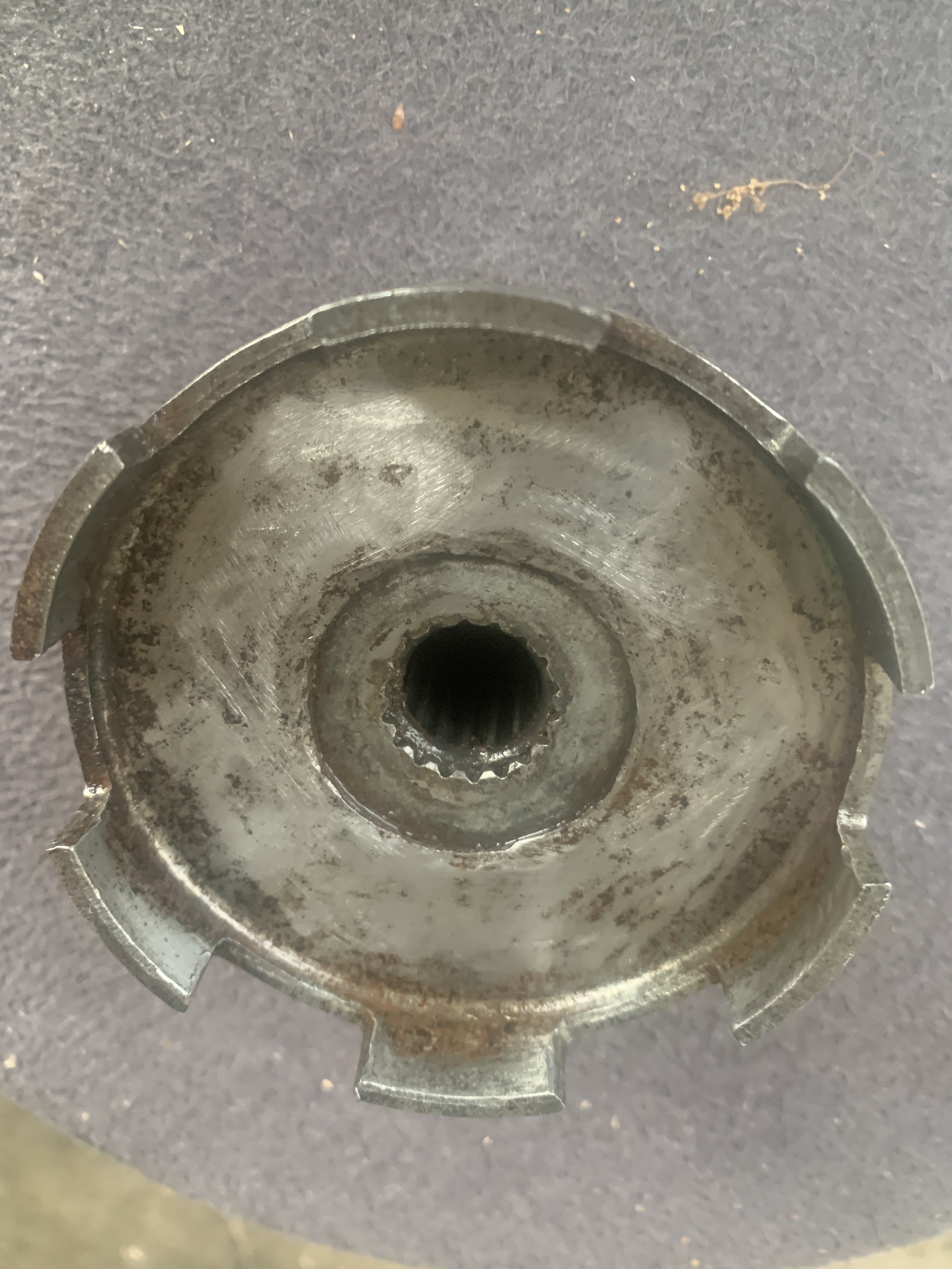

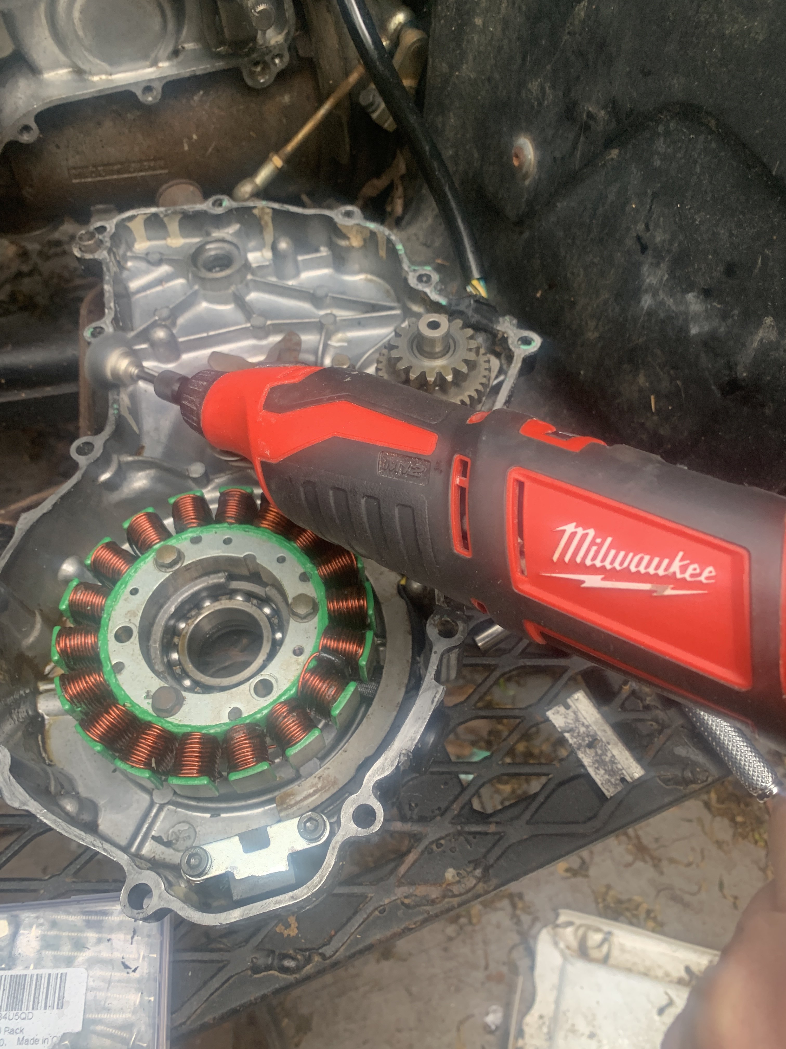

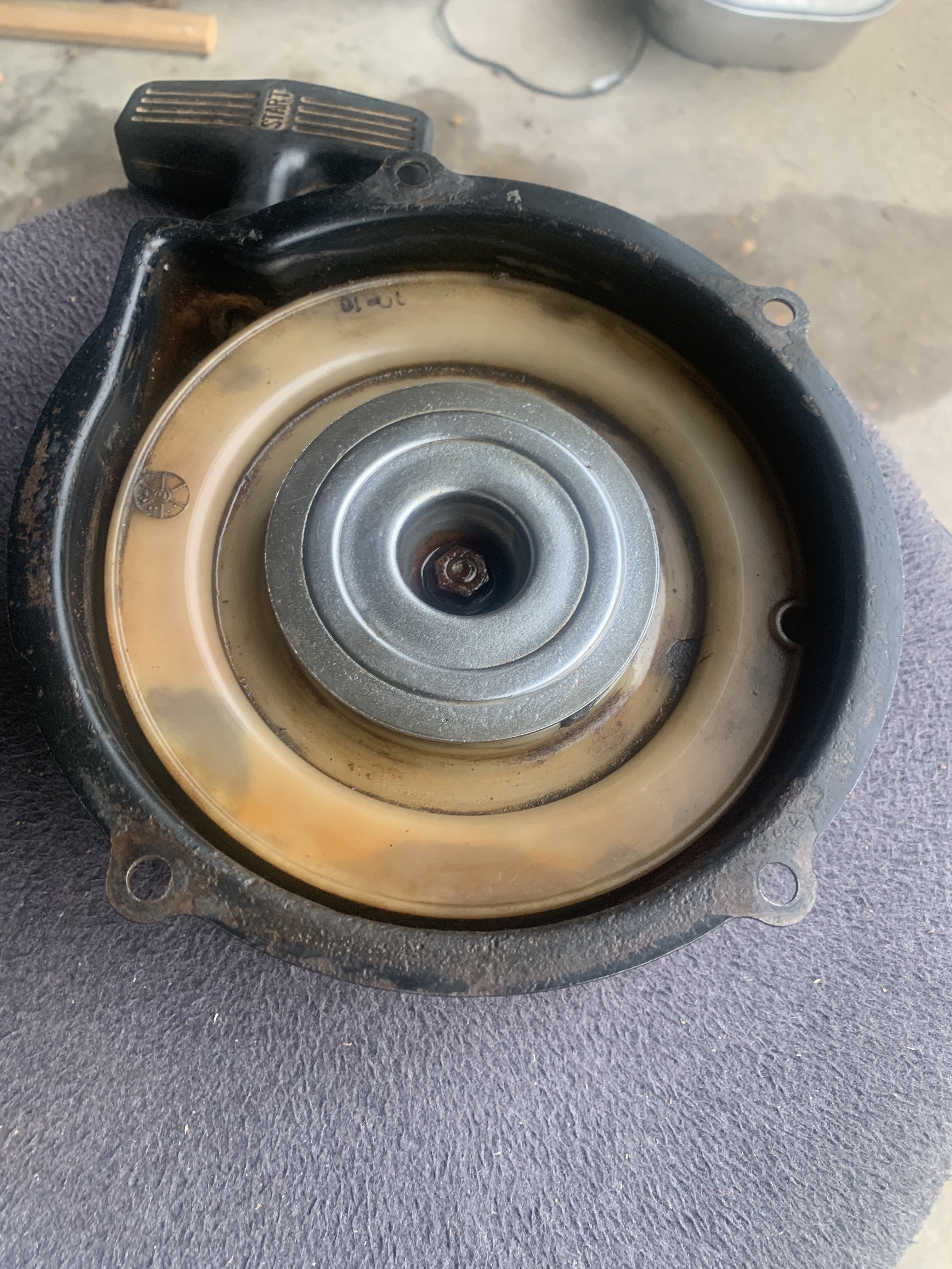

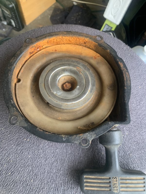

Went out today thought it might be a good idea to check the valve clearances while the tank was off, too bad I didn't think of that before I put the tank back on, so I took the tank back off, I could tell these bolts had never been removed from factory, intake was .003 perfect, range .002-.004 exhaust was .006 range.006-.008 I usually try to go middle of range but was good so didn't touch it. Pull starter needs attention, this bike was so neglected.
Really rusty no gasket, have to make one.
Cleaned up fairly well with the cheek poker.IMG_36113.thumb.jpg.59423e595d0f8cf1ff686e1741ea8a99.jpg

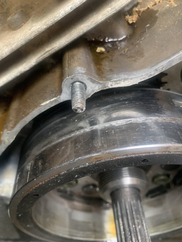

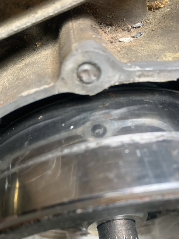

Found another obstacle I knew there were bolts missing, but not really expecting this, broken stud, not surprising the shape this thing was in, but its coming around.
IMG_3615.thumb.jpg.e5119e941186d0c30ae85d1cb3eb86a7.jpgGot it out with a little patience ,PB Blaster and hammer and chisel, I only use ease outs as a last resort, the small ones always break then you really have a problem.

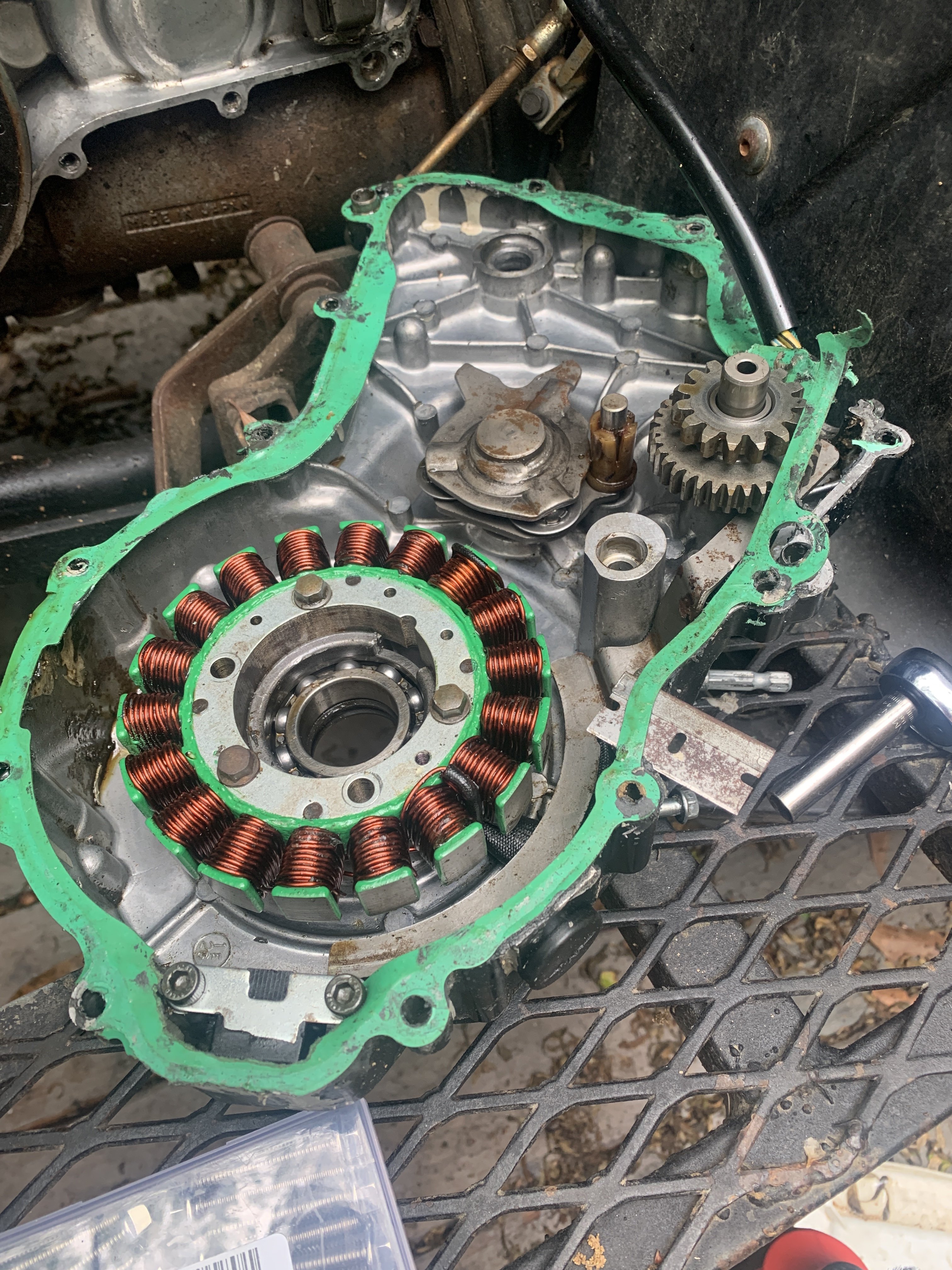

Got the new gasket installed on Saturday, aftermarket didn't quite fit only missed it by 5mm, I made it work but don't feels real secure, if it leaks I will get an OEM one, hadn't got it all back together yet but I torqued the bolts and had to know, shot a couple of shots of carb cleaner in the intake, fired right up first rotation, didn't run very long but it did run. When I get everything back together with gas I can tell more about it.
That could have been the problem with the gasket, but it was not a material that im used to seeing a gasket made out of, it was not like gasket material, was like paper but plastic coated or something, but not rubber. In fact its exactly like the one that came off of it that green color.
I was surprised it started so easily after sitting so long and stuck engine. Its certainly come a long way, the oil is starting to look milky again so their was still water in the engine that didn't come out when I drained it, I v got to add a couple of quarts run it a little and then change it again, its looking promising if it will move, hadn't tried. that yet.

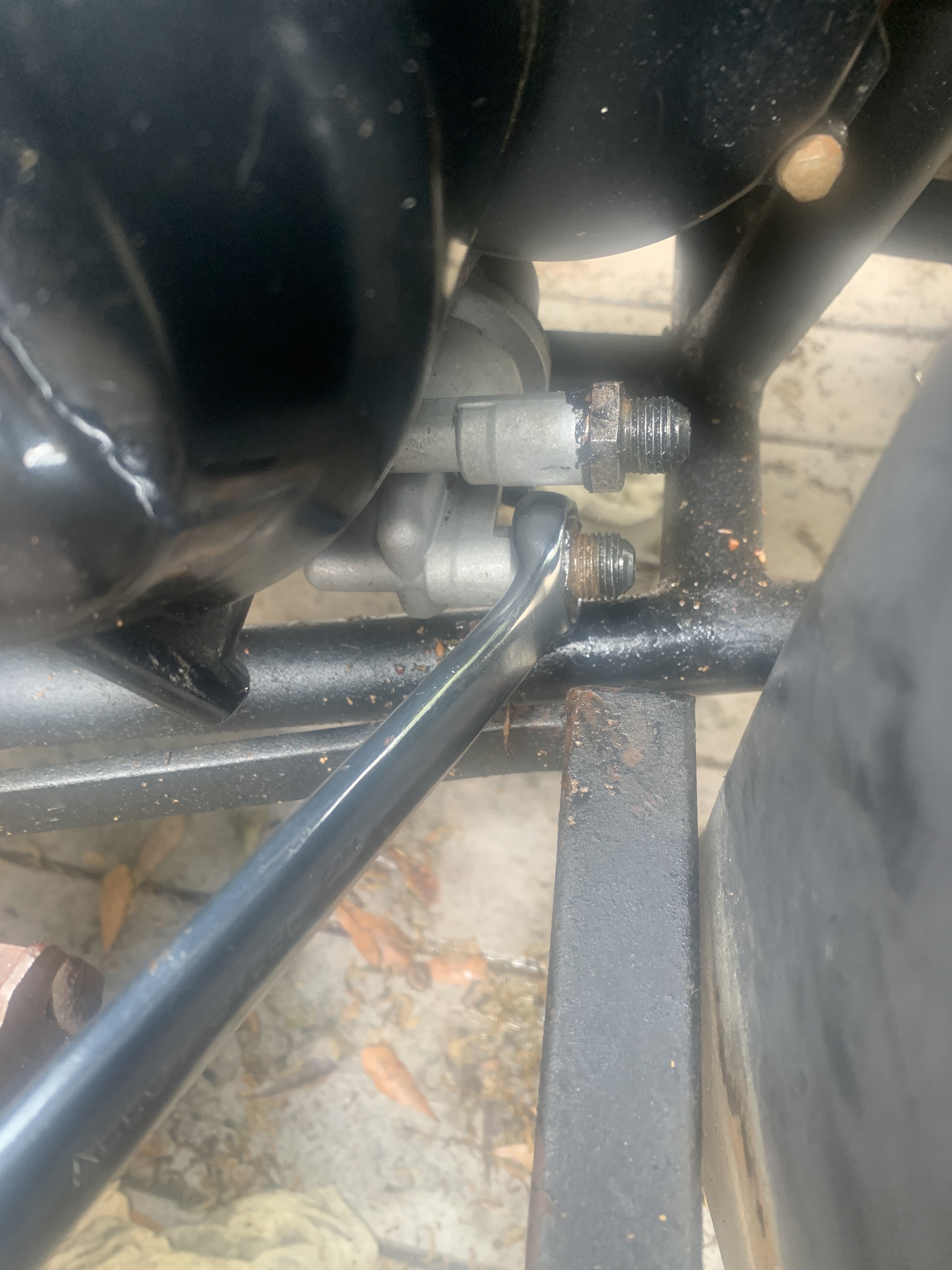

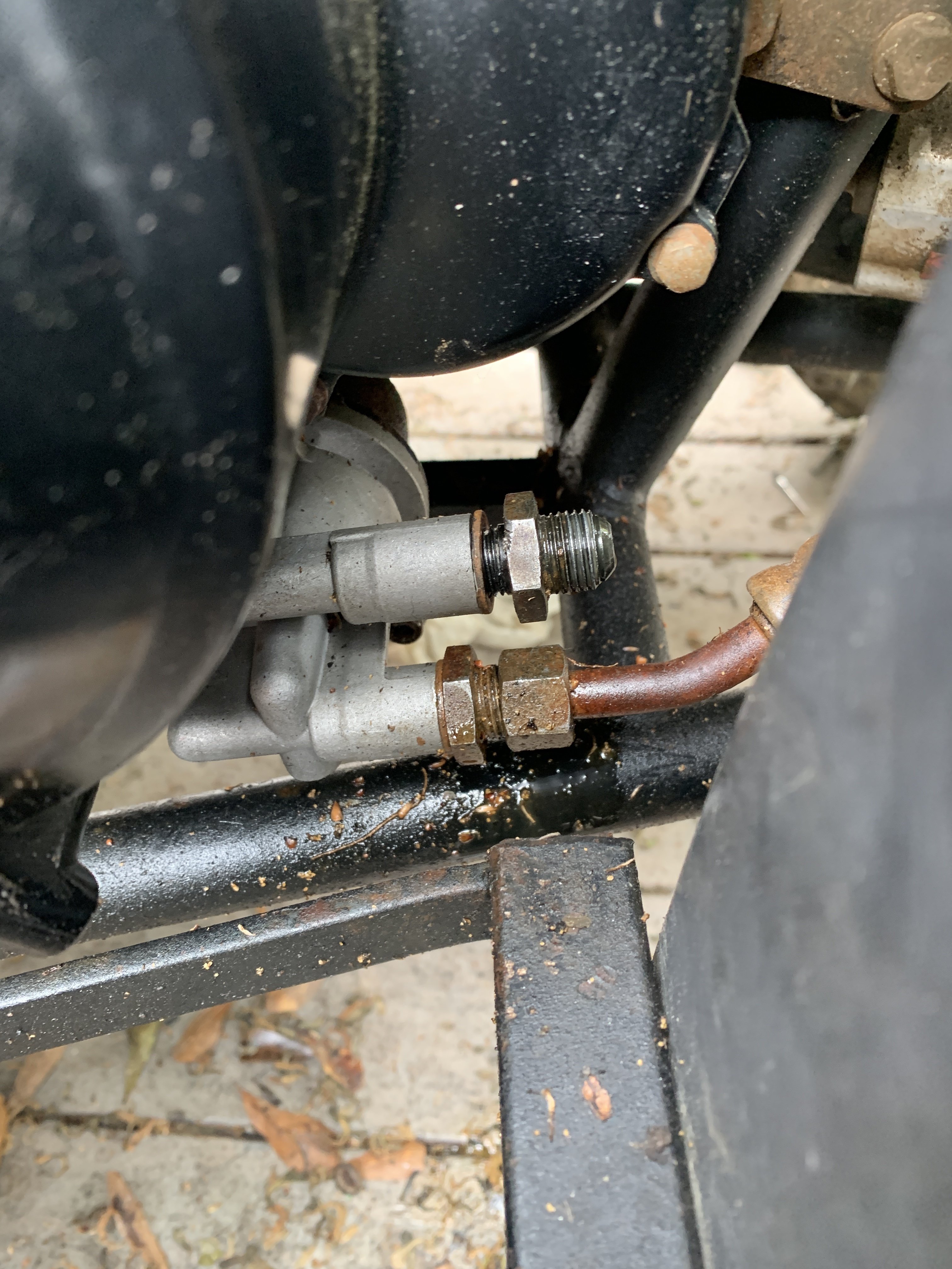

Th gasket seems to be holding for now, but I did have a small oil leak at the oil cooler connection, I knew it was a potential problem area when I installed the new filter housingIMG_36372.thumb.jpg.f81ef3effe91e148b35676db530747cb.jpgI didn't replace the copper gaskets thought they would reseal and they may have if I would have had a 23mm socket to get them tight enough. Got them out, reinstalled using Honda Bond #4 on the threads, I couldn't find my Yamabond. Scrounged around and found a 23mm box end, worked perfectly. The bottom one was so close to the frame rail couldn't use much else. Should have put them on before I installed the housing , but thought I could get them tighter one it was installed. Not high tech stuff, but might help someone that has to do this.IMG_3638.thumb.jpg.75eee3dc8f2d8698e82d435effe5378f.jpg
