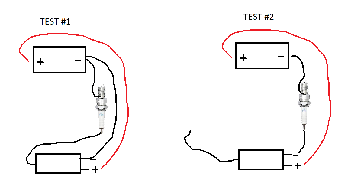

If you connect the sparkplug and the jumper to the coils negative terminal, and then just rub the positive jumper clamp on the primary positive terminal it should make and break contact as it scrapes along and make several sparks.
I went out and did another test run, this time actually following your instructions here, jumper from coil negative to sparkplug (w/o coil cap), then jumper from spark plug to battery negative. Coil positive jumper scraping battery positive... not a sign of a spark, tried two spark plugs just to be sure.
Hopefully my drawing is clear enough, test #1 is described in my previous message, test #2 is my latest test in this message..
/ Pär
Test one should have made heaps of sparks at the plug if the jumper was scratching over the coil's terminal..
You need a new coil and it should be a quite high resistance one..  About 2-4 Ohms..

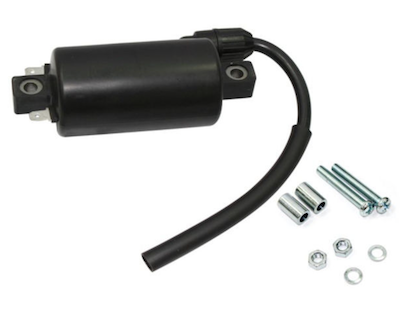

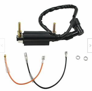

Okay, I ordered 2 coils, one from a local dealer (the one without spark plug cap, 40USD) and one from China (with spark plug cap, 10USD). Hopefully I'll get the local coil next week, delivery from China will take three weeks.
For reference I took screenshots of the units I ordered, I'll leave links here as well. When I get them I'll measure the resistance and post it here. Fingers crossed that they will get my Bayou running :)
https://www.merafritid.se/tändspole-kawasaki from Sweden
https://www.ebay.com/itm/393606999077 from China
/ Pär

Today the locally bought coil arrived, and this one has the primary out of spec and the secondary in spec.. :P Primary resistance 4.7ohm, secondary 11.3kOhm. It's produced in China, it's not the same one as was mounted on the bike judging by it's size and material choices. I will hopefully have time to try it out today or tomorrow on the Bayou, hope it's this simple 🙏
