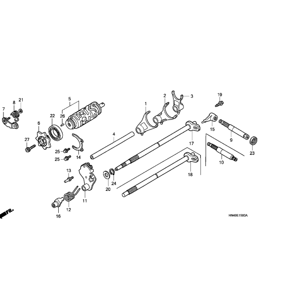

In this picture you can see how the shift lever shaft( 9 ), and arm (15), are meant to engage with shift shaft ( 17 ). If the arm 15 has come disconnected then you will have to try turning each shaft and try to get them to re-engage. Hopefully once they are engaged they will both move together. If they are already engaged, but jammed up so they won't move, then you are going to need to take the rear cover off  think, but before that I'd spend a bit of time trying pushing both shafts length ways, even though I don't think either are designed to move length ways, and try rotaating them both so they do disconnect and then try re connecting them. If the shift arm 15 is engaged properly it will move shift shaft 17 both directions with very little lost movement.
So.. recheck that the start washer is in fact getting every gear, then get the shift lever shaft and shift shaft working..  Then we can worry about why the electrical shift is working or not..  I suspect that once we have un-jammed the shift shafts the electric will work fine.

Ok, I turned the star washer and got five full sprockets on it then I turned it back the same until it wouldn’t go further and turned the switch on and the neutral light was on. As far as the shift spindle and the manual shifter I think # 15 is still positioned on the shaft #9.  I pushed the shift spindle back twisting it slightly, as it went. It has enough free play to twist it same as does the shaft #9. I eased the spindle back and twisting it I felt the part #15 because as I twisted the shaft #9 I felt it hit the #17 I could move the spindle when I twisted the manual shaft, so when I bumped them together I eased them apart pulling the spindle back just a hair twisted the spindle so that # 15 would turn down just a little and pushed them together I felt them hit and after that I could move the spindle back and forth with the free play that is in it with the manual shifter. They may be connected but I of course can’t be sure. And if the spindle moves out the connection will come undone again. Hope this is what you meant to do if not I’ll try again. Not pertaining to this I hit the hand brake and the brake lights came on. Will work on other electrical issues after this is solved (I hope it gets solved). Thanks again for your help and you too, GW. Looks like I may have spent more on tools than parts at least I hope that’s the way it works out. I can always use more tools. Thanks again.

It sounds like the two shaft/arms are now engaged. If you can turn the 17 clockwise and anti-clockwise by using the shift lever now, then that part is working, and free. Don't swing the manual lever too far though or it may disengage itself again..
It sounds like you have all the gears as well now, so we just need to get the shift shafts operating that star washer thingy..
So you've figured that the shaft 17 disengages if it moves forwards, so it depends on the front cover to prevent that happening when it's all together. In the mean time you'll have to watch it doesn't come out of mesh as you put the change mechanism 11 back on. Once that's on you can try changing the gears with the manual shift lever while rotating that gearbox shaft a lot..  rotating it continually till each gear slips into mesh under the influence of that roller on the start washer.

Ok, the sub-gear shaft the one the angle sensor goes on only turns a little just some free play the same amount of free play the manual shaft has. They don’t feel as if they are connected to anything else but each other. Neither of them reacts with the star washer or roller arm is moved. The sub-gear spindle is still locked up except for a little free play as well as free play in the manual shifter. That’s all they move.
Ok.. That "sub-gear" shaft..  That's shaft 17 is it ?
That shaft, 17, probably doesn't move much, perhaps only about..  err..  A 1/16 or 1/8 of a turn, It doesn't need to move much to change the gears.
