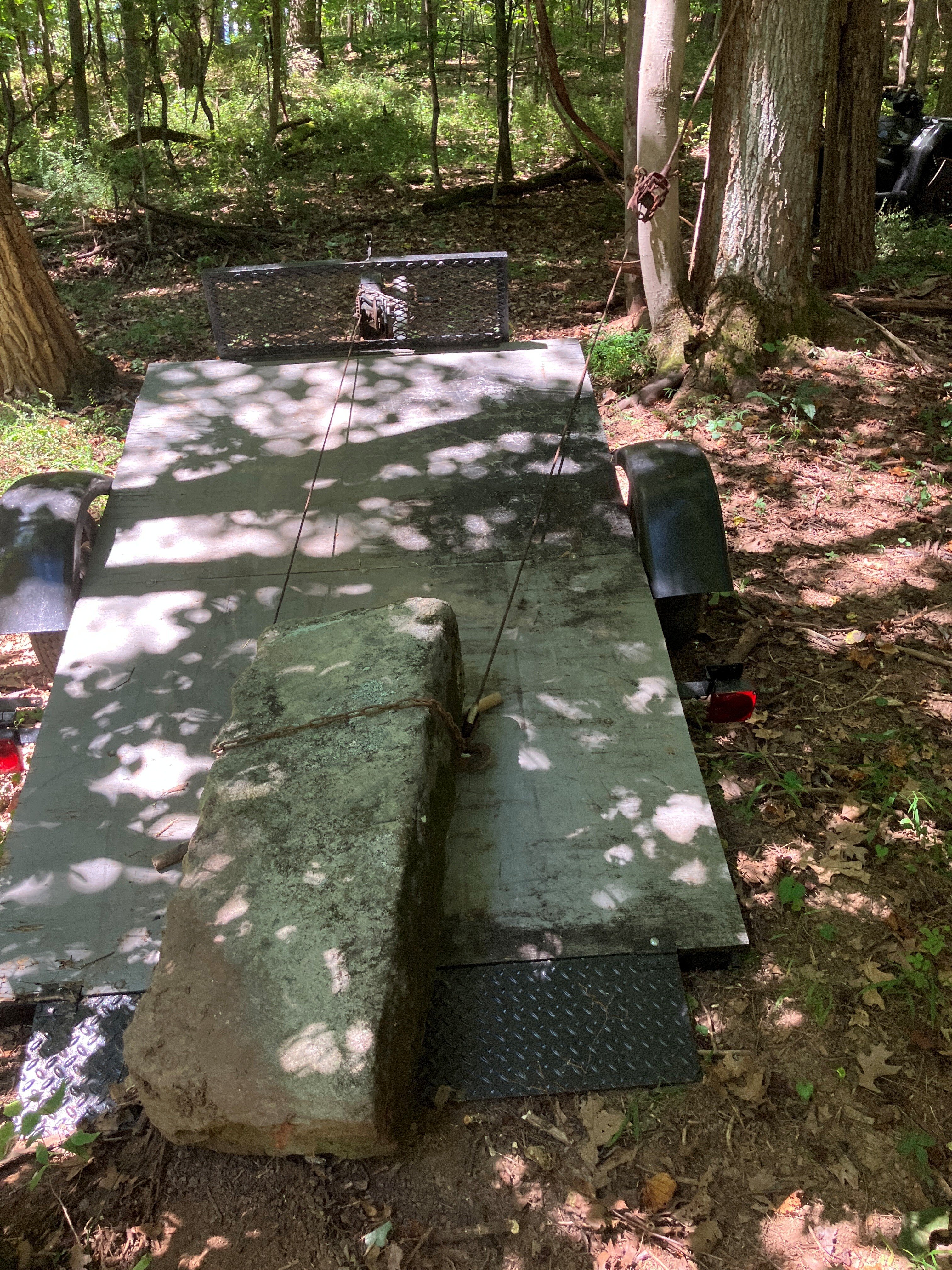

First  time using winch and hauling big foundation stones....Just wanted to see if I could...Typical I four wheel Forman can pull more than the winch as wich wll drag te foreman .
I have seen tat going uphill on snow ...Aas long as the jeep is pulling you can hold position...but lock up the brakes and try to stopand you're going to slide back down.  OMGimage.thumb.jpeg.13163f9bb309462884328ff4c35a3559.jpeg

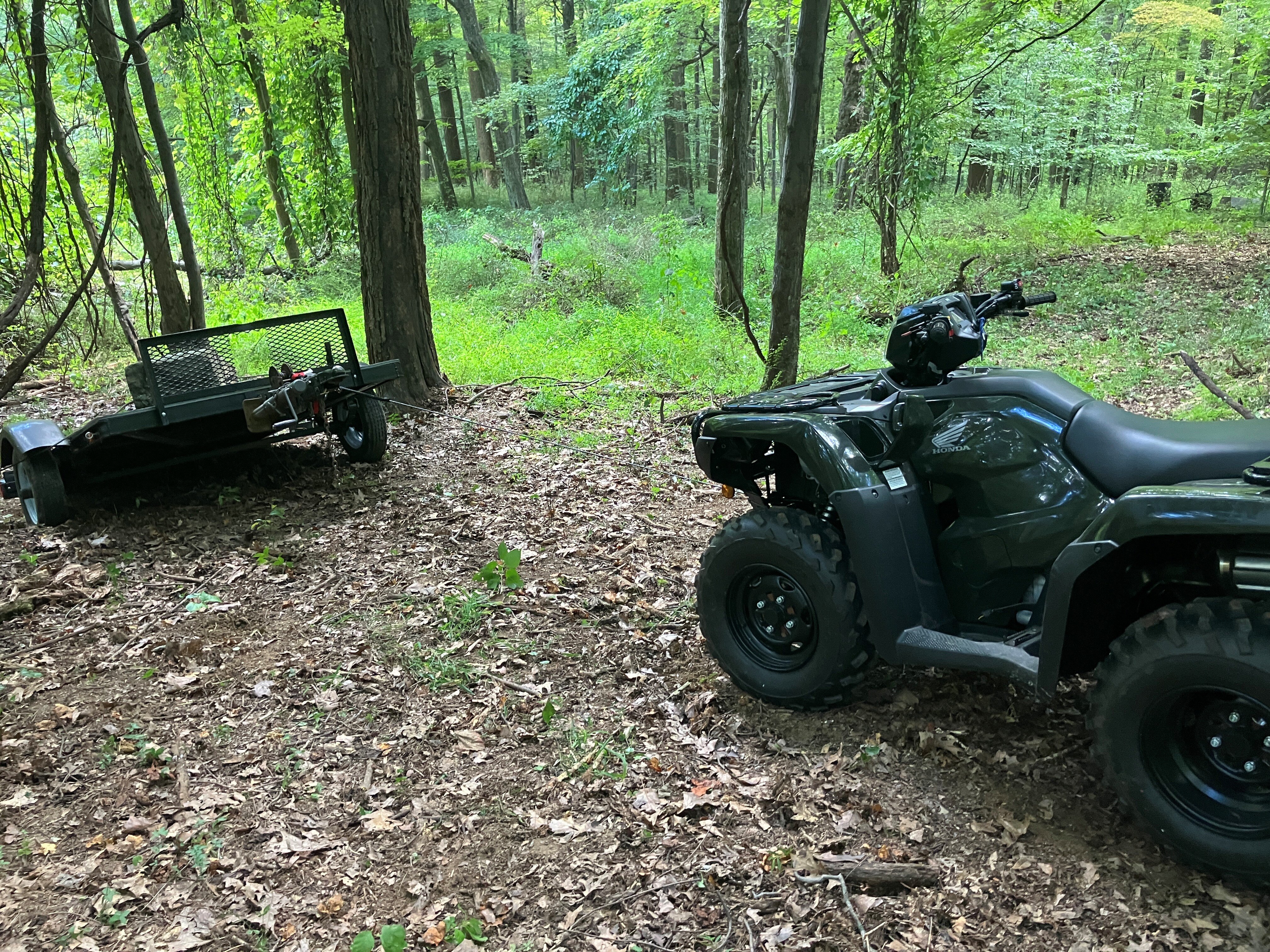

THe one trailer wheel was in a hole.  So i had to pull at the hitch and block the other wheel to leverge the wheel out.  THe Foreman was down hill of te trailer.  Forman's 3500 lb winch when hooked to the trailer tongue pulled me and Foreman up hill!...OMG...I put him in 4X4. and pulled the tongue to dislodge the stuck wheel.
Just playing around...That stone measured 17 X 12 x 44 inches   @ 150 lbs per cu ft   that's over 700 lbs...Did i calculate that correctly???

Nice to see it working for you all ready! -Quite the block of stone there!
the pic shows us pulling her out .  the right tailer wheel drops in a hole there.  I positioned Foreman downhill next to pull the right wheel out and swing the trailer out onto the trail.  I used two winches to pull the stone onto the trailer.  the tariler and a "fencce stretcher winch chined to a tree.

If you plan  on doing a lot of winching, or even  just to be "well equipped" for winching,  get a couple of "tree saver"  straps and a  choker cable.-  The straps protect  trees from damage by the winch cable and are handy for  connecting to  all sorts of things in a pull.  You can  use the choker as a short extension when a longer reach is needed or use it to  tie the rear of the quad to  something when the  quad is being dragged  by the pull rather than the object you want to  move.
The  "snatch block" on the winch line  can be used as you did to  change direction the winch pulls, or to  double the pulling power of the winch..   By  the way,  winches are usually rated pulling with a single wrap  on the drum, not by whether the snatch block is used..  As each wrap loads on the drum  the pulling power reduces.. A winch  rated  3500 # at   one wrap  may  only pull 500#  on  the  last wrap  of a full drum.
One  last thin I  can think of  is for those that may need to  winch when  there is nothing to  pull  against.   2 or preferably 3,   3ft.  iron  stakes either solid or  pipe  can  be driven  into the    ground at an angle and tied together in series top to bottom.  The  winch line is connected to the bottom  of the first stake to  pull  against.  The  other 2 stakes are  used to  keep  the  first from  being pulled forward and out  while  the  in ground  part of the first stake provides the anchor for the pull.  RT%he firmer the ground , the heavier load the stake will handle.

Having the two winches attached allowed me (I was by myself of course) to alternate pulling.  That had the effect of walking the stone up the trailer instead of a dead pull from one fence stretching winch attached to the tree.

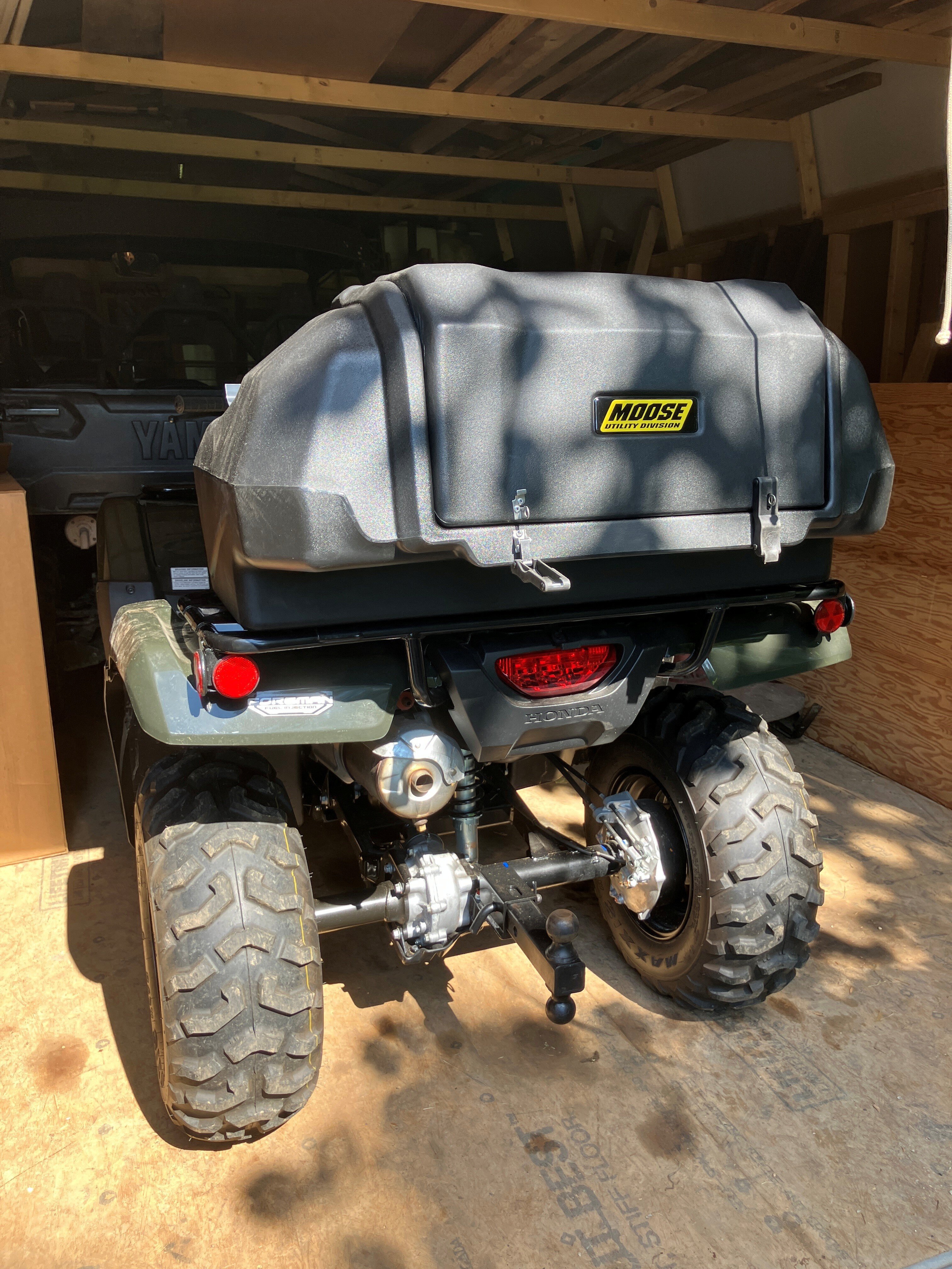

Ok I just  got " The Moose"  Rear mounted storage / seat ...for Foreman.   Love the name "Moose" every football team Had some big lunker guy named Moose...LOL.   The case is simple one compartment that will hold two full size helmets.   Moose and Foreman Yippeee!
The mounting instructions are simple.  However, I am thinking I should install some type of padding at the mounting points.  I hate things that rattle.  Also I should probably mount Moose all the way back on the rack???
