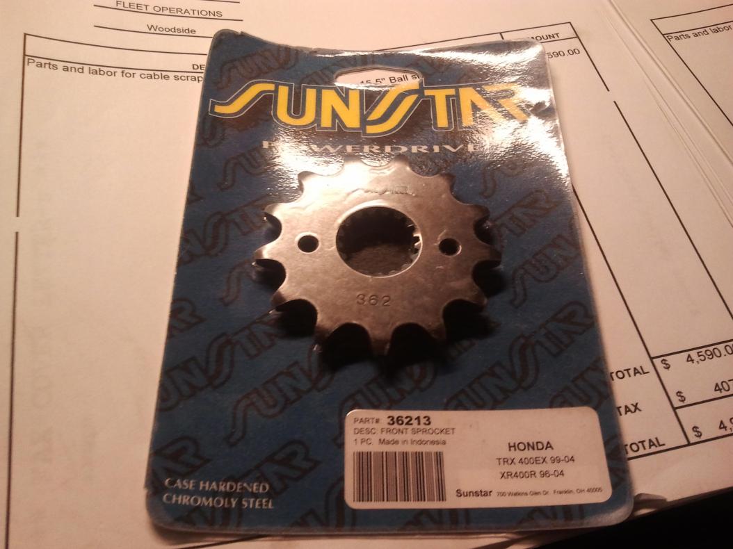

I know Im detuning but its getting annoying riding with an open airbox. I ordered a closed lid cuz sucking in water is not fun. I have the chain drive apart and im waiting for my 13t front sprocket to come in. That should make up for any torque loss with the closed box right?

I will probably lose about the same top speed as the 14T because I am also stepping up to a 22" rear tire. I wanted the torque of a 14T but with the taller tire it would be like resorting back to the stock 15T. A bigger rear sprocket is out of the question as Im trying to gain ground clearance.

I originally was gunna go with the 14t but i have so much ground clearance problems in the trails I need bigger tires. So why go with a 14t and a 22" rear tire. It would pretty much be like factory according to the gear chart. I do alot of walking speed riding and hate having to finesse the clutch all day to keep from stalling. I am usually behind a 4x4 so they are constantly speeding up and slowing down. My clutch fingers are huge now lol. This is all theory and i hope this combo once set up works for me.

no it wont it can give your bike more launch power but make your bike run slower in mph it will make your bike wheelie more your gear ratio will be differnt for every tooth you take off the front sprocket you will lose 3 teeth off the rear srocket your oem is a 15 -38 hondas biggest rear sproket is a 42 i would go with a 14-42 thts what i run on my bikebut my motor has been upgraded 4mil crank 460 big bore kit with astage 2 hot cam and a 38-42 electron carb on a open are box actualy the air box has been removed and added a k/n air filter but remember the more jetting done to your carb the more air is required.
