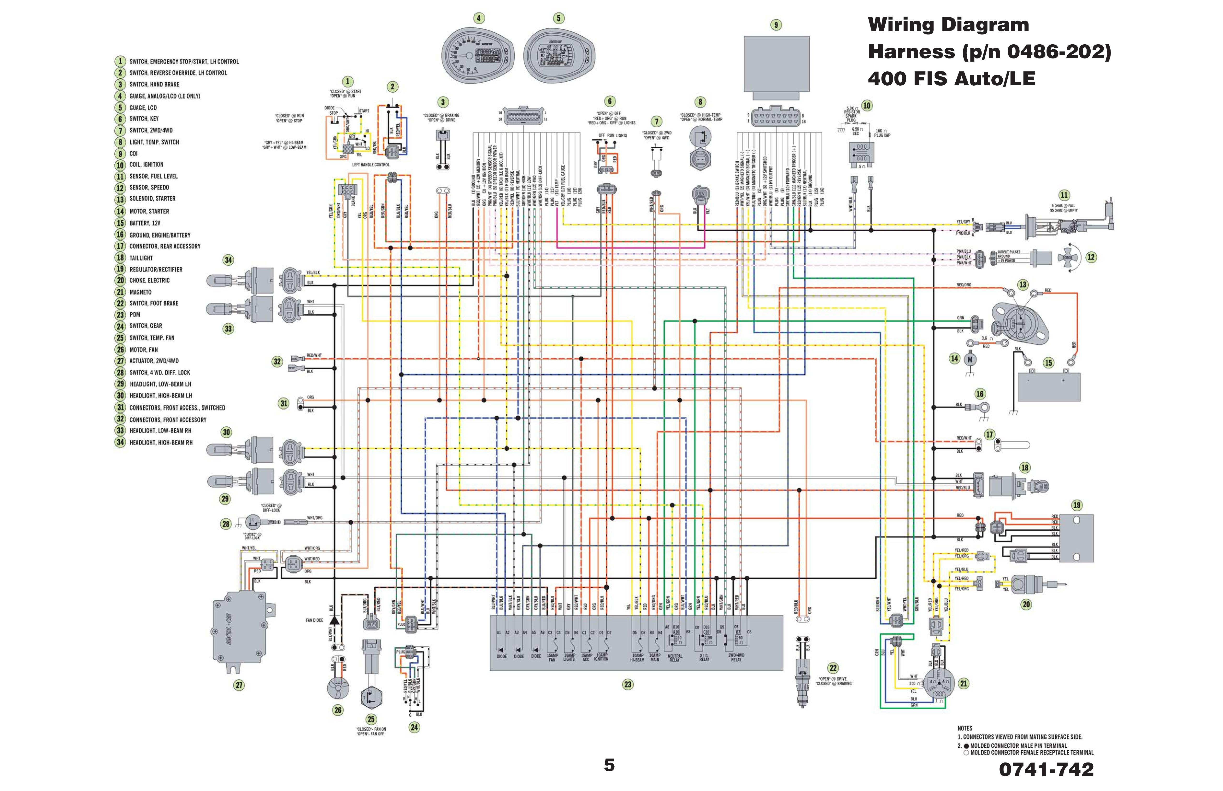

By Topendcol
First issue was fuel pump wont start once ignition has been turned on. Replaced the pump as I had one on hand, than noticed no power so replaced the fuel pump relay as that was were i traced the power to. Still nothing so further inspection looks like signal is coming from the PCM (FLR B20) but not switching the the brown wire to the fuel pump. Ive checked the operation of the bank angle sensor and it appears operational. Fuses and wiring all appear OK. The engine stop relay also tests OK. Ive been through the repair manual and diagrams but to no avail. Fully stumped, any tips would be helpful. Thanks
