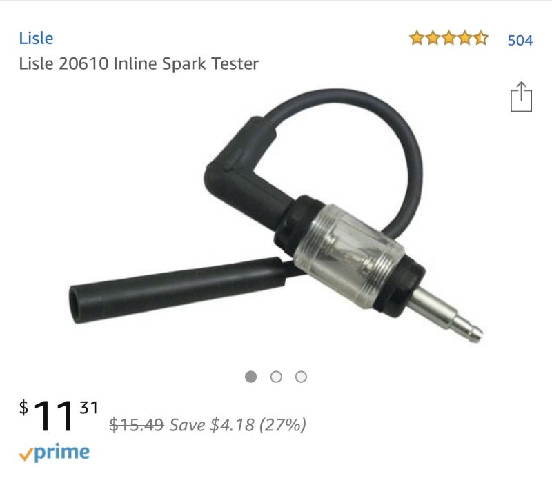

I purchased this spark tester and put it in line with the spark plug. Started and watched the spark break down/fail as I reved the bike.  I removed the rev limiter and my problem was solved.   Worth a shot and cheap enough to try. It’s also a good tool to have.

I attached  a pic of the spark tester.
