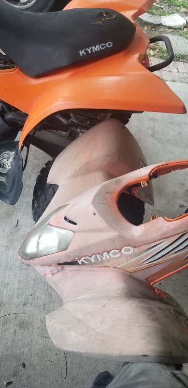

This should be fun. It's pretty clean. Doesn't start but by tomorrow night I'll have it going. 500 bucks. 2a929dce3bc28830ef905ea97a41a876.jpg

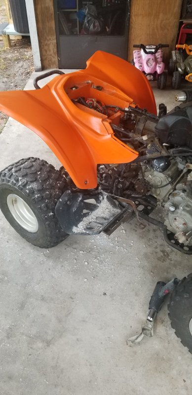

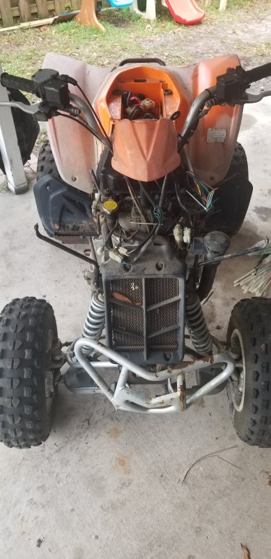

Okay. All clean inside from view of the sp. I put 2 stroke oil in it cause it will burn off anyway. I took a straw and stuck it in the qt container. Sealed the straw. Then blew into the sp hole. Let it sit and cranked over. I figured I would crank the hell out of it to lube the cylinder. But by the time that was said and done. The battery is dead. I did notice a few loose wires that I tightened
