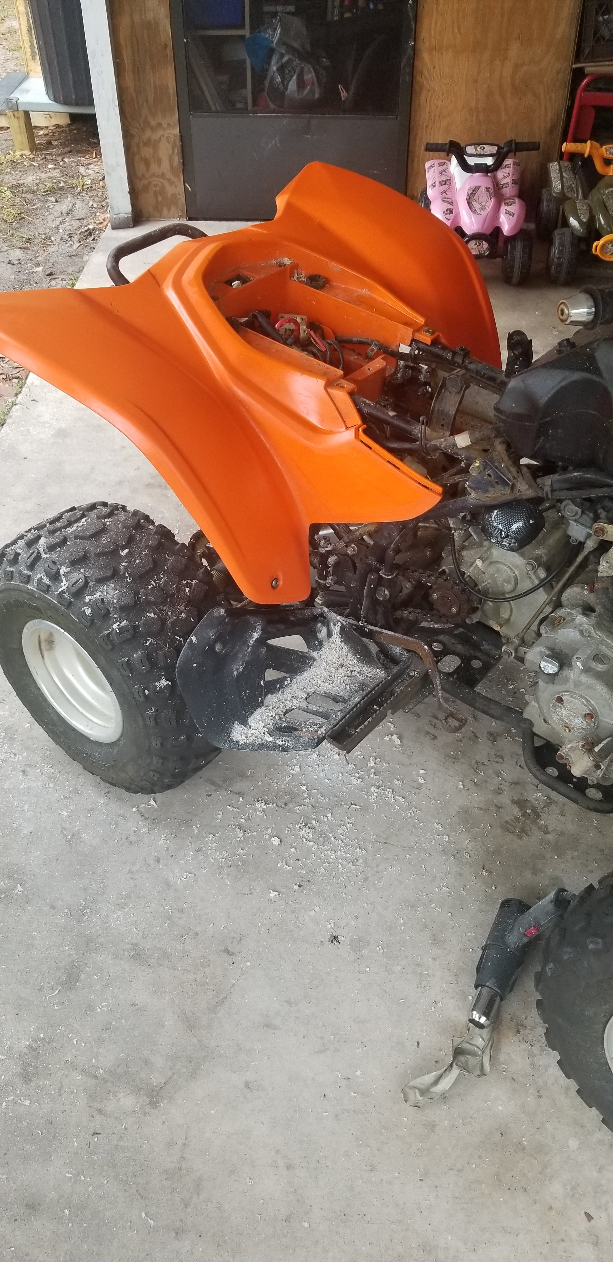

So today I worked on the Kymko and I cleaned the carburetor,very nasty stuff...I may have to buy a new one because the one that's on it,it's corroded inside where the main jet is,it missing bout 1/4 of the thread,but the jet still tightened up,but it was leaking from the bowl drain,I think the screw is bad,someone tried to rig the switch assembly with speaker wires,and some other random wire to the battery from the switch assembly,anyhow I got it started because for some reason I took the speaker wires out and tried fixing the switch assembly and rigged the ignition with 1 I had next thing you know I press the front brake and the Quad cranked right up,I was so confused, obviously there's an electrical problem,because it even does it with the rear brake,so I disconnected the rear brake switch and was starting the quad with the front brake on Neutral,but when I engaged the Reverse or Forward it would kill the engine.... Any Suggestions??? I'm buying new switch assembly and ignition.
Sent from my SM-N950U1 using Tapatalk
Nice work so far.   The screw on the bowl should have a small gasket or o ring on the screw.  Double check that.  And as far as corrosion on the carb, that can be cleaned with the a good carb break down and scrubbing.   As for the jest that’s missing a few threads well of it tightens down you should be good.
Electrical ! Something is missing that when you put the bike in gear it kills the ignition like a neutral safety switch tie in of some sort. Your loosing a ground when you put it in gear. When the break lever is pulled in and the bike is in neutral there is a wire that’s grounded to the starter relay that allows you to start the bike.  The same thing is happening for you when you put it in gear that you kill the engine.  So start going through the wiring slowly and see if anything stands out. Even a faulty ignition switch so double check that.
No what I meant was the carburetor itself it's missing about a 1/4 where the main jet screws in,I'll take a picture later on,Today my goal was to know if the engine was good,and it is,now I'll buy some new parts,and check the wiring carefully like you said...

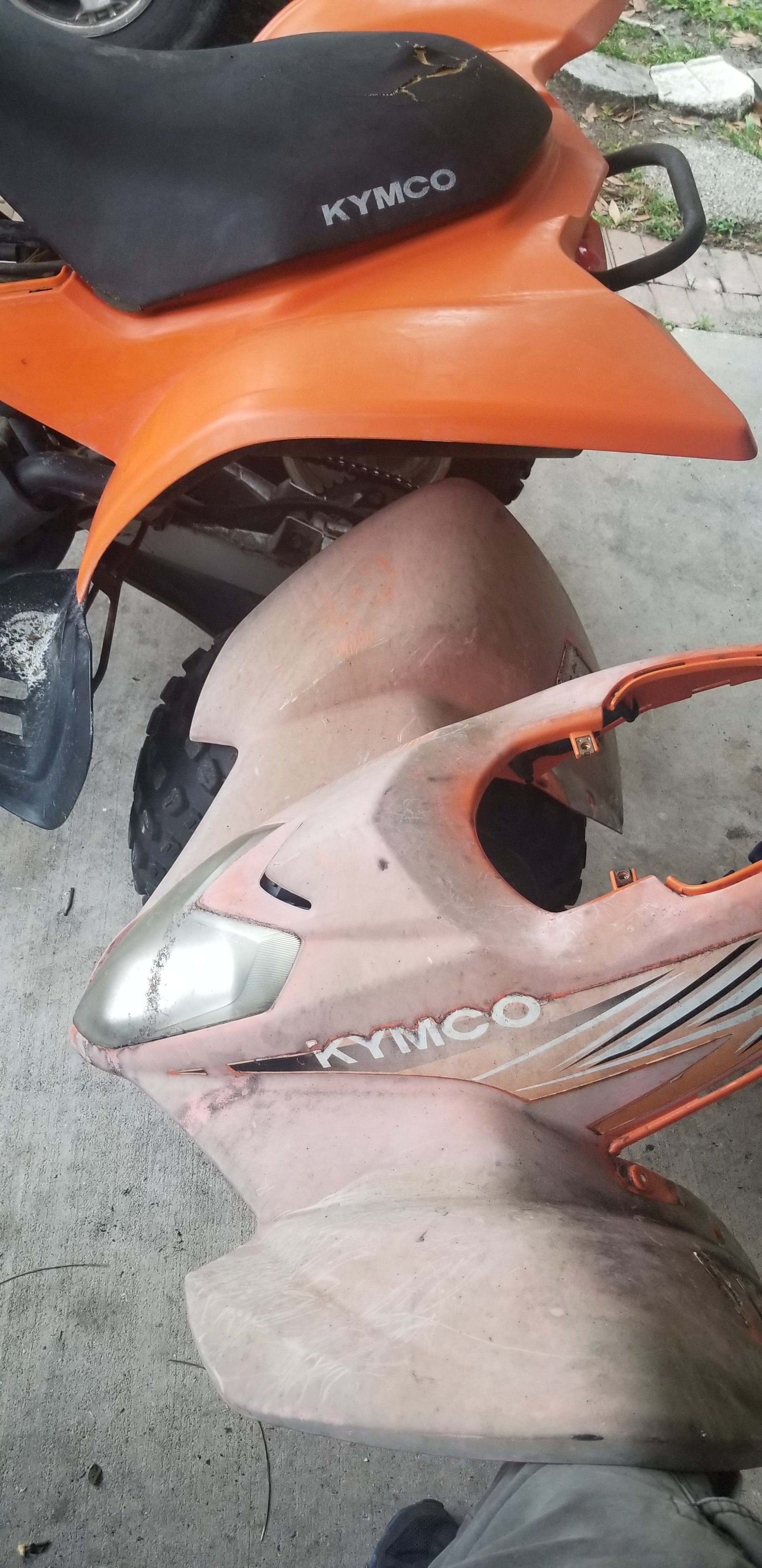

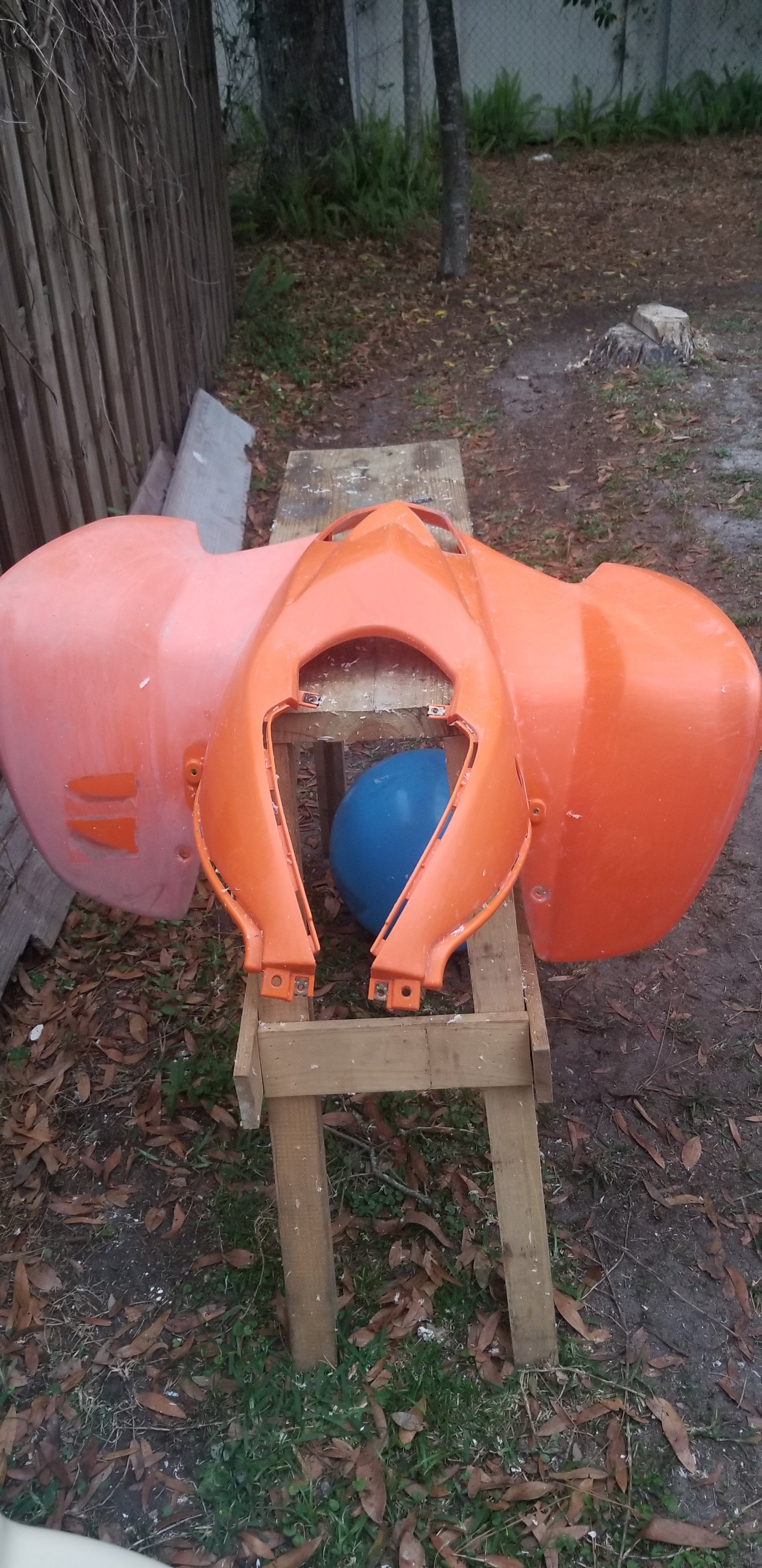

Started working on the Kymco's Plastics,still have a long way to go, but little by little I will have them looking SHINY!!! again for sure,I've been having a blast with this quad and so have my babies, they are 2 years old Twins, Boy&Girl but loving the rides...But Daddy here is thinking about fixing the Raptor660.... just passing the time and also building the Kazuma Falcon 150cc and fixing all the smaller quads,I cannot believe I own 7 Quads.... and sold 3 already, so imagine how pissed off is my wife with all this things in the back....Lol... Patiently waiting for parts for the #YamahaRaptor660
Great progress on the bike.What are you using on the plastics?
As far as the seat cover goes you can make your own out of some fabric with a T 50 staple gun and scotch guard water repellent spray.   It takes literally 30 mins to do and looks amazing.
Sounds like your having fun. Keep up the good work.
Well I cleaned it up with soap and water first,then at Home Depot I got me some Boiled Linseed oil(has to be Boiled) Paint Thinner and some rags and a brush with strong bristles,since the Bike was left outside for I don't know how long, but it was bad,I washed it first,take all the dirt, grime off,then I mixed Both my chemicals Thinner and Boiled Linseed oil and brushed away hard,then,I did this because its for me,I lightly scraped it with a blade made for window scraping,but its very light though,then lastly I may go with the Heat gun,or maybe I'll polish it, don't know yet,but just so you know its not finished yet,I will post the finished product,and its gonna be EPIC!!!! I'm gonna have those plastics SHINY!!!! Then it'll be time for the YAMAHA RAPTOR 660R!!!! to get the plastic done!!!! This is just me doing this like this,people usually just do the Paint Thinner and Boiled Linseed oil and thats it,Im just a perfectionist,cant do half as* crap... My Father's Words "Son if YOU!!! are going to do Something do it Right or Don't do it at ALL!!! Or Let Someone else Do it" that was my Father's sayings....
