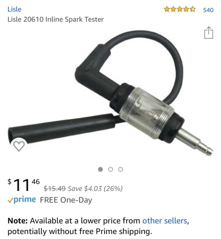

Could be the cdi but not my first choice.  I would do some testing first. Maybe test some devices like the  pick up coil for starters. Also the stator coil maybe do an ohms test as well look at the secondary ignition coil.  Sometimes the spark breaks down after the engine is hot or in your case maybe it’s happening right away.  There is a tool to see if  the spark is breaking down while the bikes running.
Its a useful tool.

Lisle 20610 Inline Spark Tester https://www.amazon.com/dp/B0002STSC6/ref=cm_sw_r_cp_api_i_ebj1CbF42SW39
Have that spark tester. New plugs, old ones looked ok. Made no difference. Gave you cranking voltages of charge and pickup coils in first post. Went thru carb with fine tooth comb. Polaris updated that ign system in 2004 or 05. Timing is on speck. Had flywheel off to check for damage, (loose magnets, Burnt coils) looks good. At a loss
