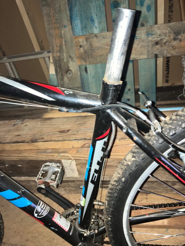

However I have a recue Bike. Abandoned and left to the elements.   Its an Aluminum frame  Fuji Off Road bike.  I have it back together with new shifter etc.
However the steel seat post is bound in the aluminum frame.  I have tried everything soaking it in break free, trying to turn with a pipe wrench  but cannot free it.
Try heating the Steel seat post near the Alum. Frame moving the propane torch back & forth -up & down from one metal to the other -The dissimilar metals will Expand/Contract at different times -tapping gently with a hammer will help as you move the Torch around continuously! This is where Anti Seize helps Before the Problem starts!
Get help from a friend   to  heat the frame  evenly over the area the steel tube is in while you  try to work the steel  post  back and forth. Heating the aluminum should make it expand slightly before the heat transfers to the steel   ,giving you a little wiggle room to get it to break loose.
I admit I have not tried heat.  I believe the shaft is about 10 inches in with 6 inches sticking out.  I have had aluminum /alloy wheels that corroded to the steel brake hubs....Steel aand aluminum do not go well together.  I know with service entrance aluminum cables we had to use "NO-LOX" on the cables before lugging to the panels.
I am going to try heating the aluminum seat tube shaft like they suggested  when I take it back to FLa so someone can help me. Thanksgiving project.
The seat shaft (steel) is stuck in Fuji's aluminum frame.  Heating the Fuji seat tube will destroy the paint.  But WTH!   I was planning on heating aluminum tube and pipe wrench twist the seat shaft and or hammer the shaft to break it loose.  I opened up about 1.5 inch slot in aluminum tube and soaked with penetrating oil.
