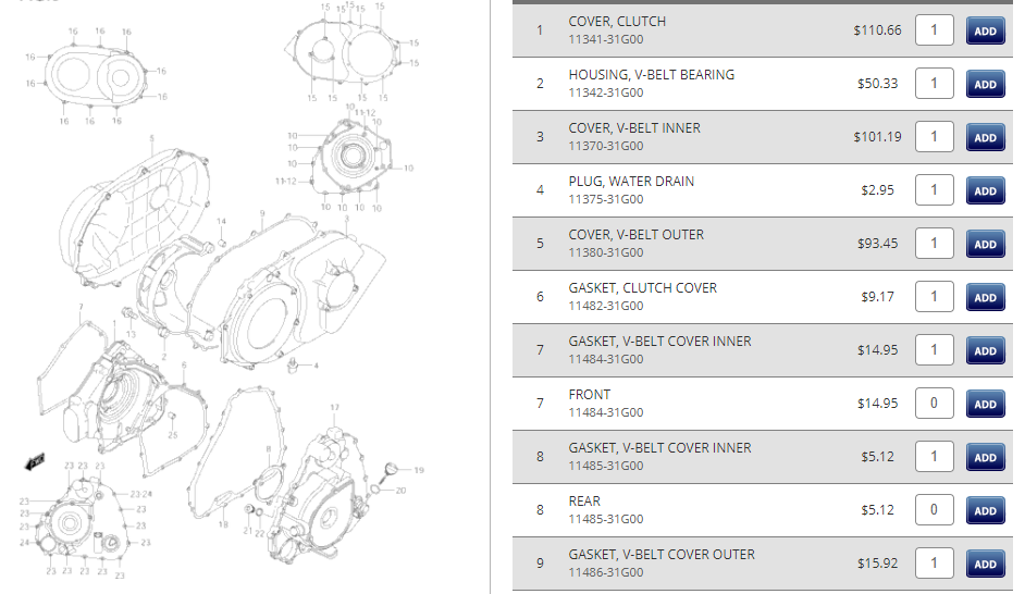

This is exactly what probably happened and has happened to me a few times. There should be a plug to release the water on the bottom of the belt housing. See #4 in the diagram below:
If you need the manual, there is one here:
