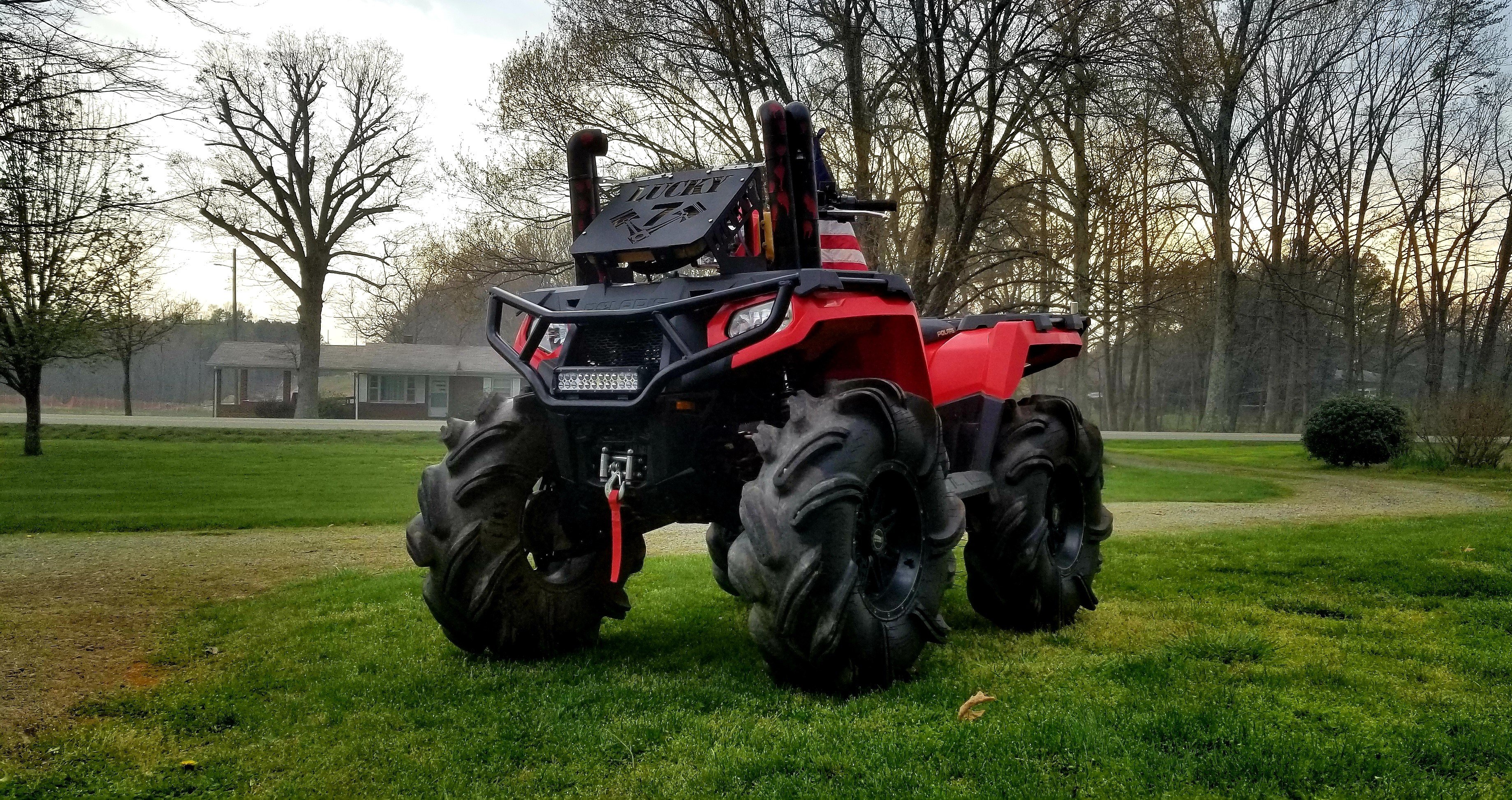

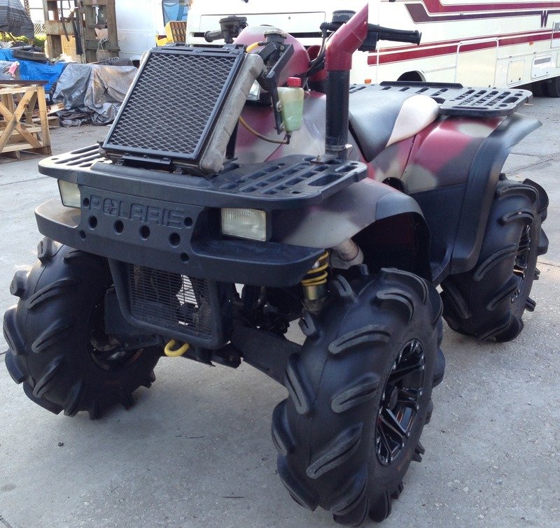

so I'm trying to figure out if I want to keep this bike or sell it.  So I want an 850 or 1000cc for playing around and work and trail riding and stuff...  but I kinda want to keep this bike and make it into a mud bike...like put bigger wheels on it, snorkel and relocate the radiator...that way if I sink it and kill it, its 2k gone rather than 8k (for a newer efi model)  Yoiu guys think its worth it?  Is this a good bike for modding it into a mud machine?  If so, what necessary and whats not for the mud?
the other option is to sell it...  I know I can get at least 2500 out of it right now..  I have 2k in it currently.
To be sure about rubbing your going to have to collapse the suspension as much as you can then take a measurement form the center of the hub to the fender where the first contact would be. Then measure your potential wheel from center of wheel to edge of tire.
Maybe a good ratchet strap or a come along to collapse the suspension to mimic how far the suspension will travel but be careful.
so i guess the main things I'm going to be working on
  1. Need a-arms that relocate the front wheels forward
  2. need a snorkel
  3. need a radiator relocate...???
not sure about the radiator relocate- I think the main thing would be how low down the coolant reservoir is and it has a breath hole in the top...

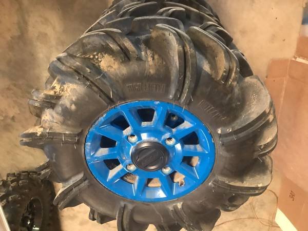

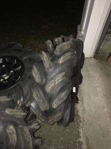

was looking at some tires like these:
