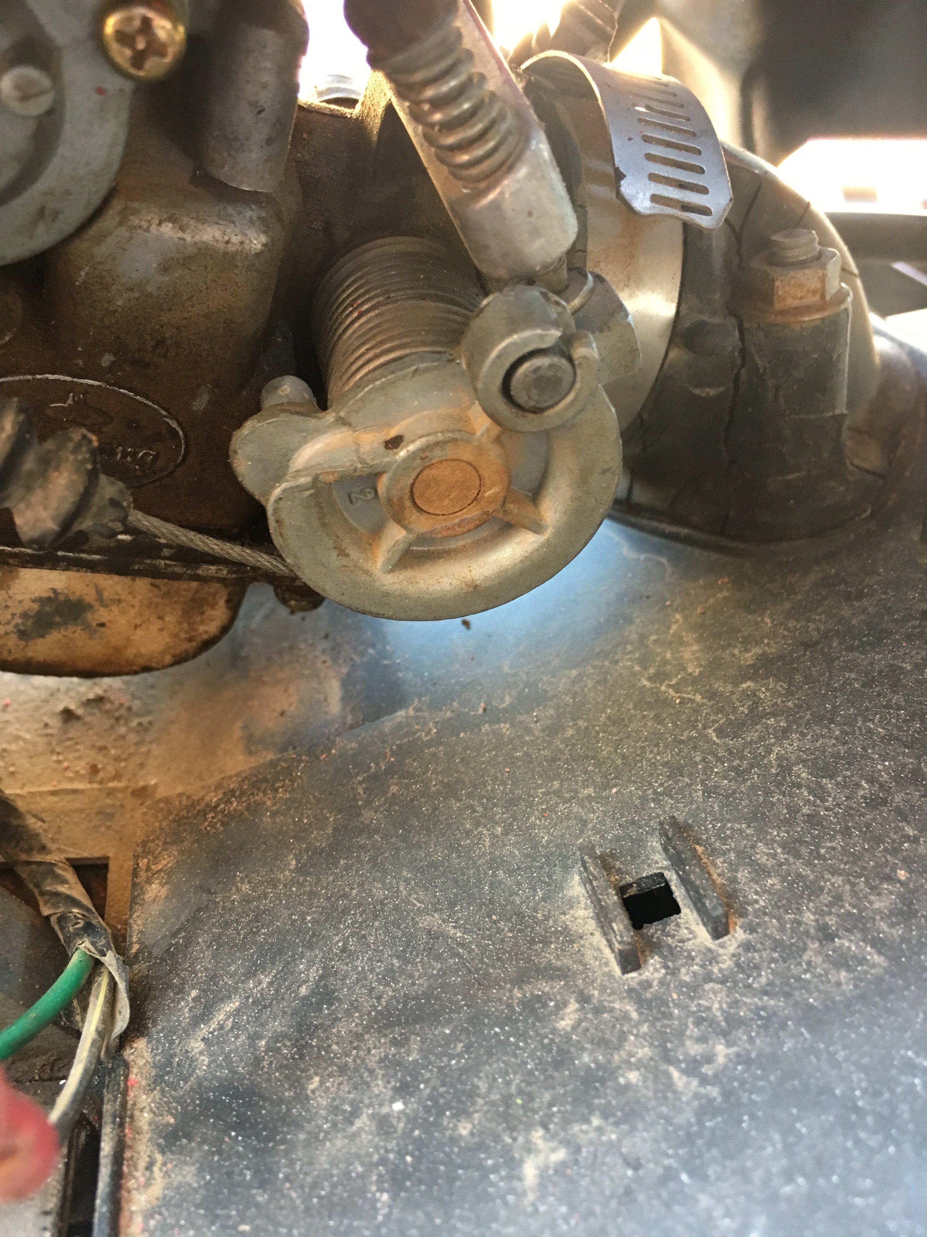

Sorry for not posting updates in a while. The stator works! I ordered a new one and figured out how to wire it in and now it sparks strong! I have spark and compression but no fuel. I am going to remove the carb and fuel petcock to clean them both as I see no fuel in the fuel line. One question: How do I remove this throttle thing on the carburetor so I can take off the carb completely?
Nice work ! That throttle cable will come off by grabbing that throttle control on the carb and turning it and pull the cable off as it slacks. Almost like you would a bike chain.   Then once the cable is off of the main part line it up with that slot and slide it out.
There should be a part that holds the throttle cable into the carburetor also. You can unscrew that as well to slack the cable.

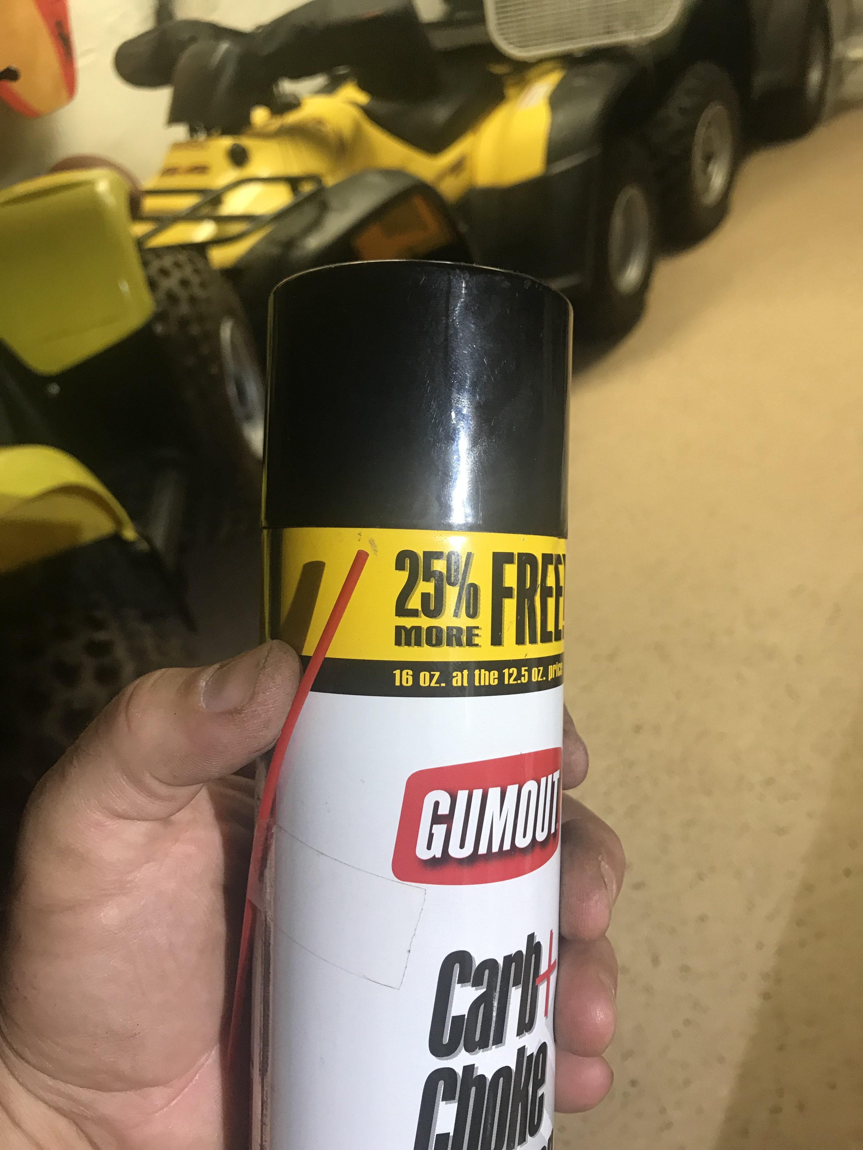

If you have any starter fluid spray it into the air intake as you are trying to crank it.
If it fires then the engine is obviously starved for fuel.  If you don’t have starting fluid put a drop of gas in the head where the spark plug goes and and put the spark plug back in and try to fire.
If all that works then you failed someplace on the carburetor cleaning. Maybe a stuck float or the fuel port coming from the needle is clogged.  It happens.

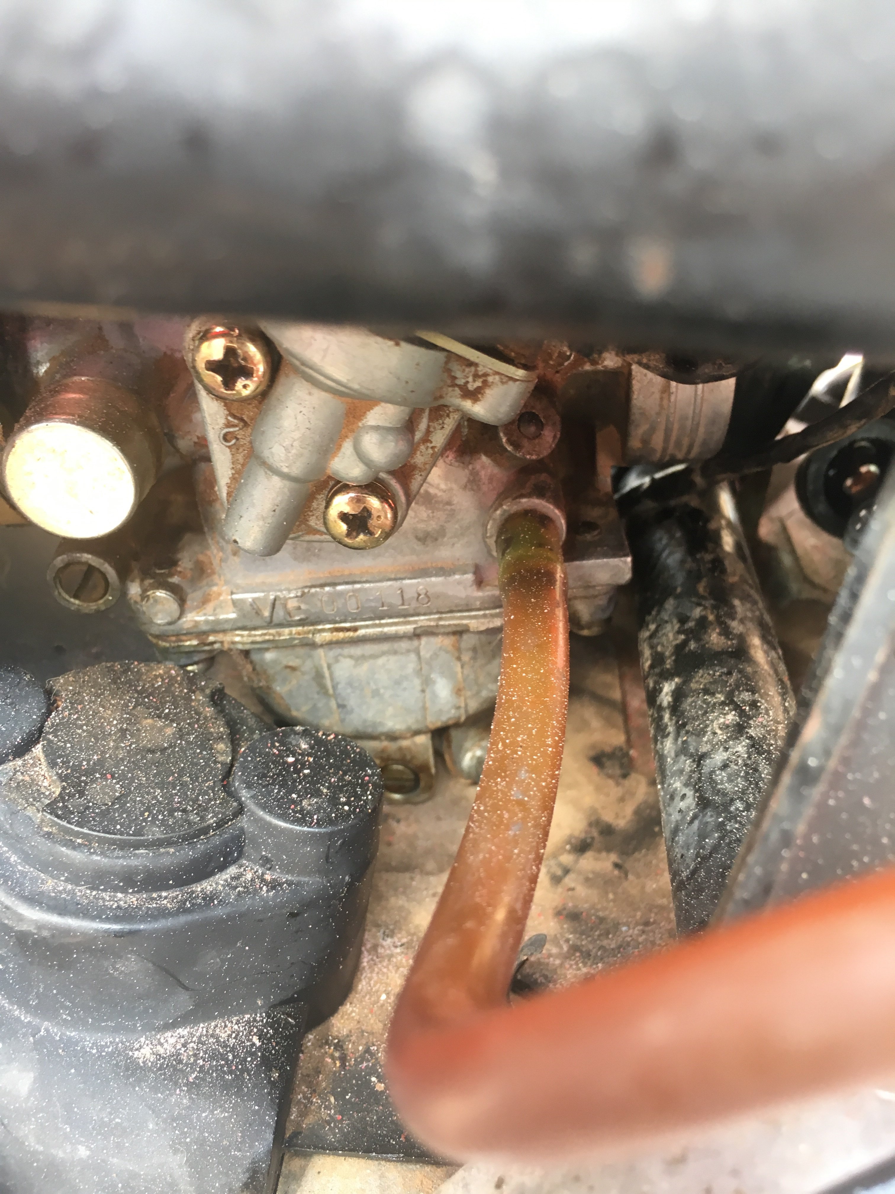

I cleaned the carb and the quad ran on starting fluid, however in the process of cleaning the carb I could not get carb cleaner through the place where gas enters the carb from the tank. I fear this might be my problem. How can I unclog this?
This is the connection I am talking about. And BTW the fuel line does not have gas in it when attached to carb but petcock is not clogged
I tried to start the quad without a gas cap and it didn’t help.
So most likely the vent on the carb is still clogged.   Try to Blow into the vent hose on the gas cap. This may clear the vent line  in the carb.  Make sure your gas petcock is in the right position and and blow into the hose on the gas cap.  Try your reserve as well.  That petcock may not be working right.
Did you remove the  carb from the motor and disassemble  it to  clean  all the  jets and passages?   If the inlet  port is  clogged or the needle valve in the  carb is stuck  closed  you would not be able to  blow through that  line into the  carb.
You have to take the carb apart!  Cleaning a carburetor means taking the carburetor off of the bike and dissembling the carburetor.   You can’t just spray a cleaner into the carb or under a needle valve etc and hope it works.  Take it off clean it properly and make sure ALL paths are clean.   Then reinstall and you will be fine.
The carb needs to come off of the engine.  Take it completely apart and blow out all orafaces with tye carburetor cleanser and even a small piece of wire to stick in the holes.   You should be able to blow into that fuel line and it should come out of the bottom of the float area where the needle is.
The blockage could be  in the port  where the fuel  line is connected . That  leads to the needle  valve on the float. If this is your first time doing a total  disassembly  and clean,  watch the video  Frank  posted , then   work on your  carb .. Take  your time and  check  all  passages  and  jets  for  crud  blocking them.  Keep track  of what  goes  where  as you remove the pieces  and reassemble  the pieces.
