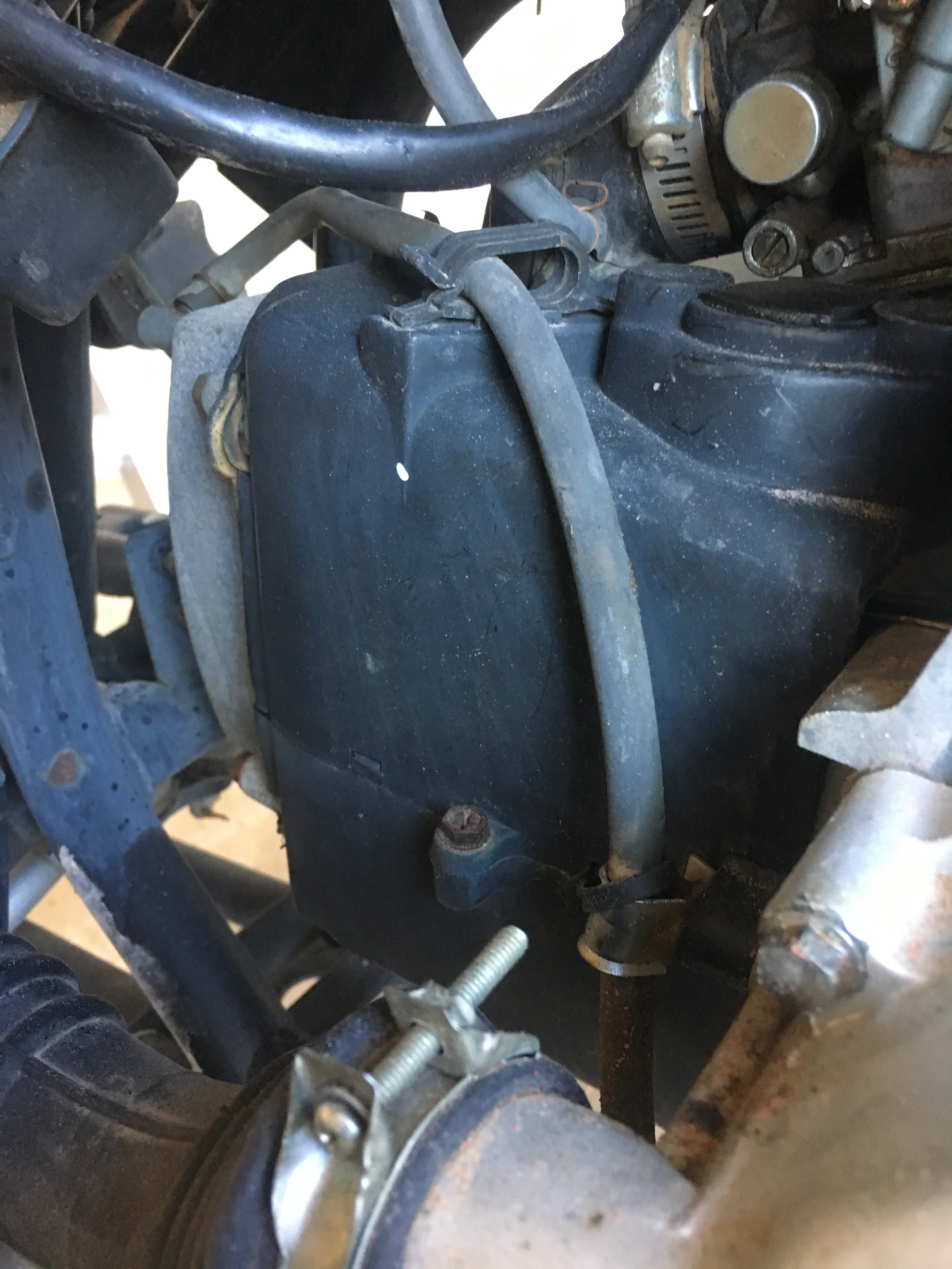

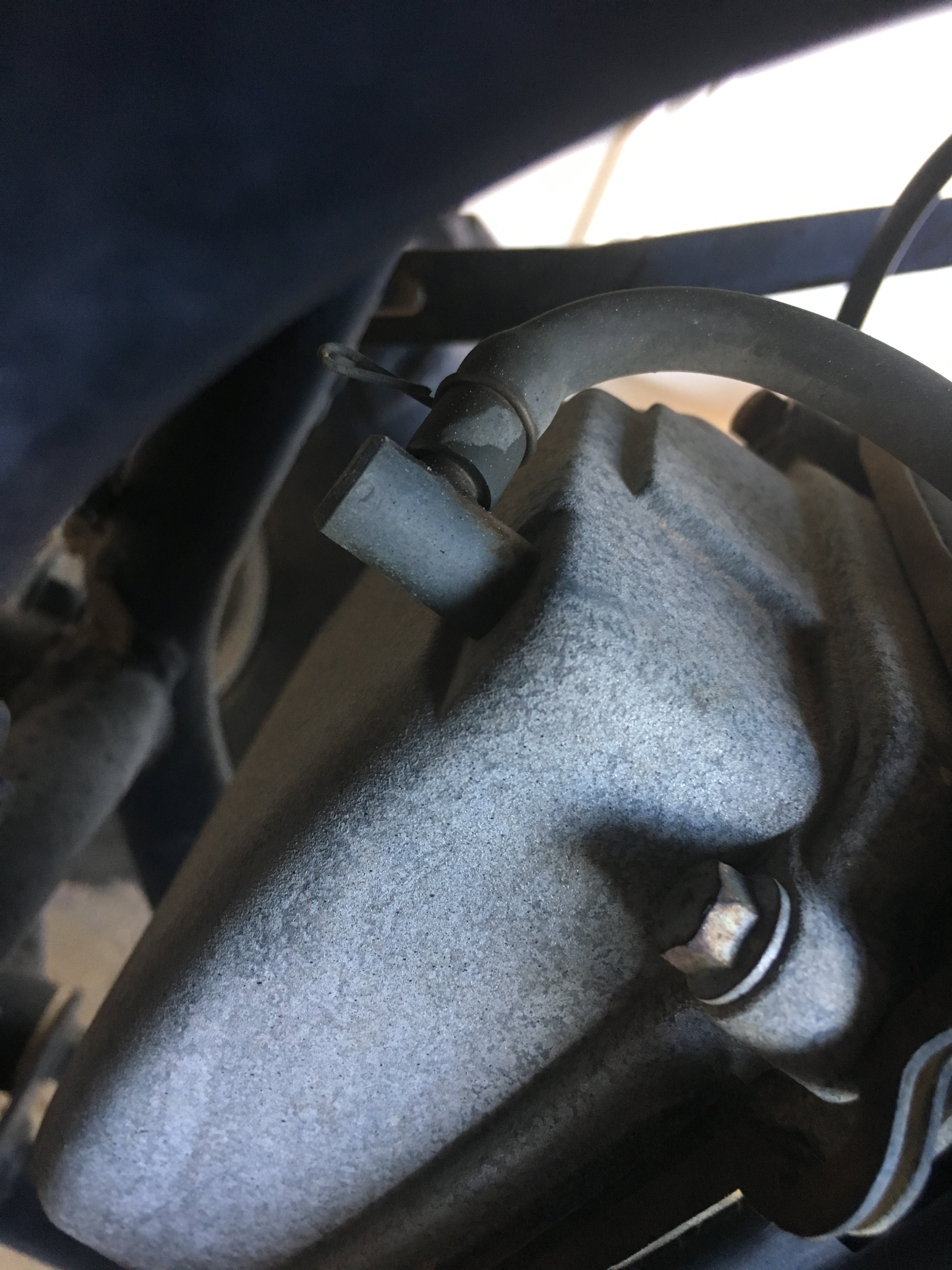

Oil is coming from the end of the tube visible in the first photo. The tube is pointing directly down and is right over the oil spot visible on the ground.

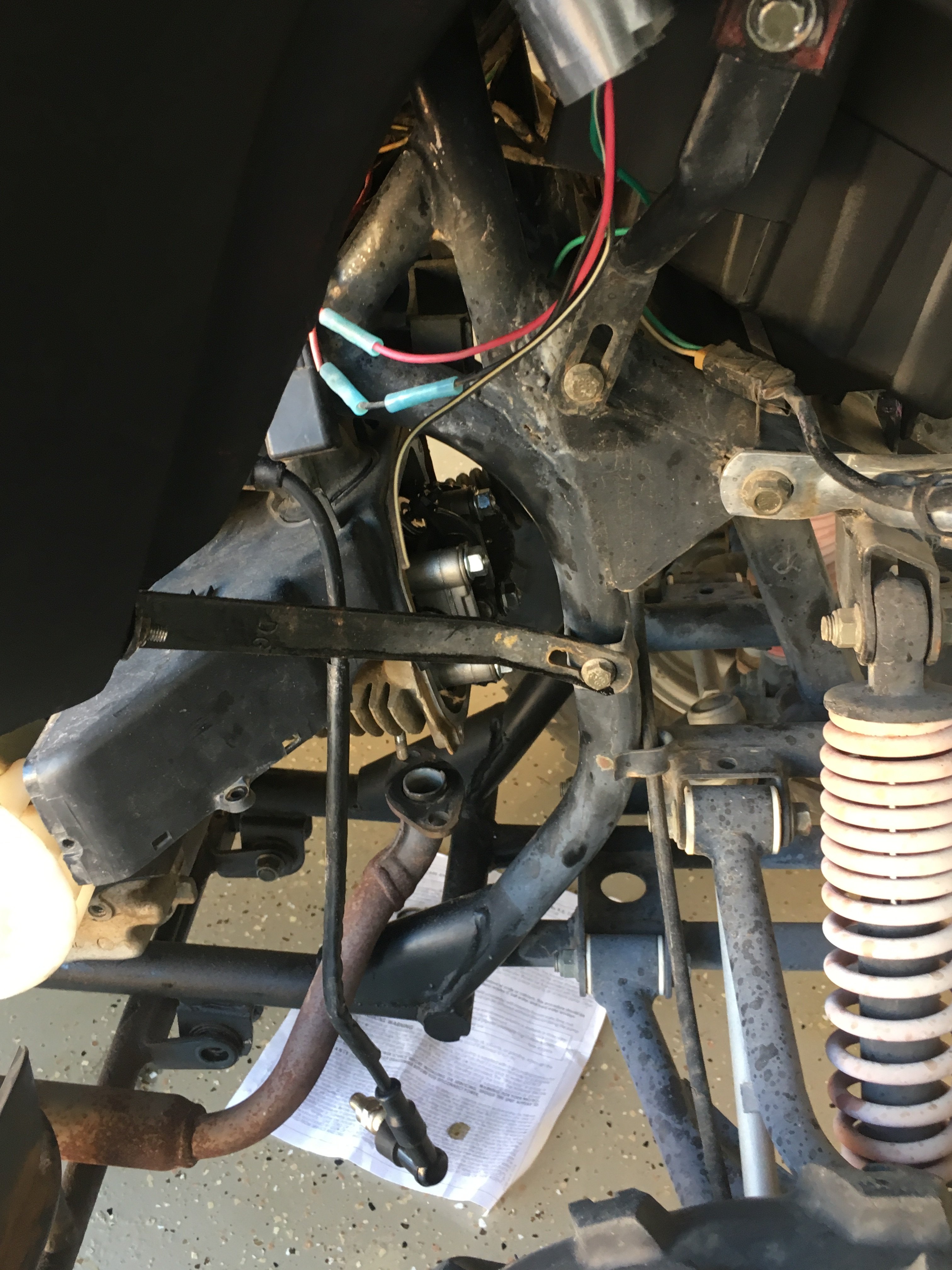

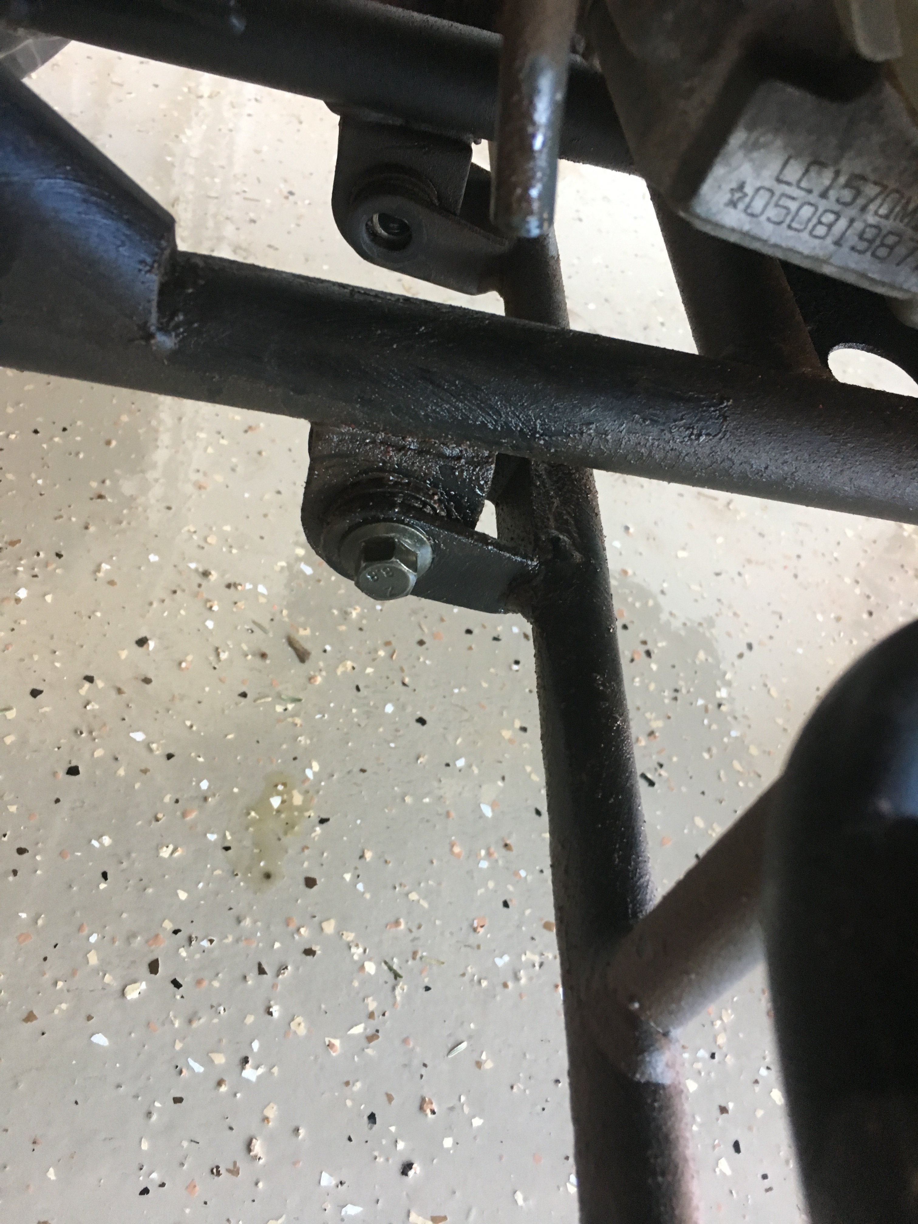

And as for the bolt missing I removed the bolts holding the footrests onto the frame so I could look under the engine easier. I was in the process of reattaching when I took the picture.

I went on a longer ride (~10 mins) and everything is not ok. The left rear tire (the side the hose is on) is covered in oil spatters and the frame under the hose is too. It appears that I drained enough oil to the fill line but it didn’t work. On the bright side I’m no longer blowing smoke and the quad performs like it did before all of this.

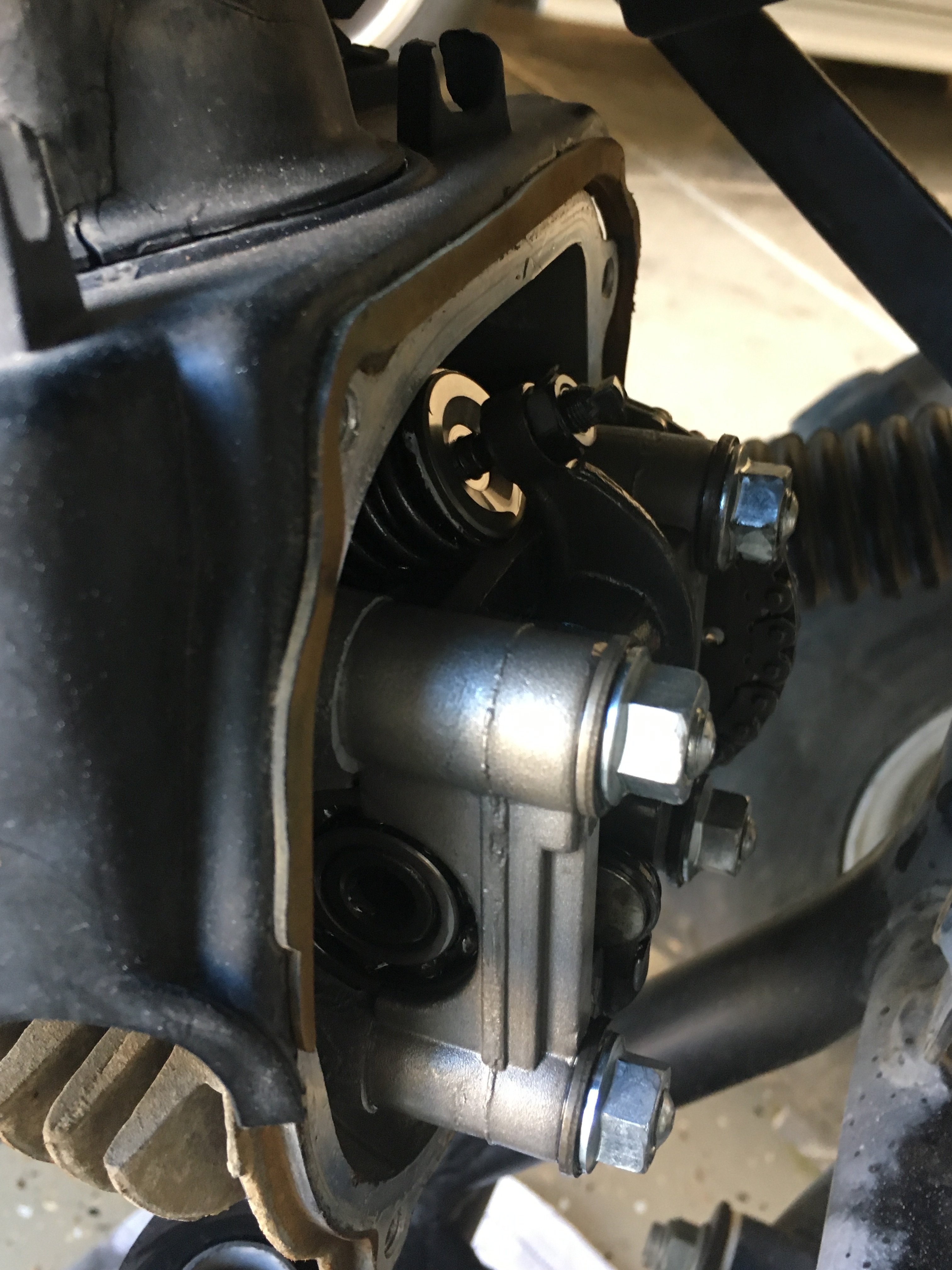

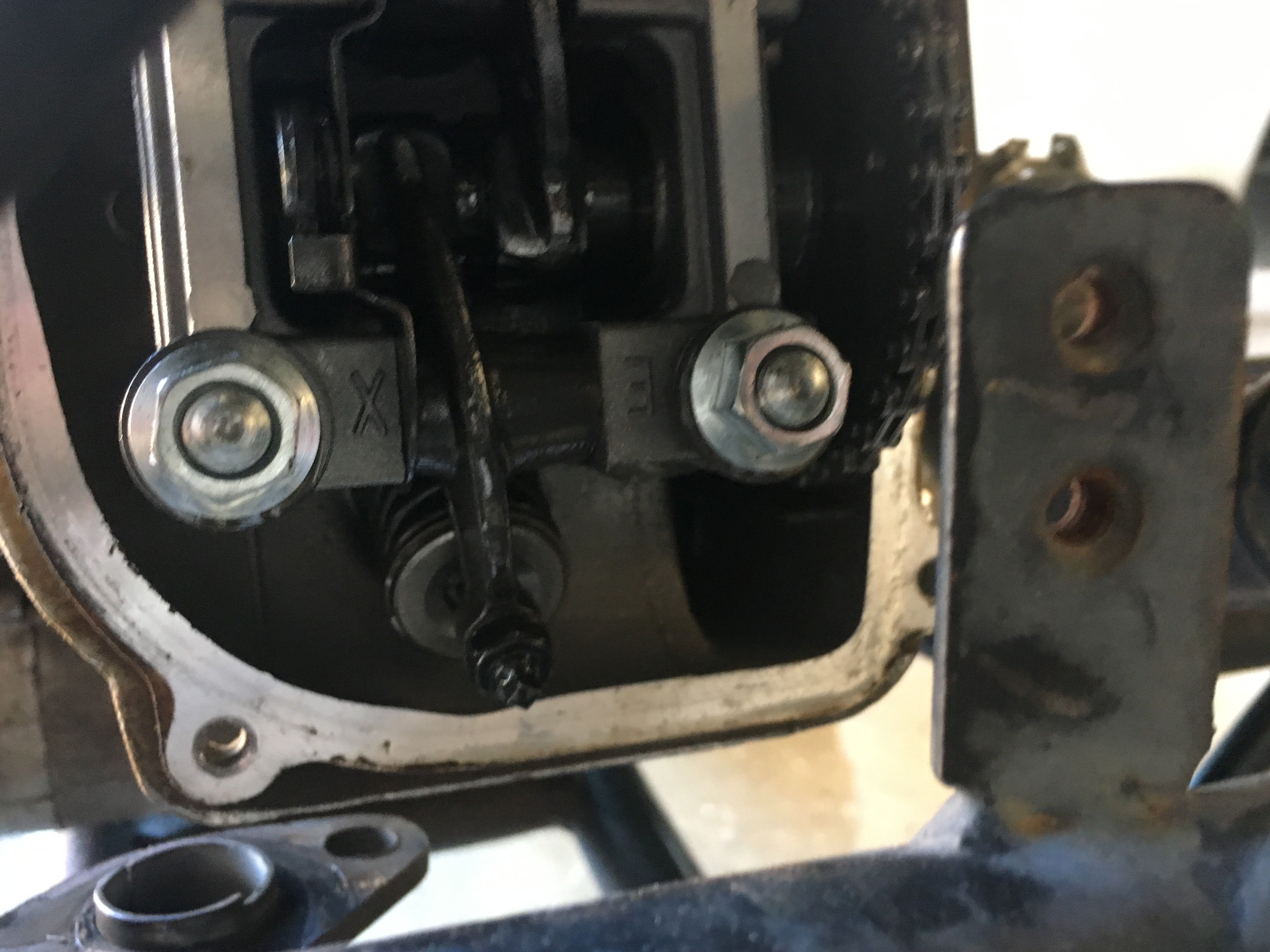

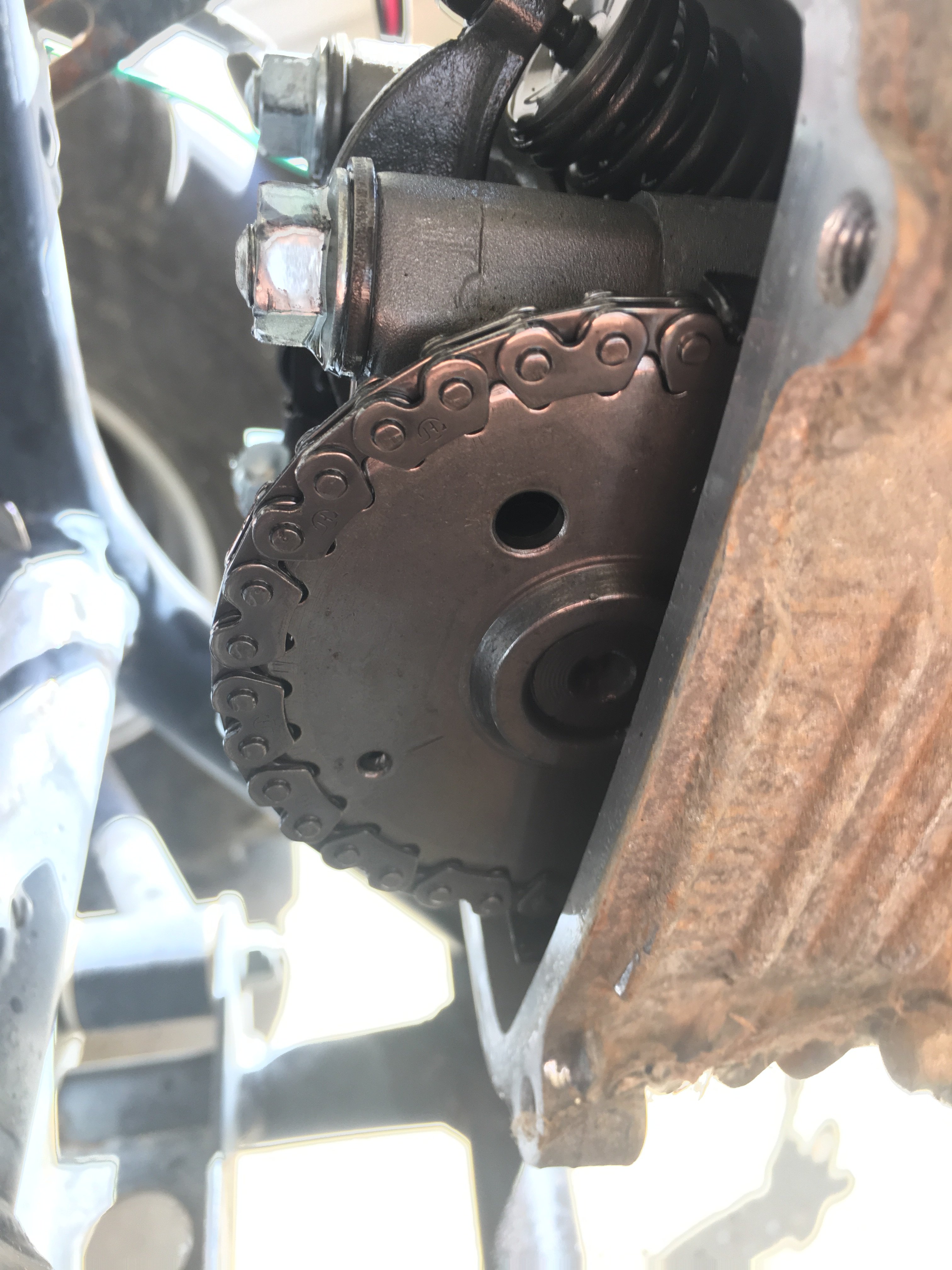

So do this first. Get the piston to top dead center. Take pics of where the cam sprocket  and the marks are on the top end so you can put it back the same way.  Remove the carburetor, exhaust and valve cover.

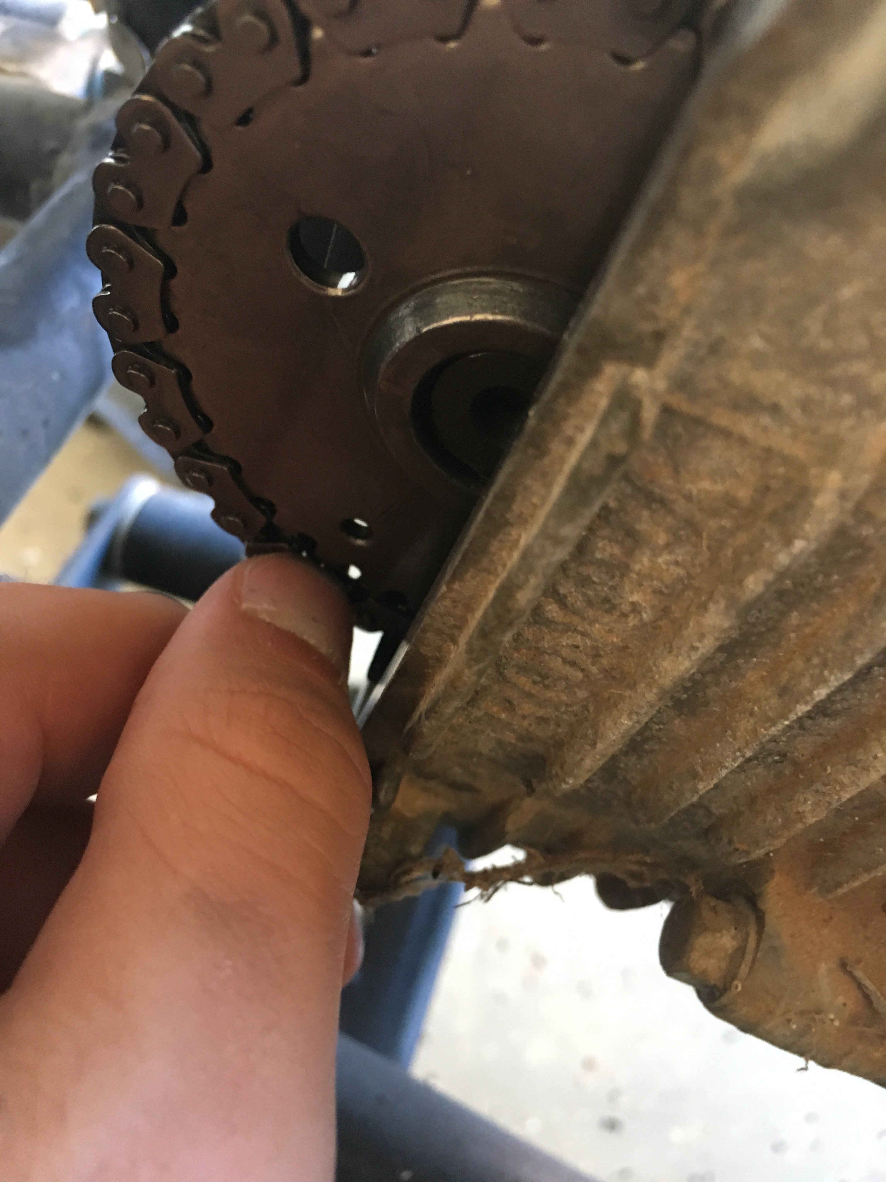

Unbolt the sprocket from the cam
Remove the top head of the engine .Remove the timing chain tensioner that’s in the side of the cylinder and the bolts holding the cylinder to the engine block.  Slide the cylinder up off of the piston.
Ok so if there is no obvious bolts or keyways holding that sprocket on and it’s pressed on the cam then your going to have to unbolt the cam from the head so the cam and sprocket come off as one.   Just mark where the cam journals (parts that hold the cam) down so they go right back on in the same exact spot.

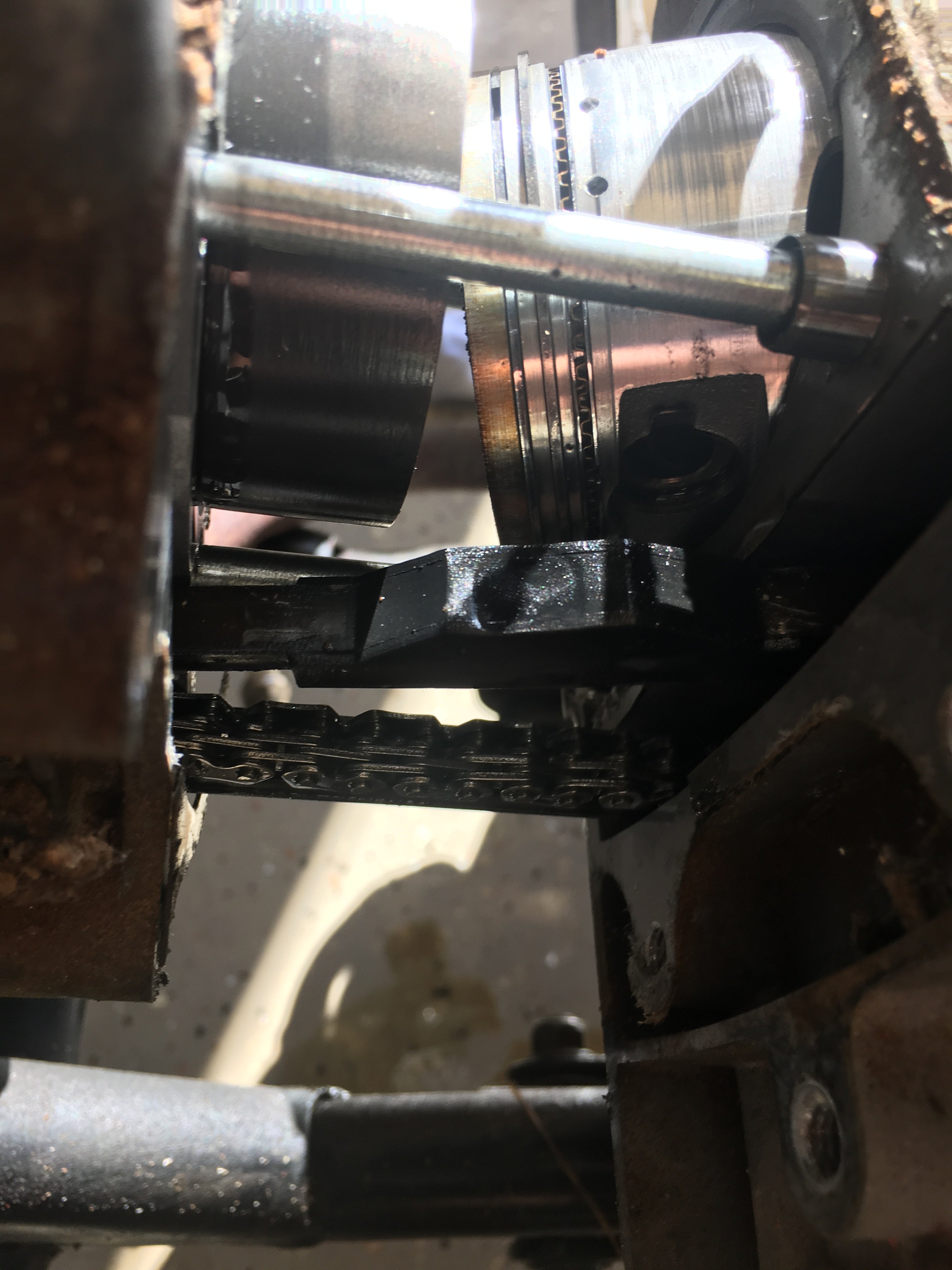

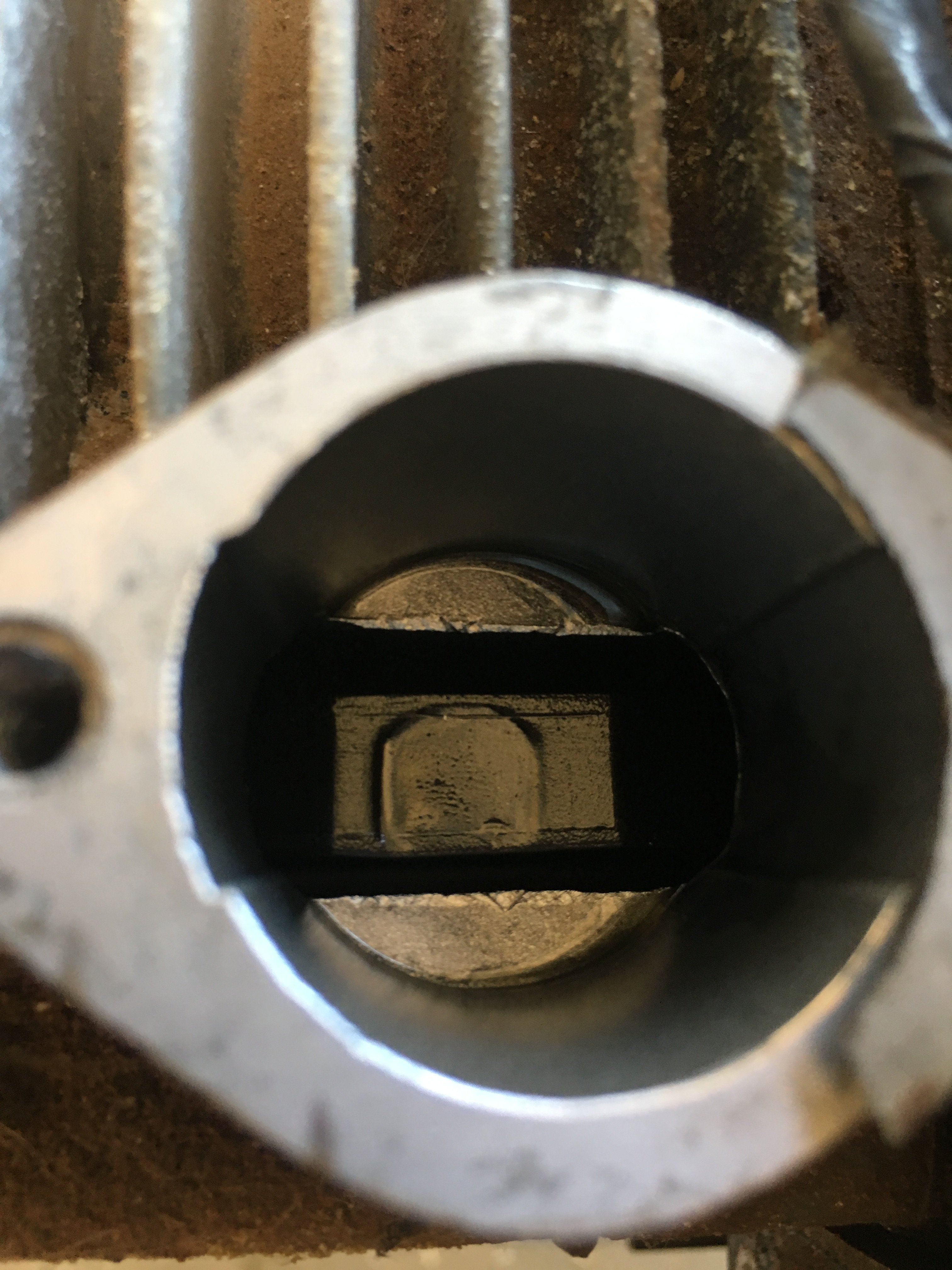

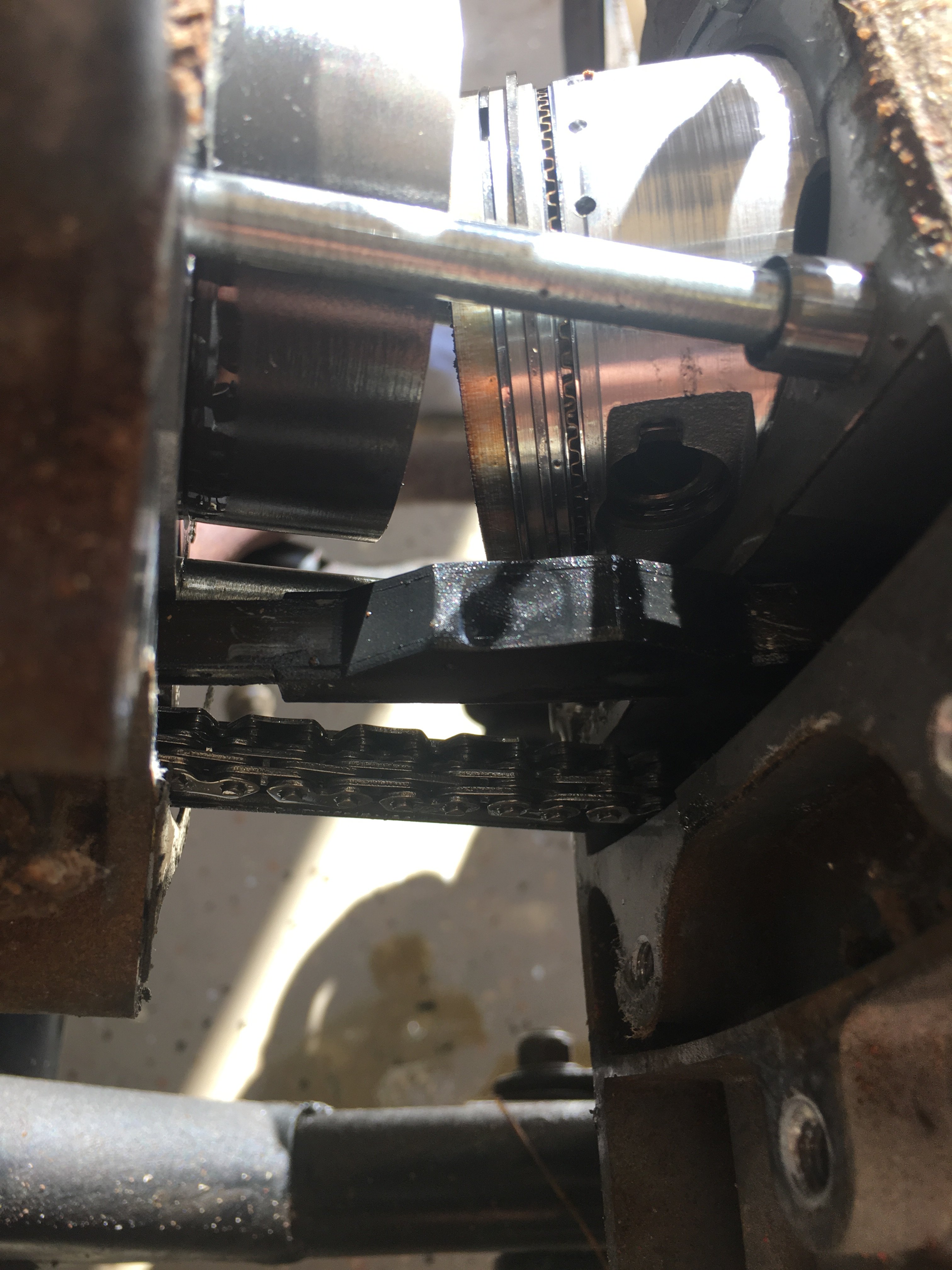

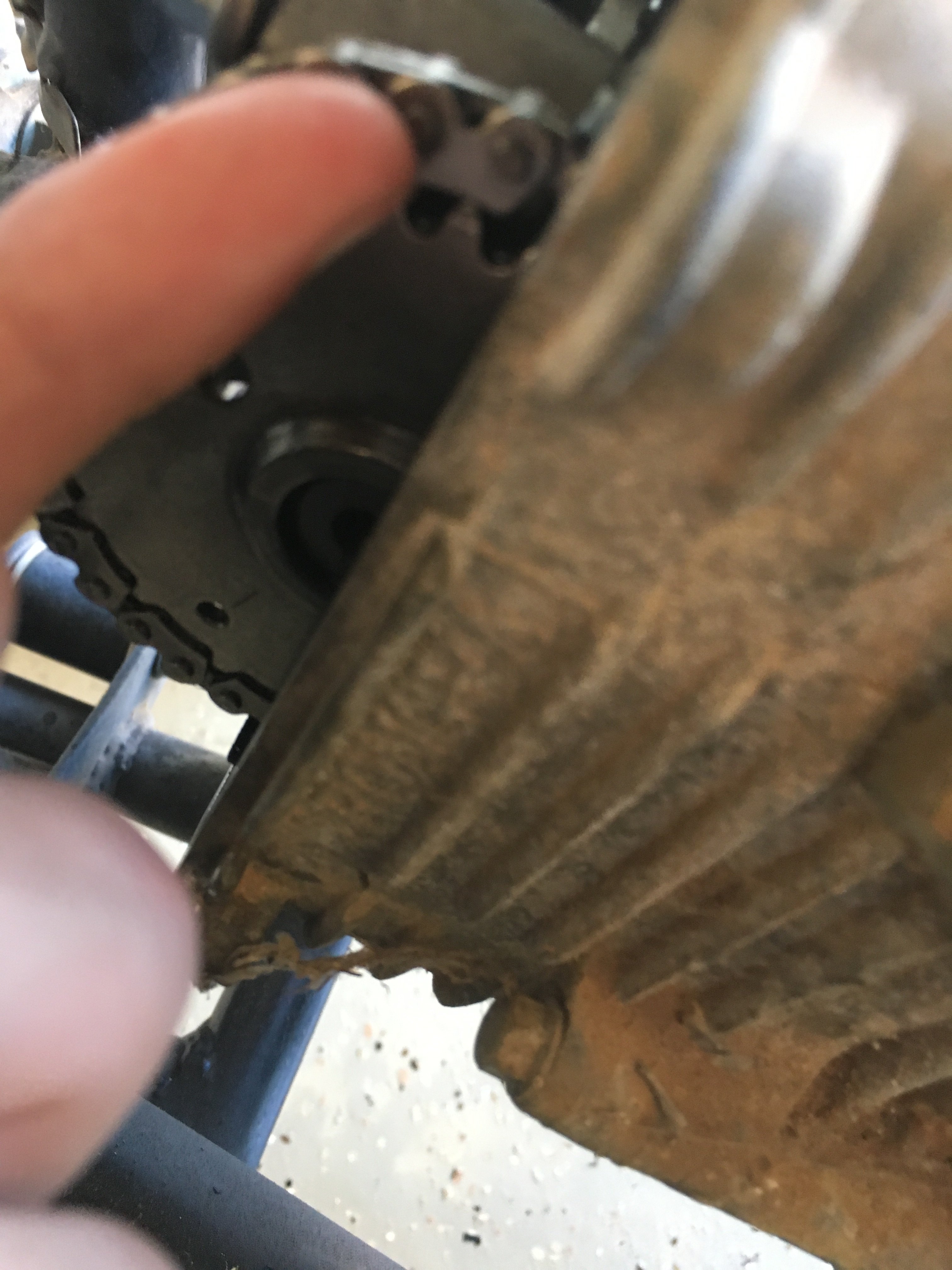

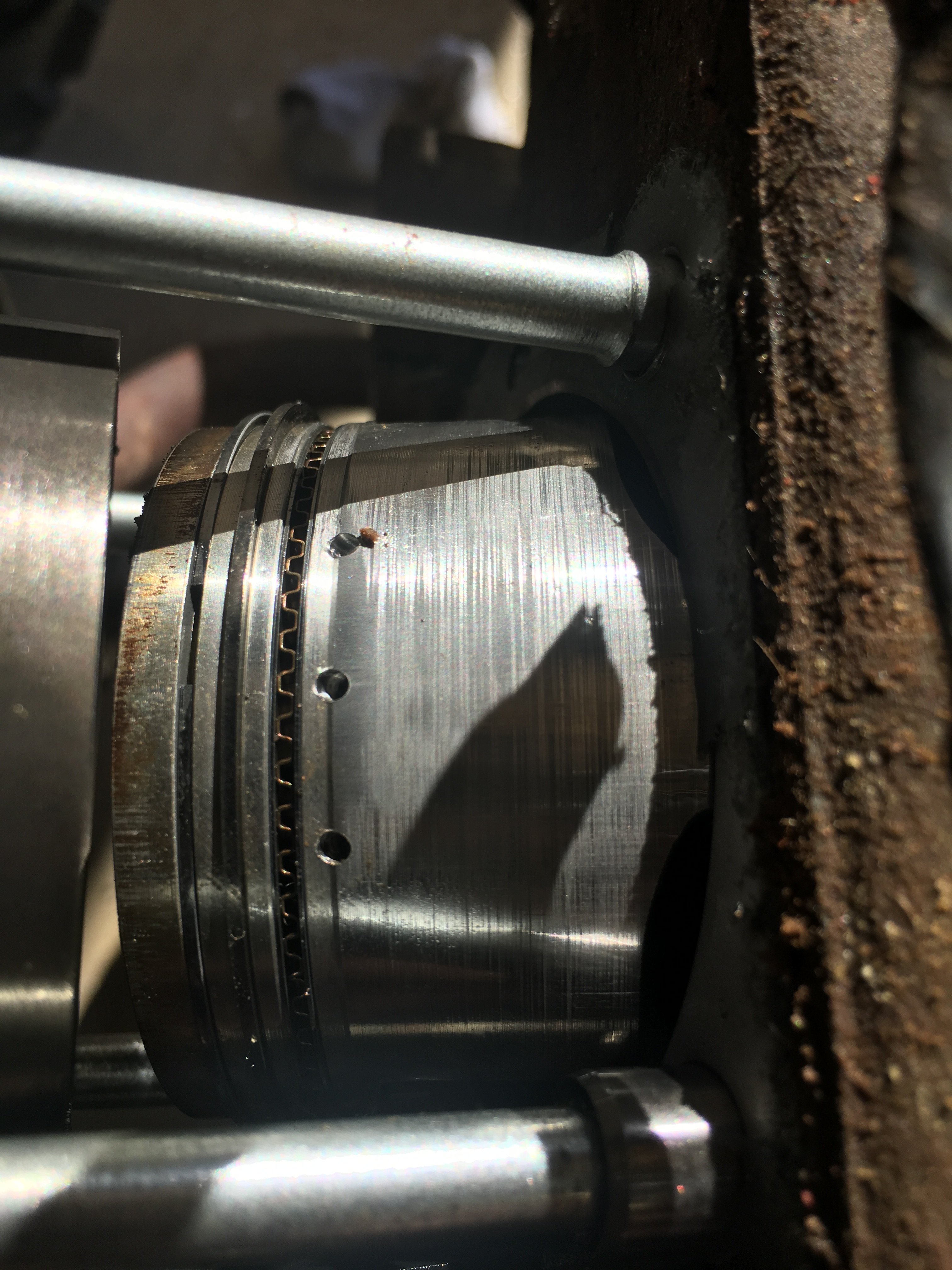

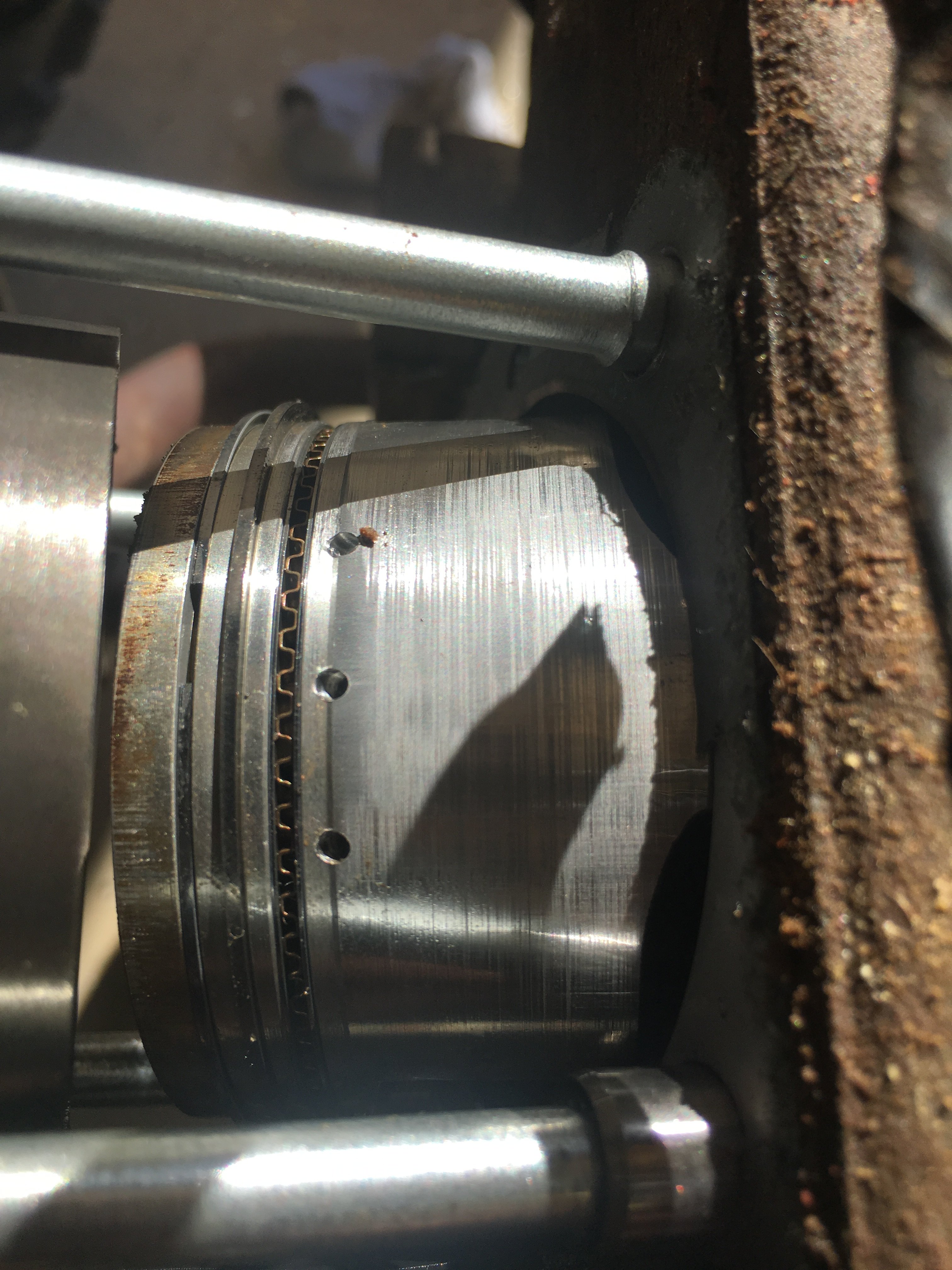

I am in a bit of a predicament right now. I managed to get the timing chain, camshaft, and head off of the engine but due to the engine still being on the quad and an odd frame design I am unable to fully remove it from the rest of the machine. I have managed to slide it and the cylinder far up enough to where I have clear access to the piston. I firmly believe that if I were to remove the engine from the quad that it would never run again. What should my next step be? Here are some photos of the piston and what I’m trying to describe:
