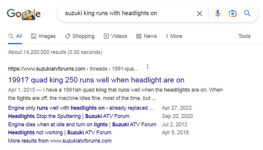

What Tiha says is generally right.. most aftermarket carbs do need re tuning. But.. you say it's "just started" running bad, so the question has to be.. how long has the chinese carby been on there, and did it use to run alright with the chinese carb.. or have you just fitted it and now it's running bad ?
Turn the headlights on and see if that helps.
Anyone who owns an old suzuki 300 or 250 4x4 should always check the regulator.
The regulator goes bad allowing the voltage to spike up to 16-18 volts with rpms which prevents the cdi from functioning and you will be chasing your tail forever trying to find the problem.  Turning on the headlights lowers the voltages and helps the engine rev higher.

Firstly.  Had the opportunity to run it around and once it burped and started to bog I turned on the headlight and started to run fine…thank god for that one…I’d never would have figured that one out.  That’s why this forum is so essential…we have the opportunity to learn from others hardships who have gone through the agony.
Secondly.  I used an unlit propane torch to test for a manifold leak and it kicked so I investigated that next…turns out the intake manifold was cracked!  Gooped that all up with gasket maker for the time being.  Hesitant to buy Amazon products and wonder if best to buy a used original piece…(had bought an Amazon maintenance kit…air filter, plug, whatever else…and the air filter came apart and allowed dirt into the carb/motor.  Went back to a cleaned original.  So in other words you have to be careful what buy from Amazon).
