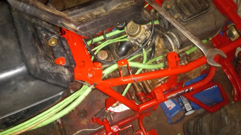

Of course I tore the whole rack off and front plastics chasing the wiring harness thinking it was a fuse box further in

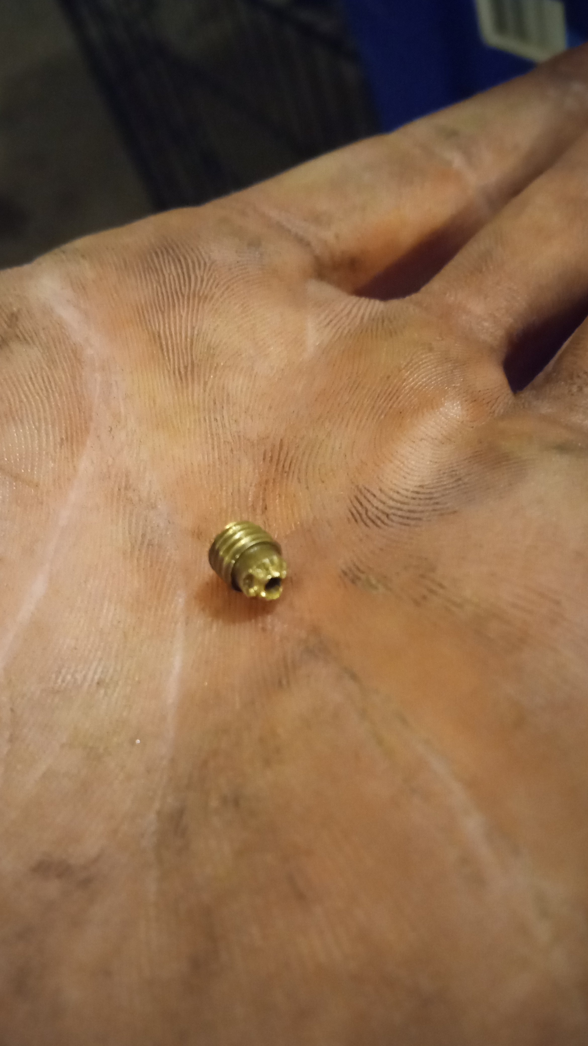

I fixed it!!!! I bought a carb rebuild kit and found I had a broken jet inside and an o ring was torn in the forks that hold the main jet.

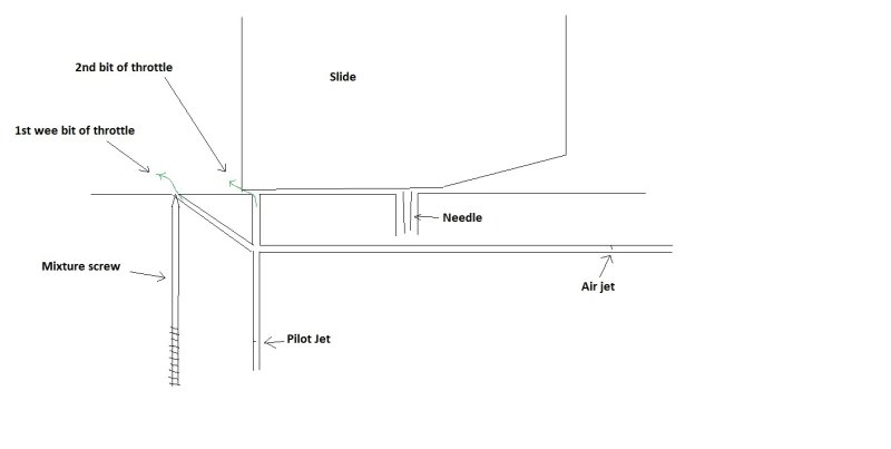

Often a stumble is found in the transition between the pilot circuit and the needle circuit (see pic below).
Turning the idle speed down as far as possible while adjusting the mixture is a good way to create a stumble if the carb isn't absolutely perfectly designed.

I think we both know by the shape of that jet. He had tried to fix the issue before but I don't think he had much experience fixing things as he did mangling them

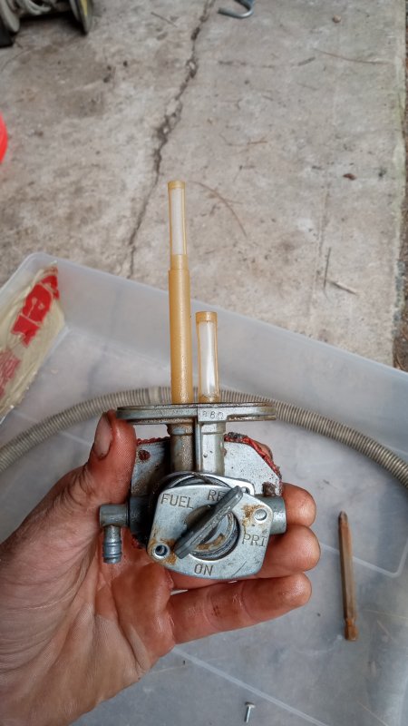

I think the petcock and fuel pump are the issue, they both are messed up and I think it's not getting enough fuel until I give it throttle

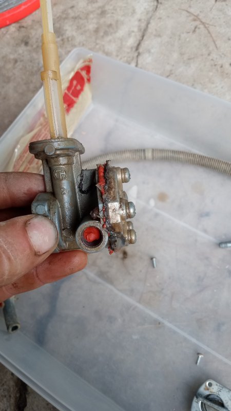

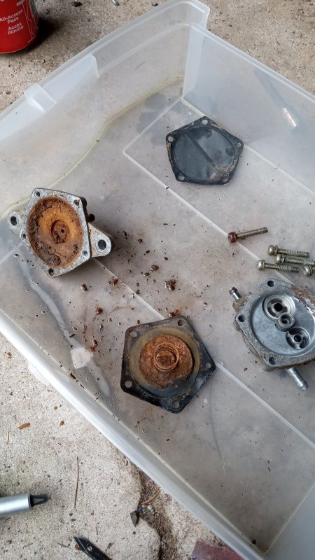

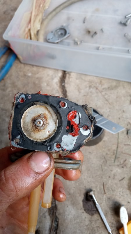

Okay but I appreciate the effort but that's not the issue, I know what the problem is and my parts arrive Tuesday. The diaphragm in the fuel pump is rusted through and there are a few holes in the gasket.
And the petcock had a hackjob or a gasket maker seal which plugged half the holes and ruined the gasket for it
