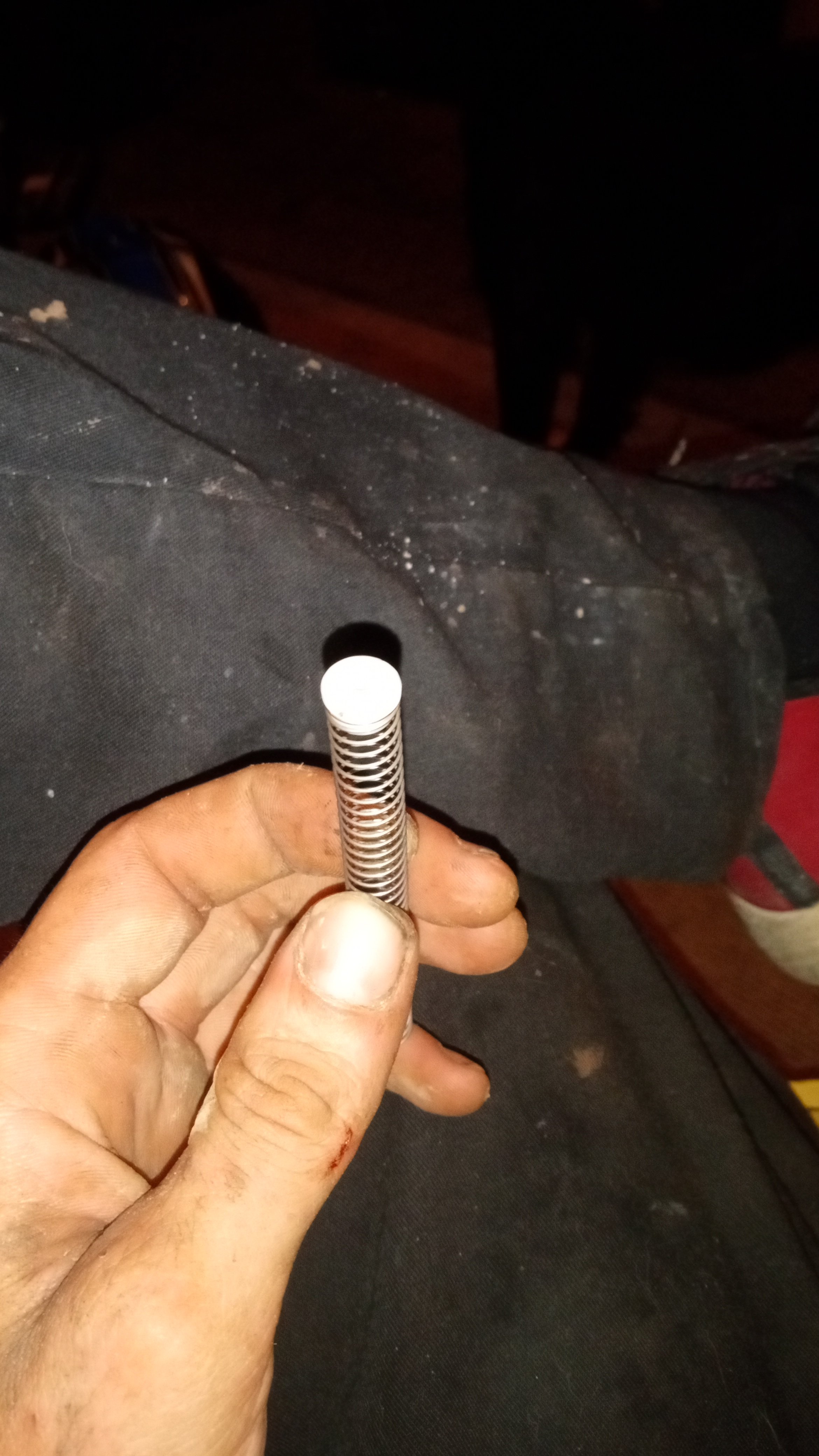

Your slide needle should be sprung loaded downwards. There's meant to be a small spring pushing it down, and the spring is held down by a plastic bit with an O ring on it. The O ring is all that holds the plastic bit from pushing up. If the O ring isn't on the plastic bit, or if it's old and hard, or if the plastic bit can be pushed up and out of place by you pushing the needle up slightly against the spring, but without actually pushing the plastic directly with the needle, they you should change the O ring.  The needles always wobble around sideways in the slide, that's ok.
What would happen without the o ring

Without the O ring the needle jumps up and down and fuel gets chucked in there in a completely random fashion, and generally far too much of it.. And that doesn't look like any part I've ever seen in there for the job. It normally is about 20 mm long, has an O ring on the bottom then a flange and a flatter part that's serrated so it can be grabbed with a pair of pliers..
Find a bit of rubber hose about 6mm diameter and use that to jamb down on top or that spring temporarily and see if that fixes it. If it's held down by the spring it will move up, but against the spring pressure, not completely freely.

There are two versions of carb, one with a steel cover and one plastic.. one has a diaphragm spring about 10mm diameter and the other diaphragm spring is about 14mm diameter.
I'm thinking yours is the plastic cap and the 14mm spring, and on that one there is a tower that comes up around the needle that has four slots in it.. Is that right ?
Yes but when you say cap do you mean the cover concealing the needle because it is metal an I'm not sure what piece you mean for the spring, mine doesn't have anything but that flat plastic part
