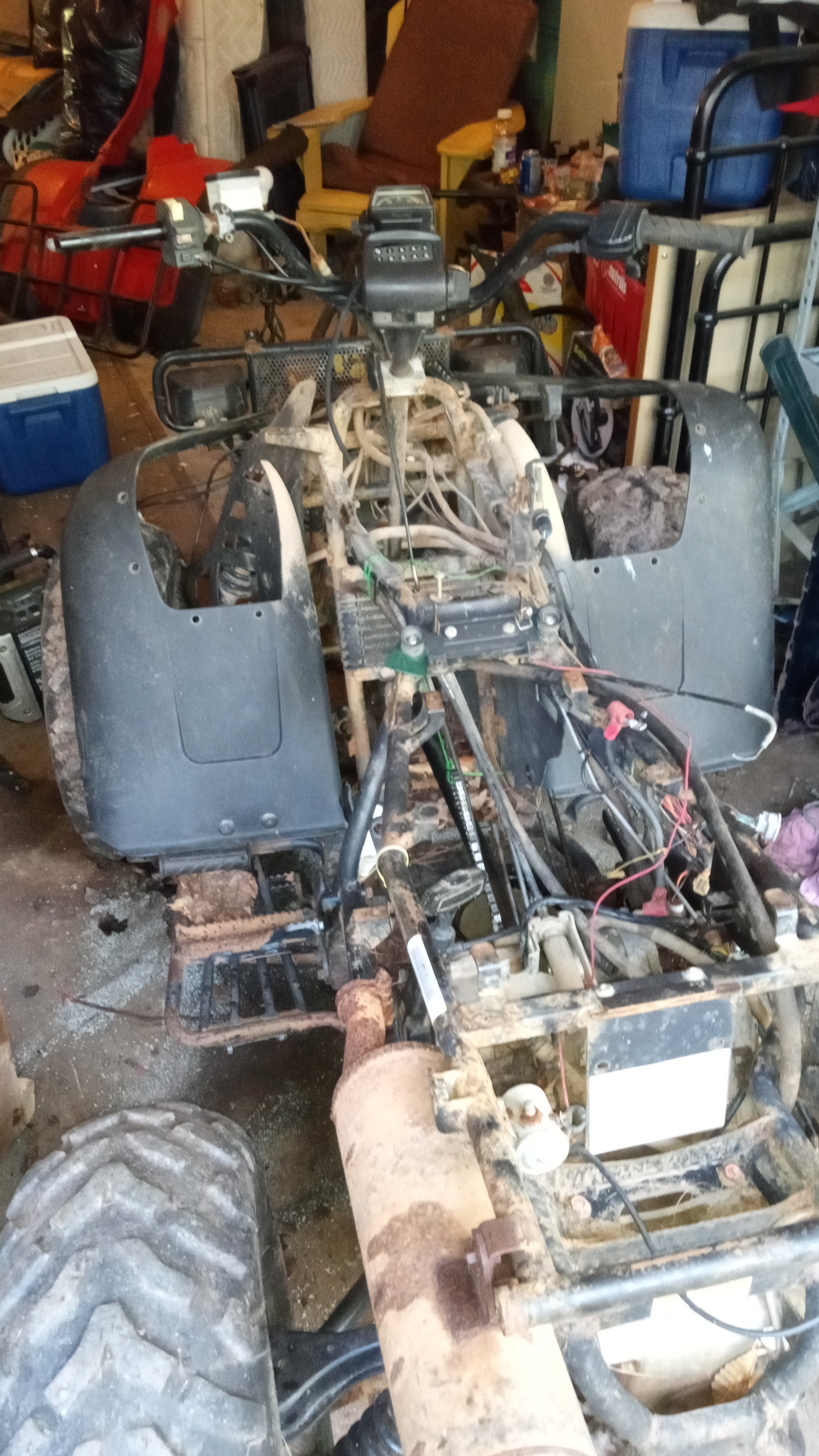

So I picked up two arctic cat 300s they were parts bike but Ive got both turning over and have spark, they get fuel but I can't get it to fire up, even with some starter fluid down the carb and I tried the spark plug hole.
I'm thinking I will have to open up the engine and see what's going on inside as I don't know how long it sat. I'm grabbing a compression tester tomorrow but I was wondering if anyone has any ideas, also do I have to pull the engine to take out the piston and change the rings? There's a fair bit of room, I have all the plastics and racks off because I had to redo the wiring harness. It was a mess.

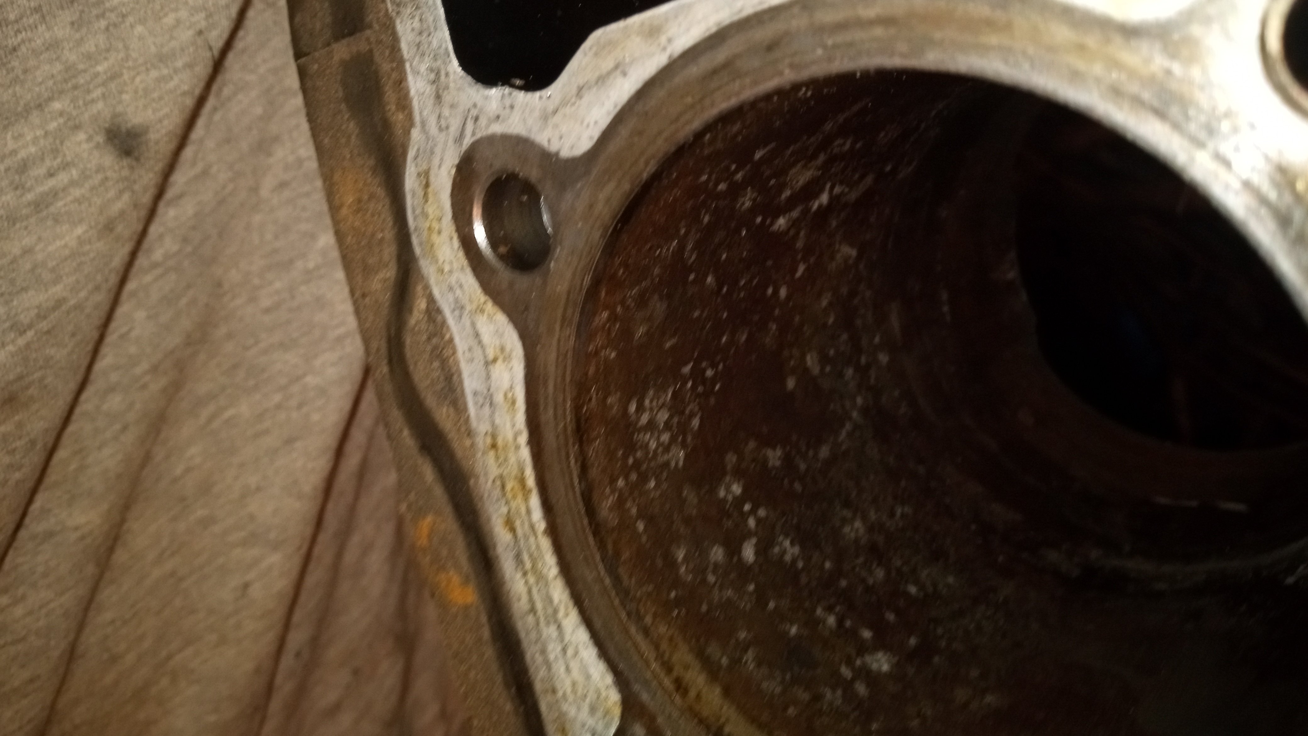

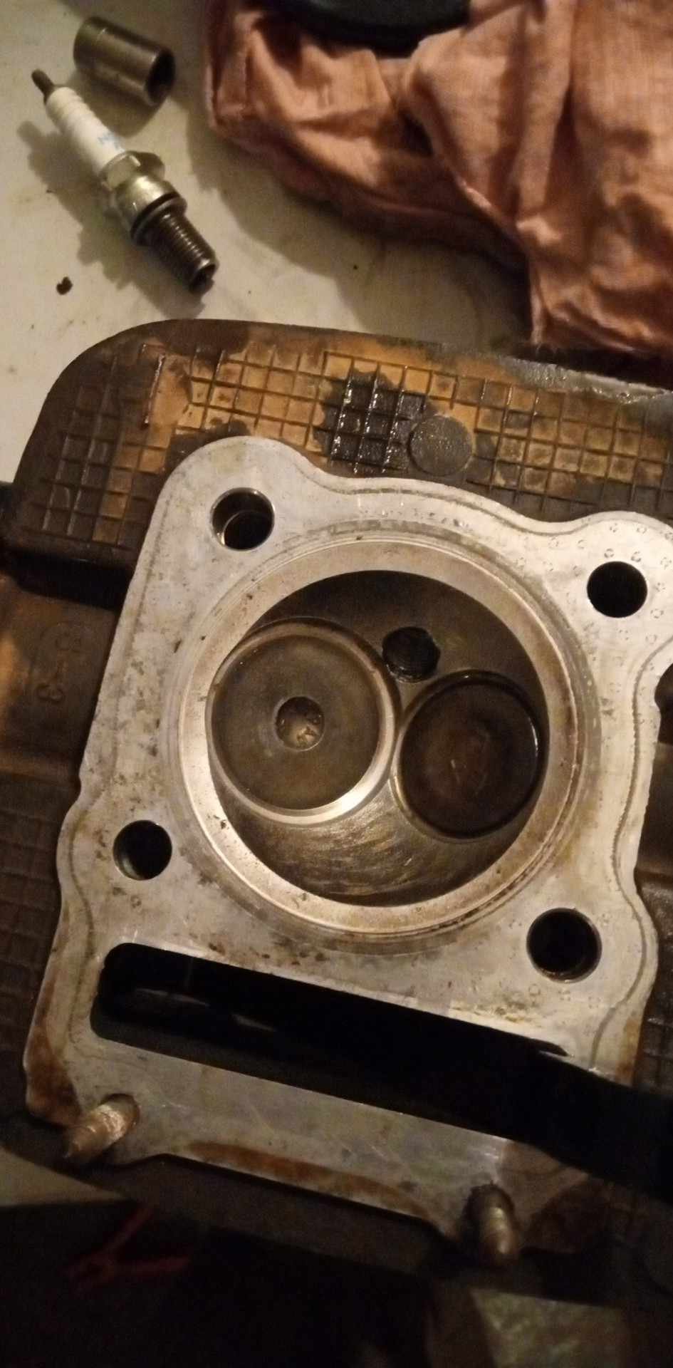

On that note lol, I pulled the head and cylinder. Cylinder wall looks a bit crusty but the piston seems good. I cleaned up the valves and they seems fine so I reseated them.
I'm just wondering if I should get a new cylinder or if it would hone out. Or if I would have to bore it and upgrade my piston

The head looks good if the cylinder does not have deep gouges in it it should clean up good. I would mik the cylinder for wear just to see. Dont know your budget but since you have it all torn down it would be a good time to freshen all that up, if you plan on keeping it, a hard call.

It's identical to my king quad 300 engine, and I am going to look into putting a new cam chain and I'm gonna try honing out the cylinder and if it cleans up nice I will get an oversize piston. If not I will try the head off 1 of my two other parts bike engines until I can get something on and running.

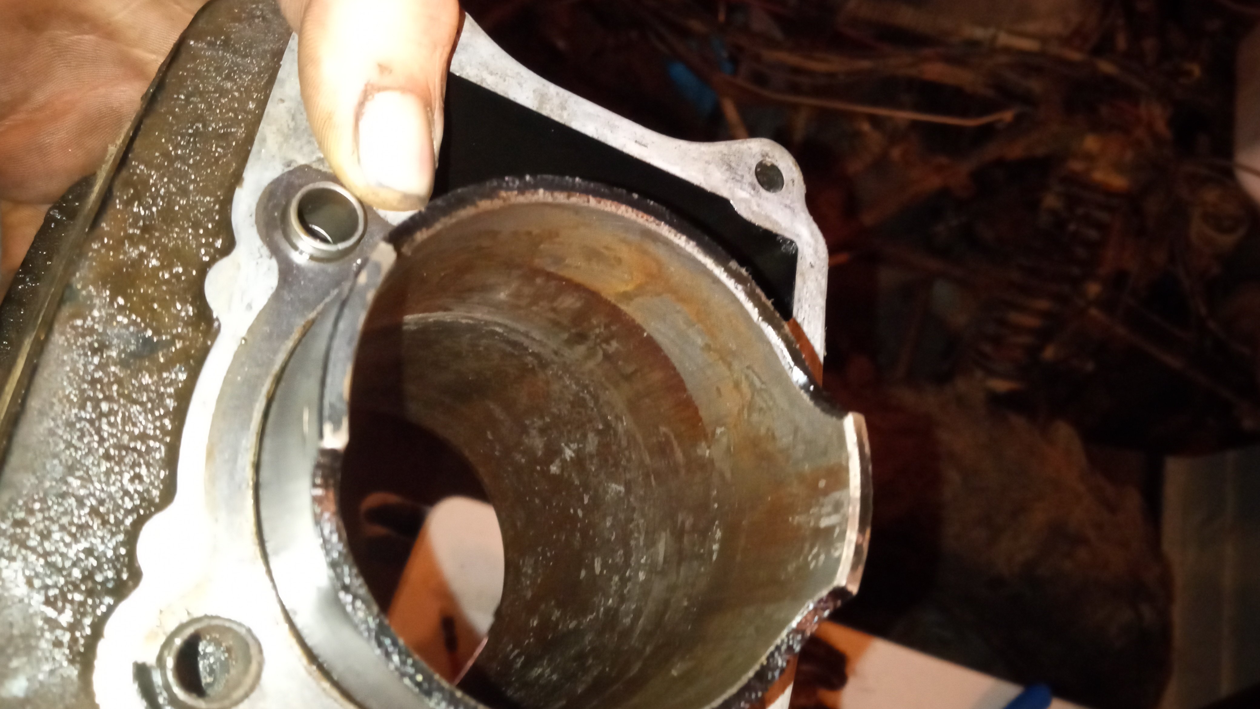

I got the piston out and the rings were seized in so I had to pry them out.
Just judging based on the cylinder wall though I assume I will either have to replace or upsize my piston

Its been stuck there for a while, i dont see any deep gouges it should clean up well. If you are planning on trying to hone it out to the first oversize piston thats a job. I did it once and it didnt really come out that great, it worked but took forever, you know i will try anything once, but wouldnt do it again. I would get my piston and rings and take it to a machine shop, or around here we have  motorcycle shops that do boring, 100.00 a hole. Thats 100 well spent if they do it right. The problem i had honing to the next size the hone stones didnt really stay where they were supposed to as they were spinning and they were ripples in the bore. You may have a better hone and it might work perfectly, but it didnt for me, plus it needs to be very exact piston to wall clearance.

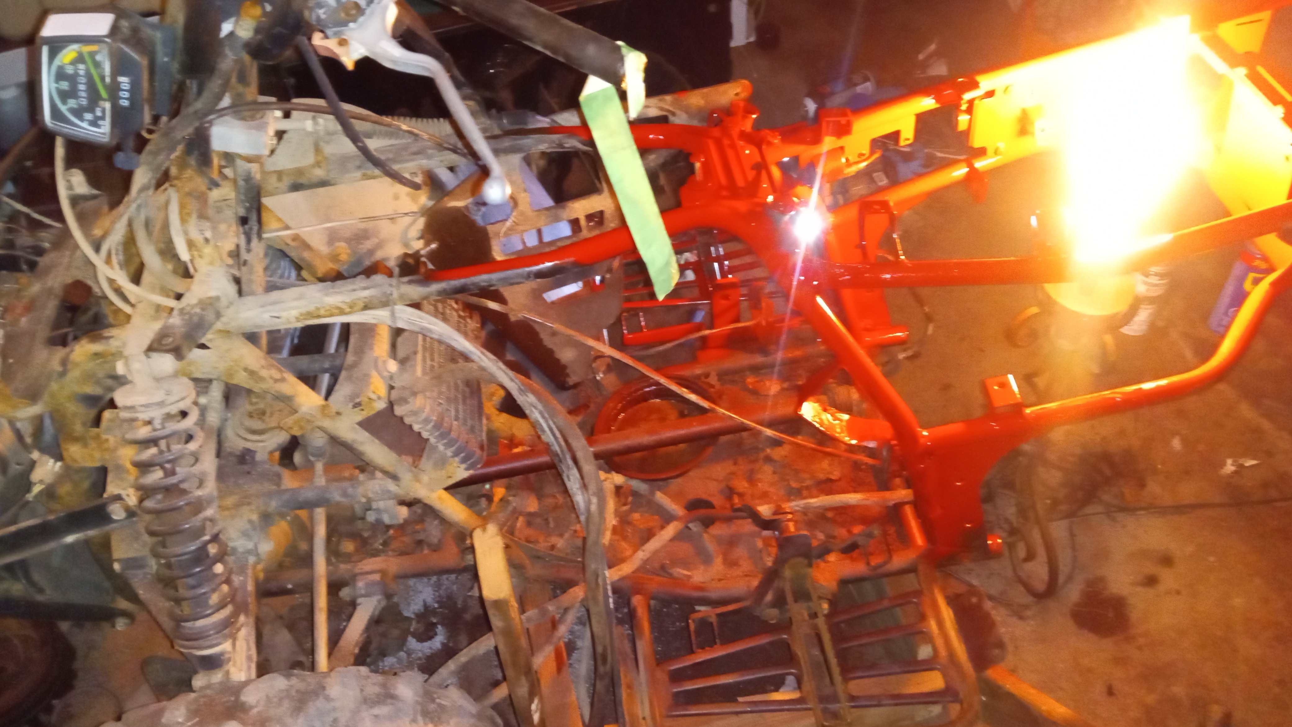

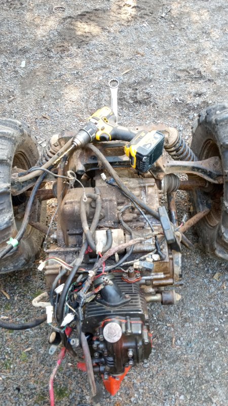

So update. I got the engine running and it runs great, I found the piston rings were seized on the piston so I took it apart and cleaned it up and hones the cylinder and also reseated the valves it has good compression and fires up pretty good now. But I found multiple cracks in the frame so I ended up pulling the engine and rear end to swap into the other bike

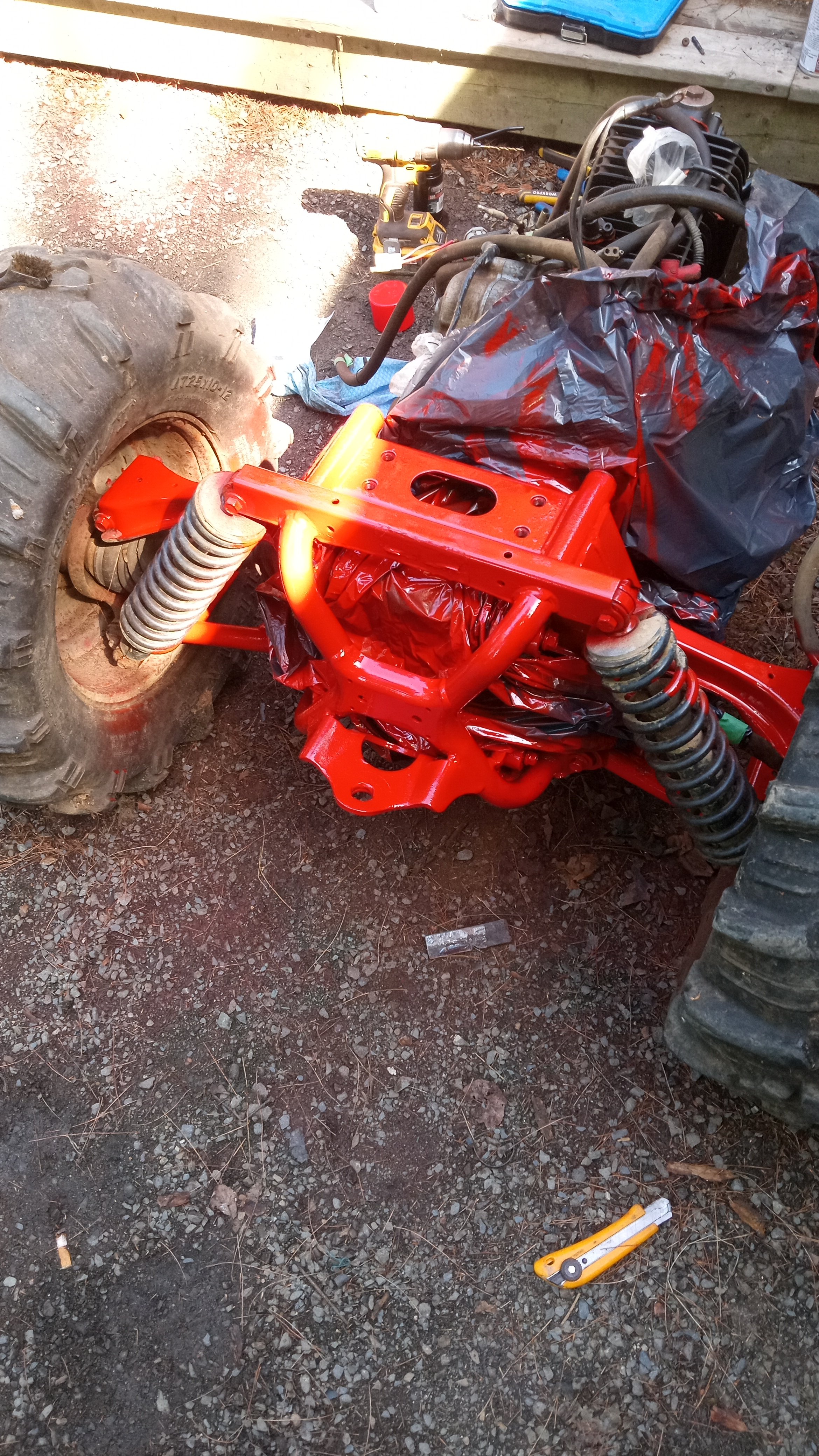

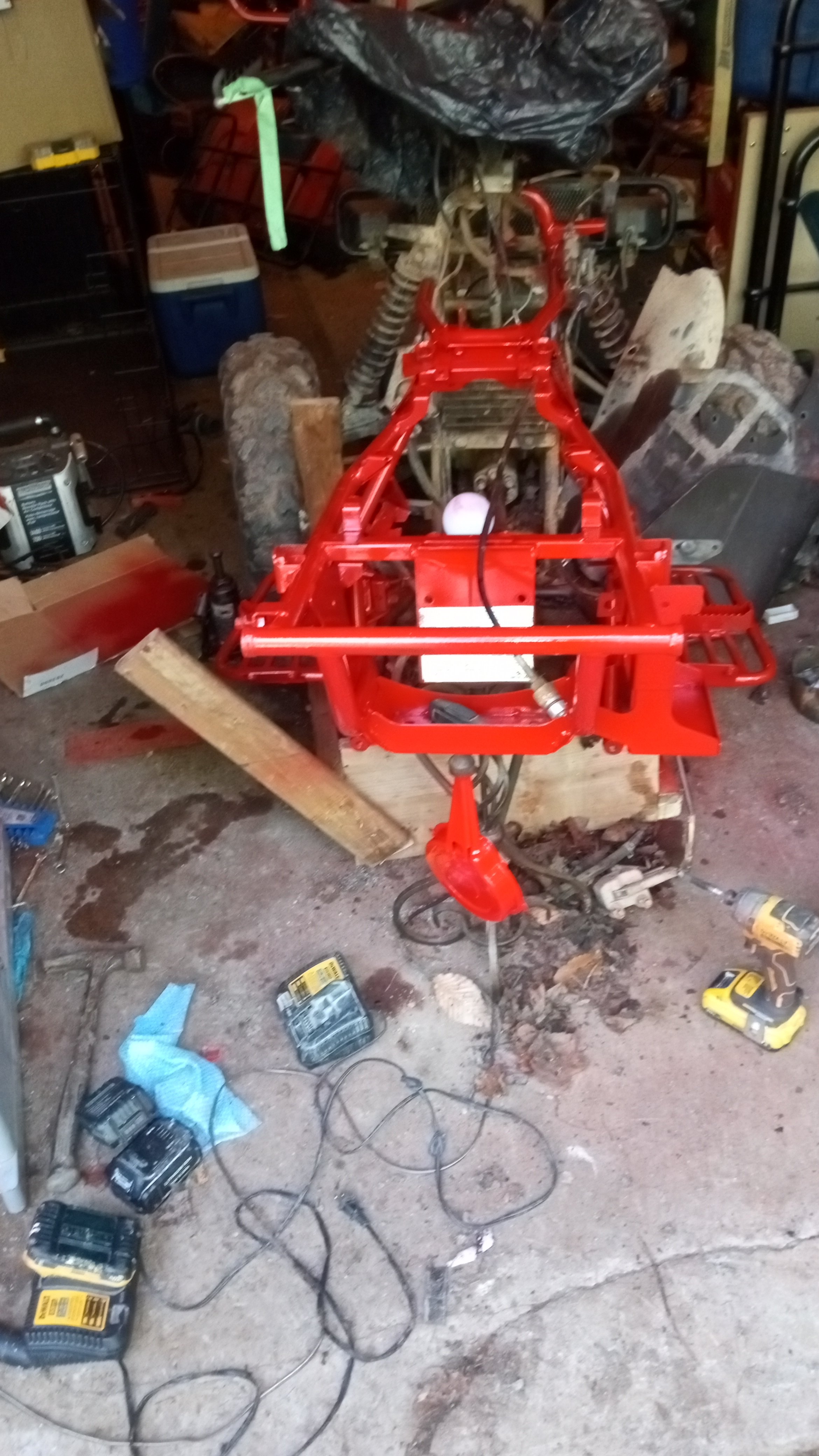

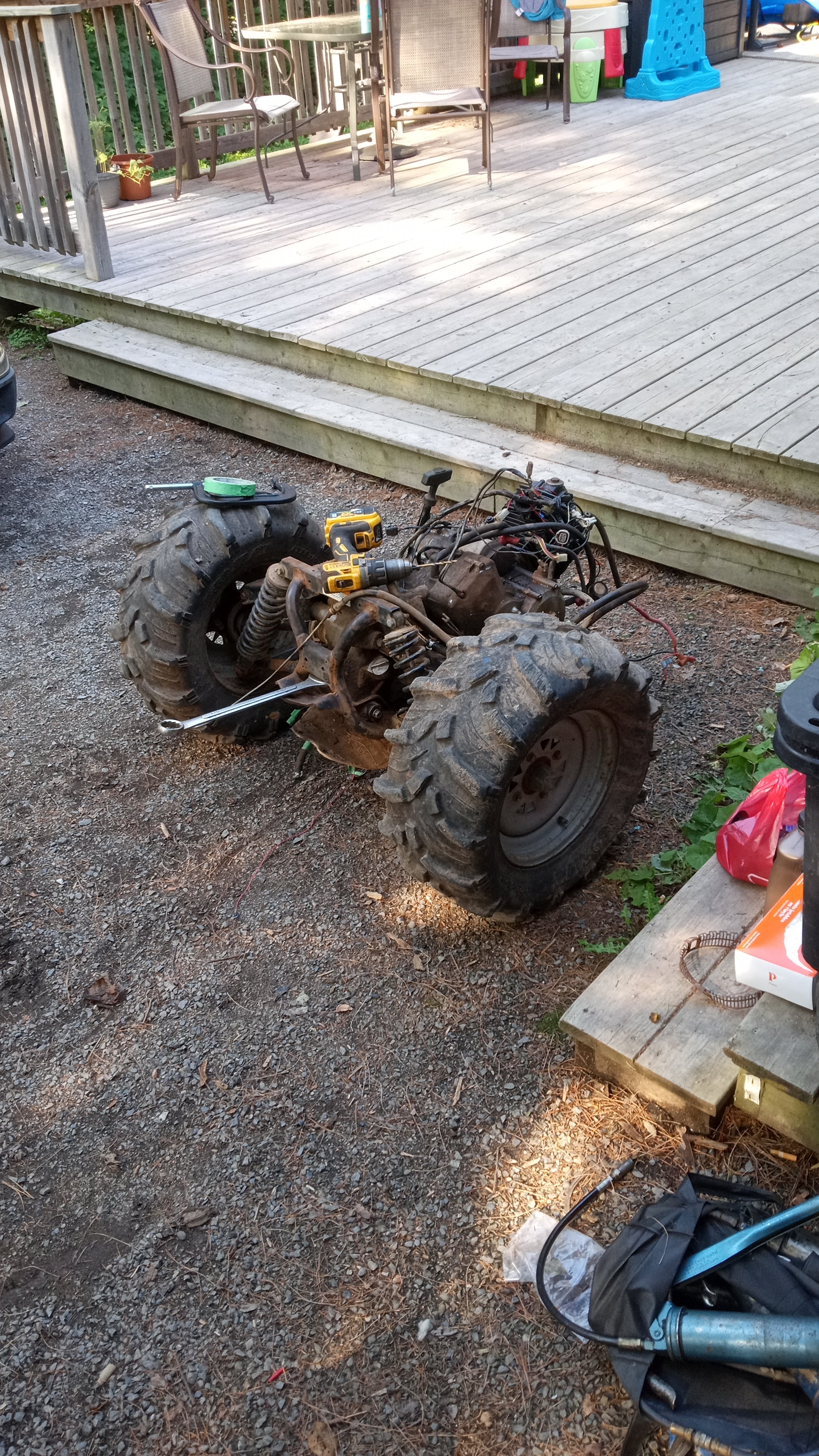

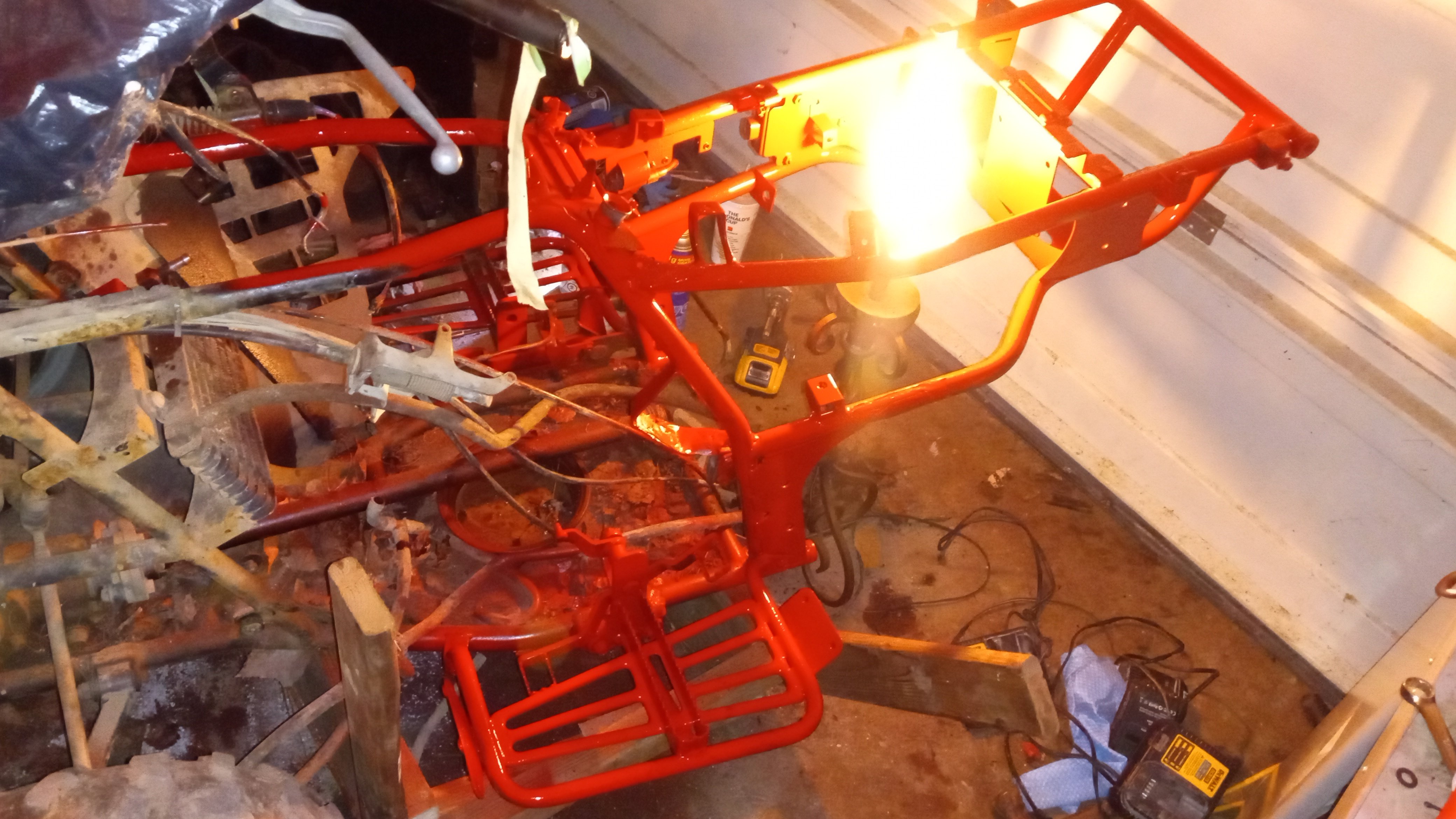

Yeah I'm glad I'm in the two bikes for 400 and parts/tools another 200 but I pulled the rear end off both last night. I found another crack and said the hell with it I'm swapping frames so I'm undergoing cleanup at the moment
I'm building it for the woman so she wanted it red
I haven't done much of the paint fyi! It's her bike

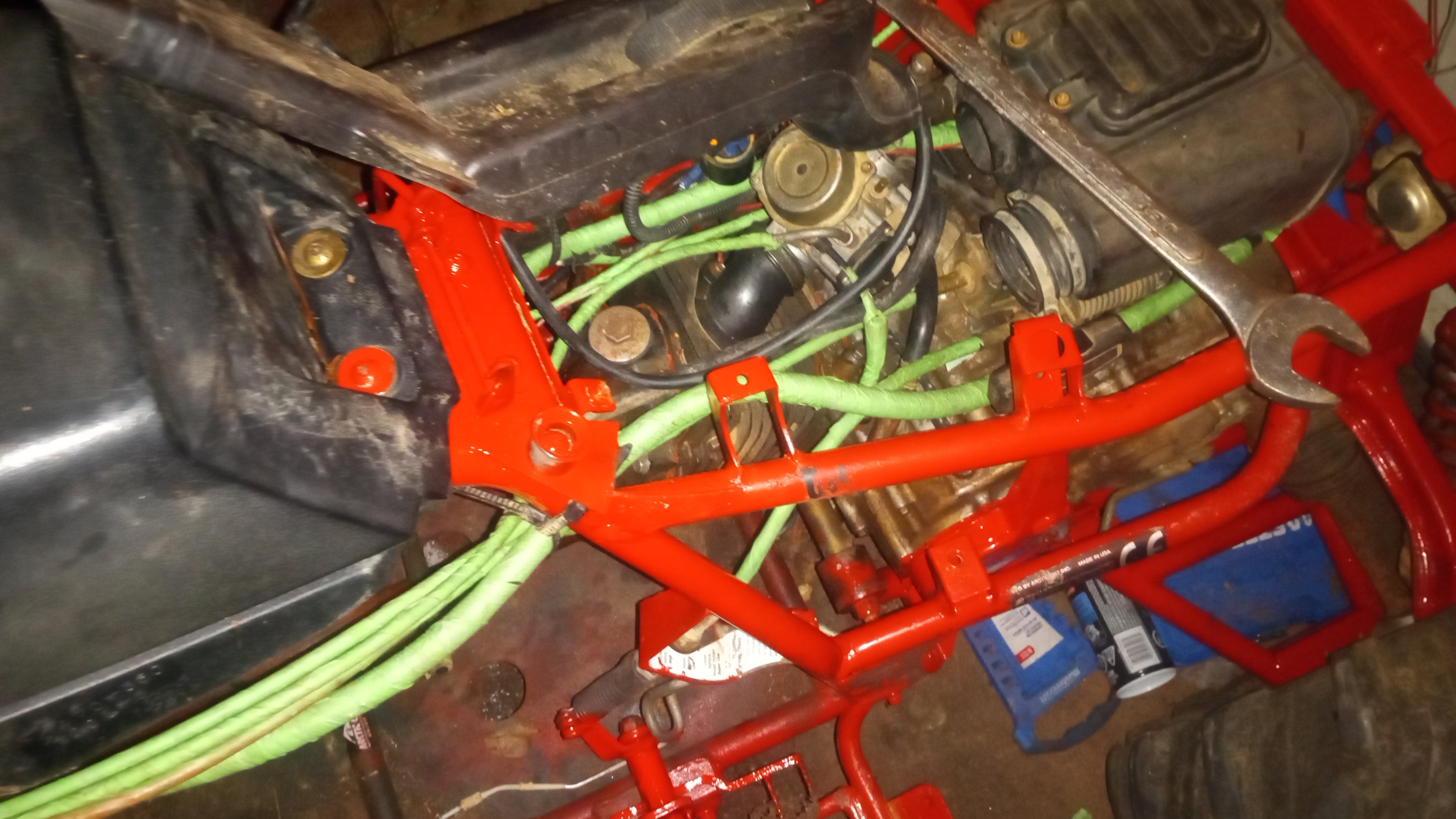

As it was a parts bike like the other I had when I first got onto the rebuild I found a couple cracks in the frame. So I welded them and welded angle support  then later on in the rebuild I found two more on the bottom of the frame so I ended up pulling the wiring harness speedometer and brake lines, shifting linkages off and pulling the rear end of both bikes out.
(Honestly though good on ya arctic cat because besides the rear end being a bit hard to manoeuvre the rest of the bike is easy to walk around)
I have new brake line on from Canadian Tire for 8 bucks and have to bleed the lines to get it up and running again, but I think I am going to pull the head again. Clean everything up and check the cylinder size then order some new rings and put it all back together again. Hopefully for a long time lol
