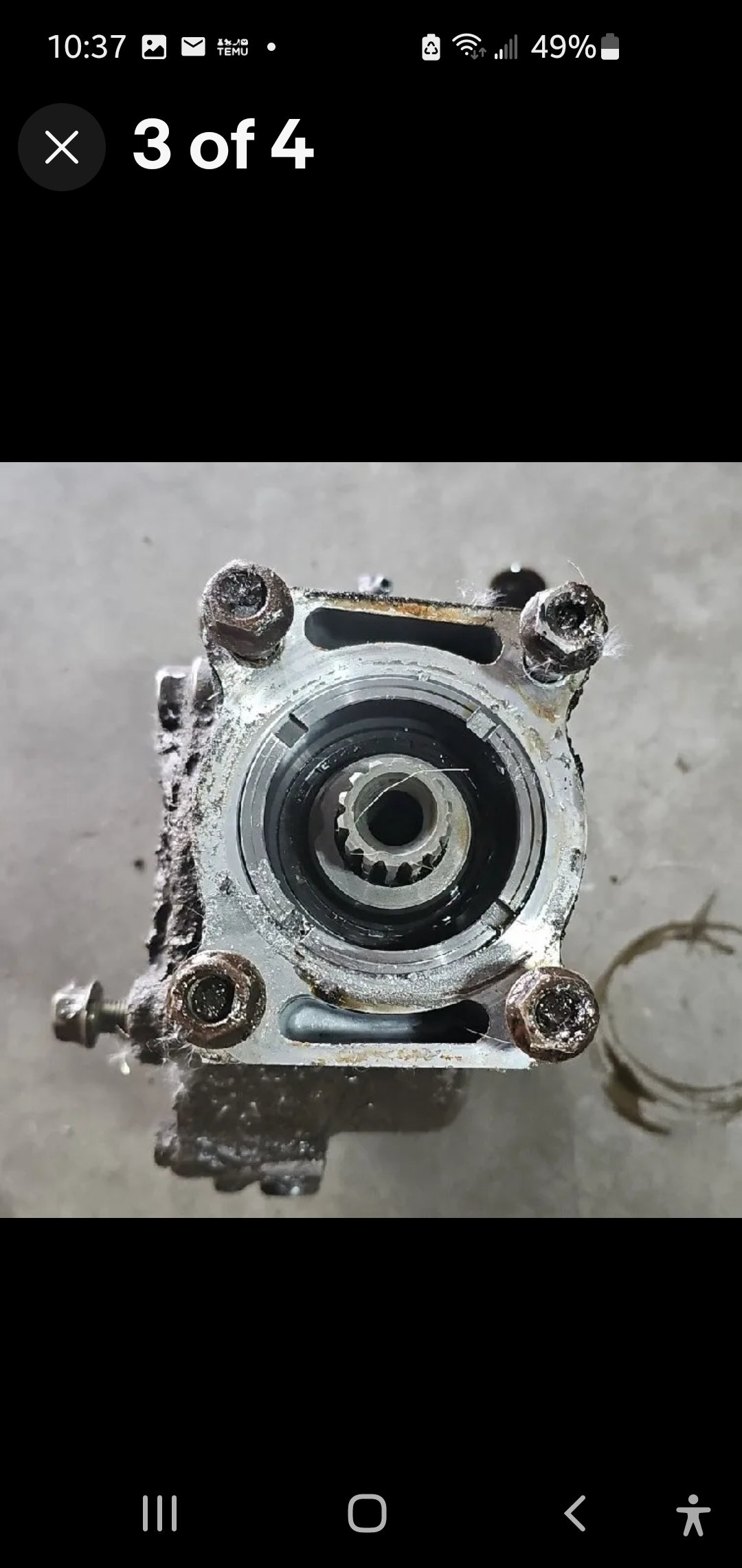

Hello I know this is an older thread but I too need some help or insight 😅  the rear end pinion that everyone struggles  with that threaded collar with the 4 divits special tool required  anyway I got that frigger off and the pinion shaft out my question is how do I remove the bearing there's another fixed bearing or collar on top of the bearing and it's not in my rebuild kit and I can't find any info online on these bearings to be changed as most swiped it do to not being able to get the collar bolt off the diff to access the bearings laughing out loud  😂 any help would be great
Anyone get the bearing changed out successfully in the rear pinion? Finally got the collar off but unsure of the bearing removal it has somthing above it looks like a bearing but maybee a  pressed collar? Any help much appreciated  yfm400 kodiak/bigbear/wolverine
The service manual says the pinion bearing retainer is left hand threads(but I suppose you already know that), and that the pinion shaft can be tapped out with a soft mallet. Then you can use a puller or a press to remove the inner bearing and the sleeve off the shaft at the same time. To get the outer race of the inner bearing out of the housing they say to heat the housing to 150C and use a suitable punch to remove it. It looks in the diagram that they are using a wedge ended punch to wedge the bearing outer out, but I'd probably try heating the housing then banging the housing down on a big block of wood on a concrete floor hoping it would drop out.

Yea correct I got the collar off and pinion shaft out on bench just can't find anything online every rebuild skips this bearing cause of the colat tool required laughing out loud I watched every video on u tube with this type diff and nothing showing the most important part of rebuilding the pinion bearings and seals if anyone has info or pics video even a repair manual wouldn't mind sharing it with me would be awesome I need to get the bearing off the pinion shaft has a retainer type looking like a bearing above it  thanks again for all the info shared on these bikes guys
