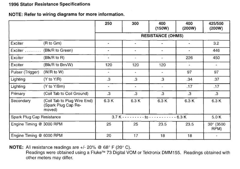

   02/15/18 I had sometime last night so I opened the covers to check the timing marks. The cam chain does not seem to be overly warn and the tensioner keeps it nice and taunt. The timing marks and top dead center all line up. So I also checked the Stator and trigger coil for resistance readings and they all fall within the attached Chart.
So here we are again I cant seem to figure this thing out. What is left to check?
5a857c6e4001b_resistancereadingsPolarisStator.thumb.jpg.ce5f68b1ad1690332c6048a5cc6036e9.jpg
I am at a total loss with this machine. I am usually pretty good at figuring these things out but this one has me completely stumped. So any suggestions will be appreciated.
Thanks Woody.
Why don’t you warm the bike up really good (hot) and the take the readings on the stator, and pick up coil again to see that they aren’t breaking down when hot. Also include the regulator.  Hopefully the readings are the same and within spec when hot.
That is an excellent suggestion Thanks. That is what I like about these sites it gets you to think outside of the box and you can tap into everyone experiences. I will definitely do that and let you know Thanks again for the Idea's

  Well I finally got a chance to let it warm up and test the stater and other winding's to make sure they are not breaking down when hot. The readings were within tolerances so I moved on to checking the valves. I decided that this engine has some miles on it so I changed out the valves, springs, and cam. Started right up and again at 1/3rd throttle she would start to sputter and die.
  So I am really frustrated with this machine. Everything tells me its electrical. So I needed to walk away.
So this morning I went out and worked on it and tried to approach it like it was the first time it messed up. i started the machine and checked voltage at the battery. 12.2 static and when started 14.2. No problem there. So I thought I never checked that voltage with the machine above idle. So i got some clips and left the meter attached. At about 1/3 rd throttle I am pushing 16 volts if i push it or rev it I can get the voltage to go clear up to 19, 20 volts at the battery
  So the rectifier is bad because the voltage at the battery should never get about 14.5, which in turn most likely f,d the CDI. I am going to do some more checks and will post.  Hopefully this is it. This machine will have almost all new parts. I probably should have pulled the jug and got new rings and piston while I was at it.
 Thanks for the inputs and if anyone has any other suggestions please let me know. Thanks and I will try to ensure I post once i get the new CDI, Voltage Regulator and rev limiter. To day I am going over all the wiring and checking and cleaning all the terminals to ensure there are no other electrical issues
