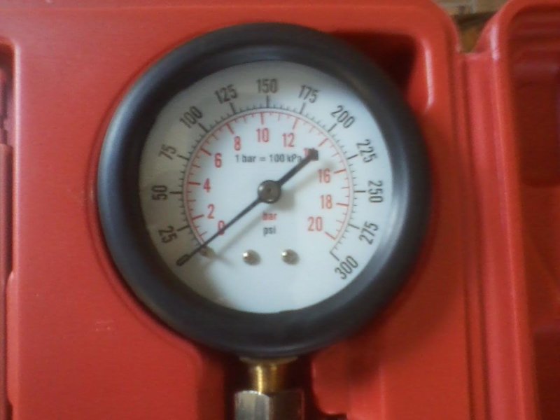

And it never got past 60 psi ?
So that’s a bit of a problem.  It was prob ran hard.   I would think a new set of valve seals, piston and rings are required to bring that compression back to where it belongs.

ok so this thing has me confused now:  I was out riding a couple days ago and I turned it off briefly to do something and when I tried to start it again, it would turn over fine, but wouldn't fire at all.  I assumed that it blew a sp since it had done it before-  new sp in it and no difference.  I just checked compression agian and it is reading 80psi since it stopped running..   :frown:  It was 60psi when it was running
I assume I just go ahead with the plan of replacing the top end seals, piston, rings, and cylinder?
So yes I would proceed with the top end work. There is def something going on as well as low compression.

I have ordered them and some have come, some haven't yet...  I have the oem carb in so I'll start rebuilding that soon.  Right now I'm waiting on another project in my shop to start on the bayou.  As to the compression testing, I have never heard anything about where the throttle is supposed to be.  The directions that came with the test kit didn't mention throttle at all.
