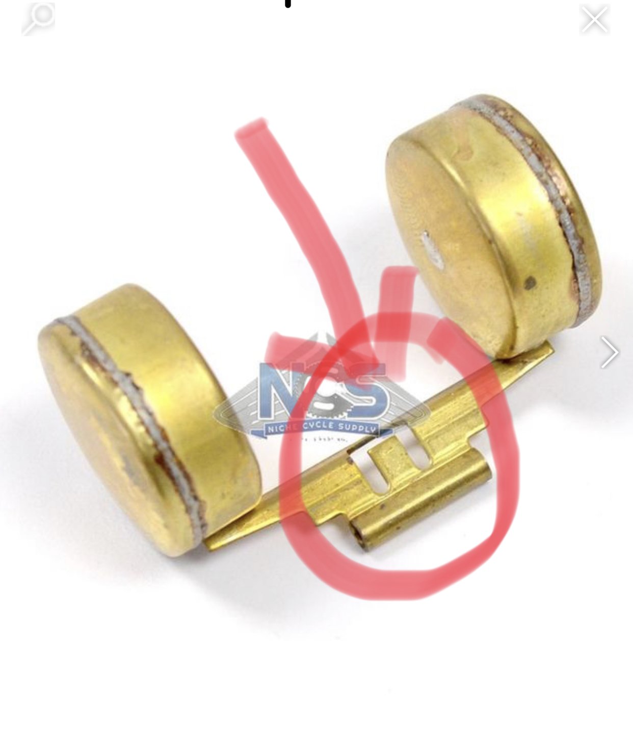

2 the carb is definitely having an issue. I know you rebuilt it but there is  a problem. It could be the tab on the float that’s not set right allowing the bike to keep filling. Do you know the tab I’m talking about ?

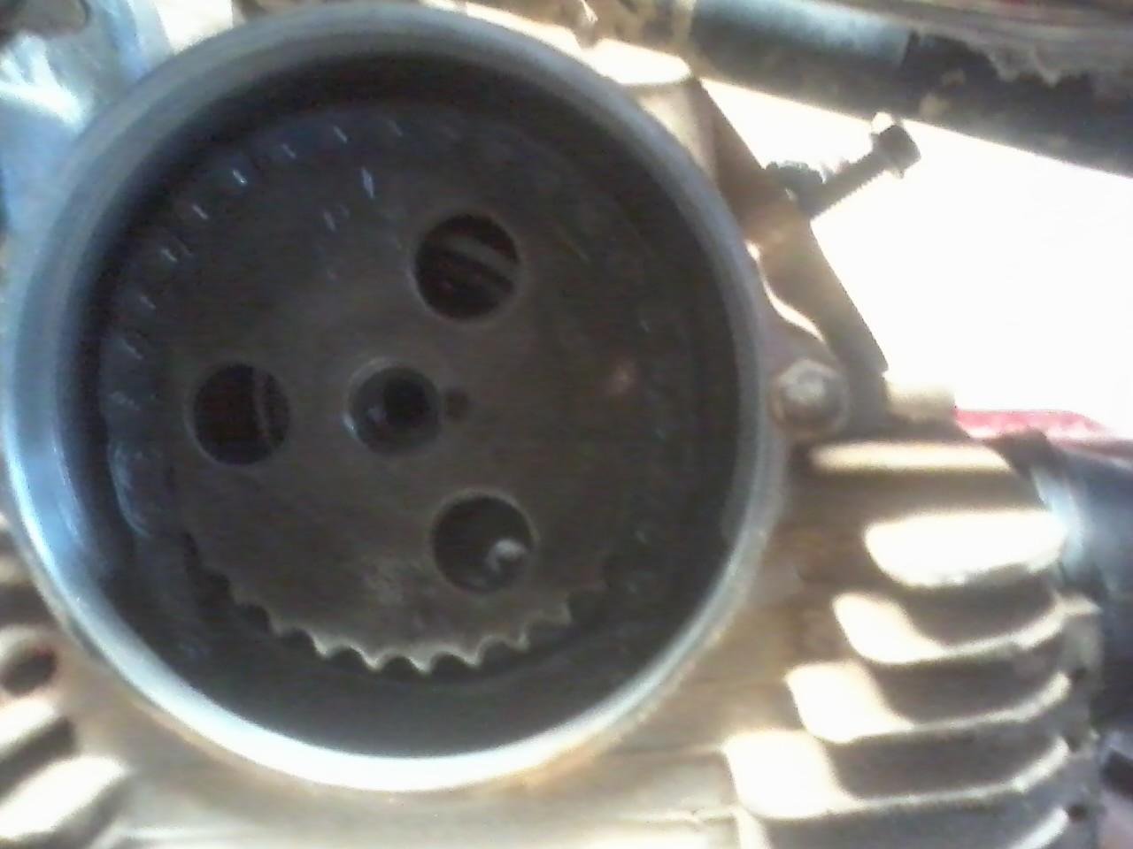

  1. when I took the cam sprocket off, I took a pic which I'll upload.  If you look at the pic, there is an indent in the sprocket just right of the center.  I made sure that was to the right again when I put it back together, with the 'T' mark centered on the flywheel
  2. Yes I do know the tad and I had adjusted it to keep the gas valve in farther (I was thinking that might help with flooding)  The float was not sticking when I took the carb apart....  the only thing I can thing of is I put the clean jets off the aftermarket carb in the oem carb (they all looked the same)  maybe that caused a problem?

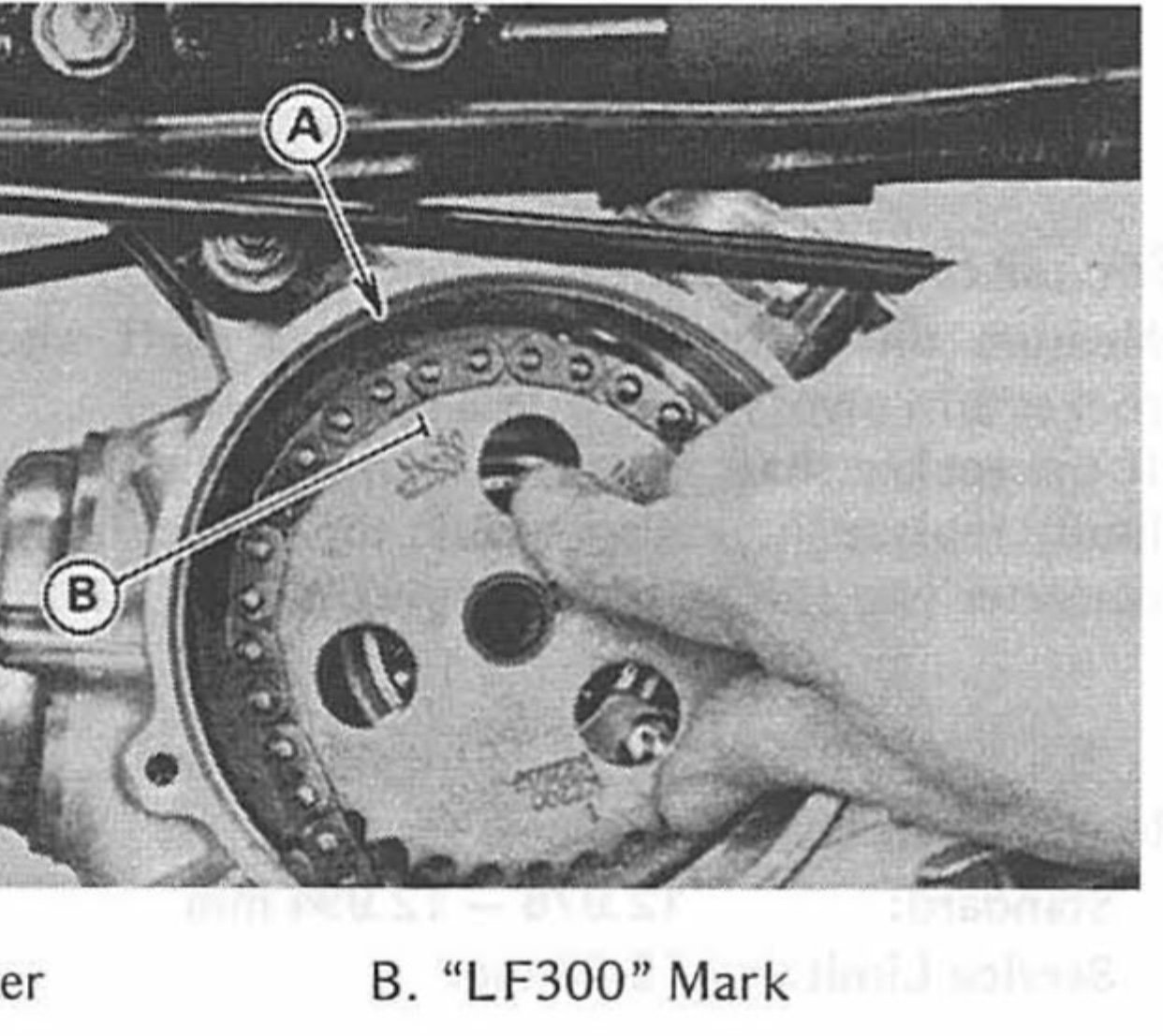

I have attached a pic from the manual. The tab (indent) on the sprocket has to be aligned with a mark on the head.
Let me know if you have this set that way.
I tried to upload a pic it won’t let me upload 🤬🤬🤬!  Anyway page 46-47 section 3-12.
If not then the timing os out.
If you are looking at that sprocket housing I’m going to say around 11 o’clock there should be a mark.   That mark should be lined up with the tab on the cam.  There are marks on each side. One says 220 not yours.  The other is for your bike.

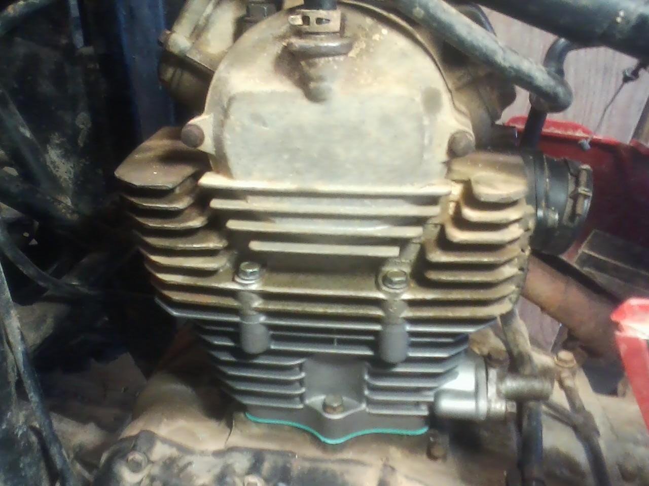

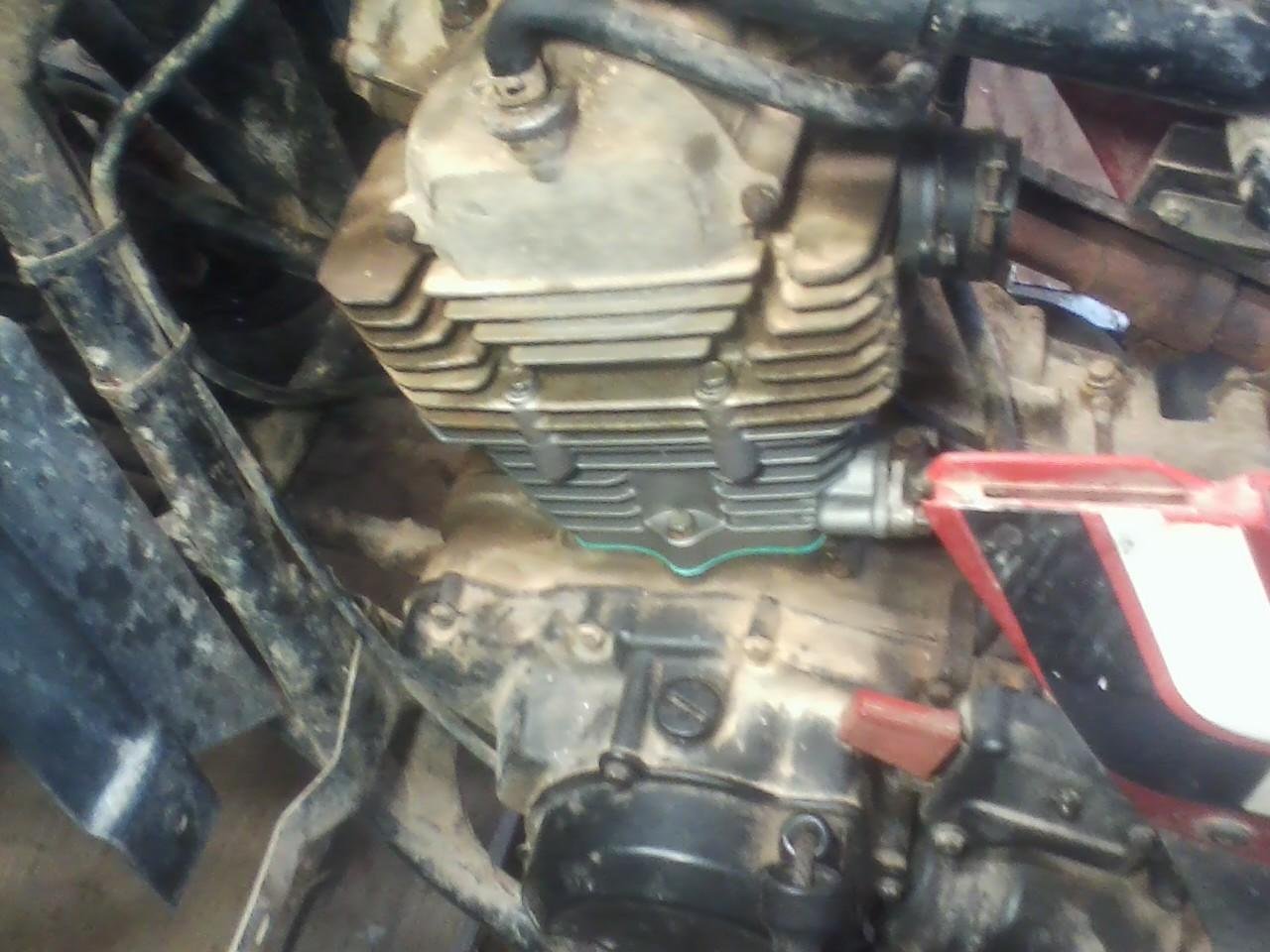

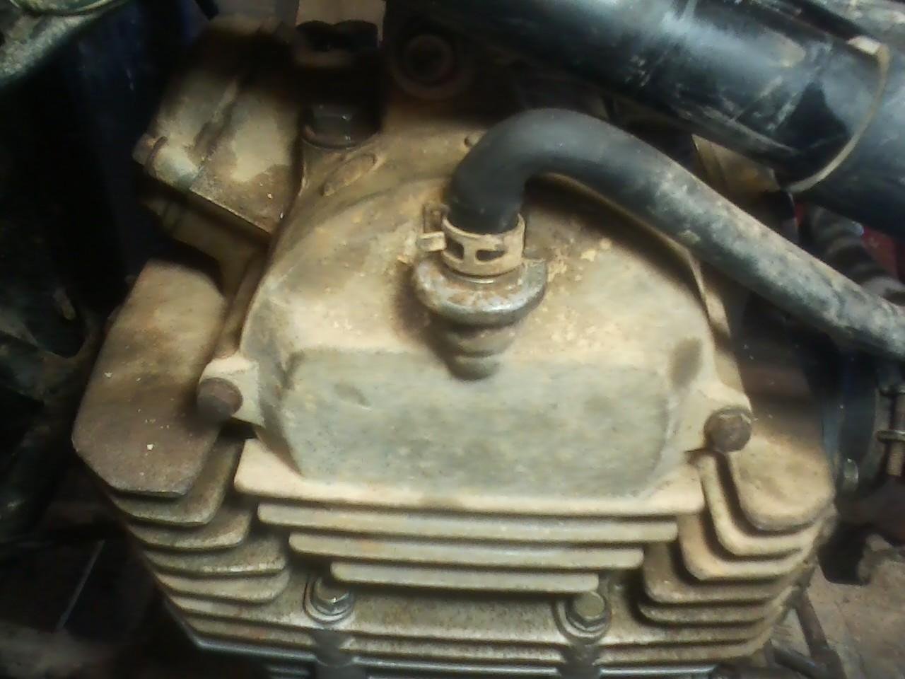

ok so I took some pics (I'm not really sure what mark you're talking about)
just took these, I'm not working on the bike today, (too cold)  will be working again on it maybe wednesday, but I want to figure out a game plan before working at it again.
Def need a game plan smart move. Did you download the manual ? I looked on the manual and it’s telling me otherwise.
There is a mark as per the picture I posted.
You have to double check against that pic I sent.
You have to pull that cover off the sprocket with the 8mm bolts and look to see if there is a mark there like the pic I sent.

didint see ur pic at first, this is what I have! ☝️  the two marks (what he's pointing to) are in line with the cylinder.
This is what I have:  The red dot is the center of the cam, the blue dot is the indent I was talking about (it faces toward the rear of the bike)  the green marks are what you're talking about that are lined up with the cylinder.  the pink circles the cap on the flywheel to view the 'T'mark
I can take the cam cover off next time I work on it to check the mark on the head (A)

Ok so over the next few days read that manual. I have a feeling it’s not right but hope you are correct.  The way I read it it tells me that A and B need to be lined up as well as the T mark on the flywheel. I have a 400 bayou and a 220. You have the 300. There are differences so we need to be sure here.
I would take it off the bike and open the bowl up to expose the float.  Hook up a clean hose to the gas line on the carb and blow into it and manually raise the float up until the air flow stops.  If it travels to far up before the air stops then adjust the tab on the float up a bit.   If it does not close off at all  then that’s a float needle and seat issue that may be no longer good as there is a small rubber tip on the float needle or may have been caused by using the other jet kit from the Chinese carb.  Try and put the old one back or order an oem jet and seal kit from amazon for $20 bucks.
