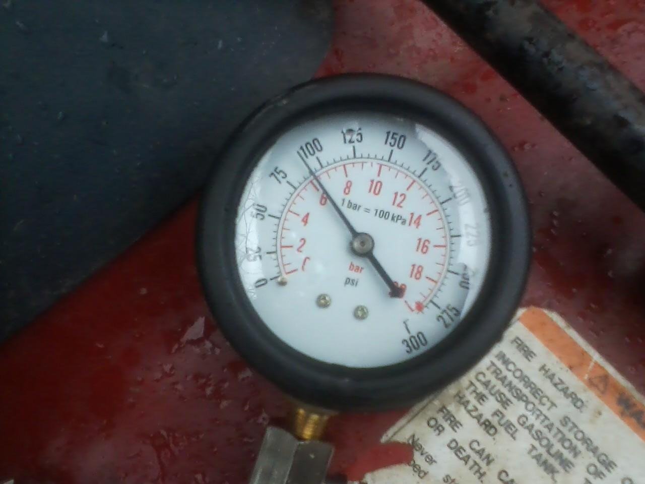

ok so I went out this morning to start it and it wouldnt start (cranked but not firing).  have spark, kill switch is on, checked compression and its around 80psi.  the sp was wet and black.  I knew it was running rich cause it was blowing gray smoke when cold and with choke.  Not sure if this is connected to the valve rocker or not.
or maybe its at 90psi
I would try another sp, but the one in it is new as of the rebuild and it was stuck in the rain and I didnt want to open up the sp because of moisture.
Spray the plug down good with carb cleaner and wire  brush it good double check the gap and check the spark agin on it. See how it looks.   If spark is there it will fire.  The wet plug is prob from the carb in need of adjustment. Try maybe half choke on the start up.
