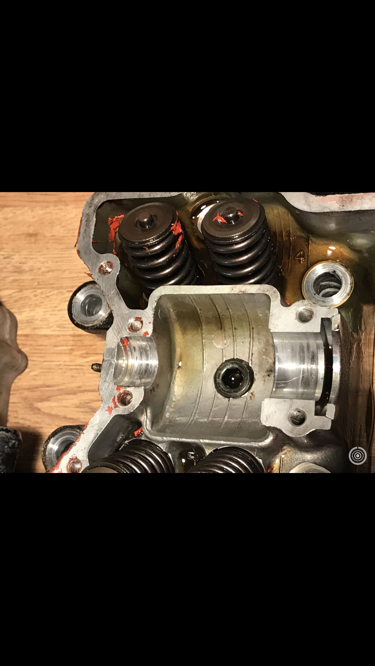

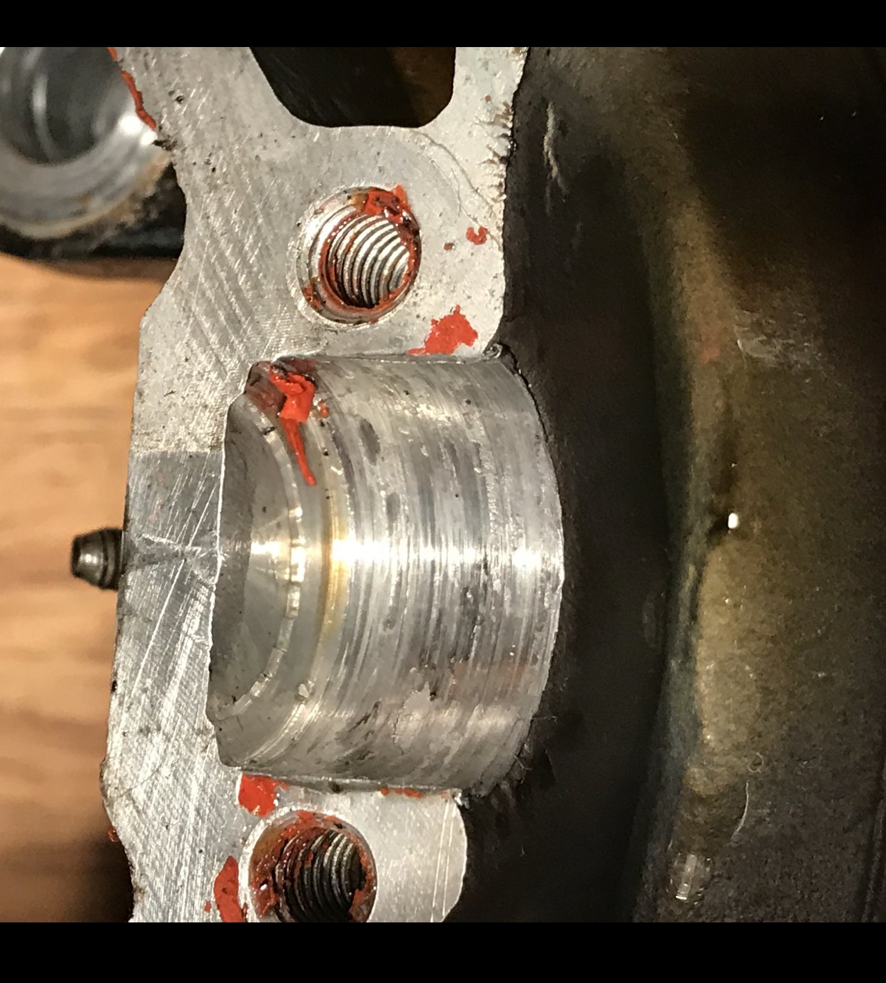

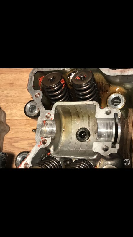

The only knock I can think of was on my bayou 400 and it was where the cam sits. It’s called a journal where the cam sits.   The cam was actually hopping up and down. I should hope that’s not the problem.
Here are a few pics of my old head where the cam sits. Did you take any pics or notice this condition ?
cam seemed snug to me- mine slid out the side off the head because my head doesnt come apart like yours.
