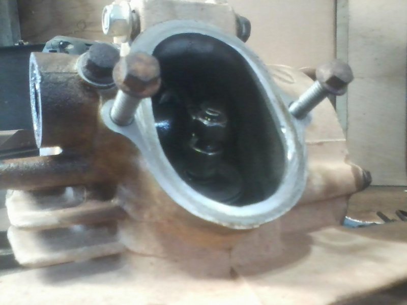

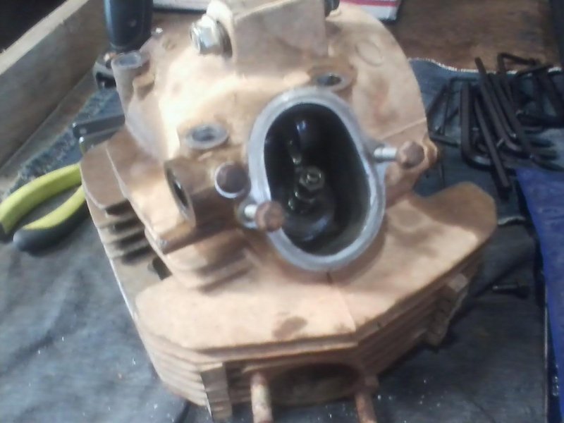

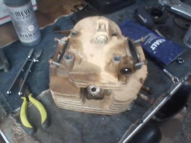

So I wont need to take the head apart?  (that would be nice)  I'm thinking the rings were going bad and then the buildup just held the valves open?  I do have the top end gasket kit but if I dont need in for the head, I'd rather not take that apart and get into the valves.  I will check the clearance with the valve tool i got when its all back together.  Carb cleaner is exactly what I was going to ask about for the buildup lol  I'll make sure to get everything oiled down before it goes back together.
I’m not sure about the build up holding the valves open. I don’t think that would be the case.   You can check the clearance but you won’t be able to check the valve seals visually so I would think having the head off would be the most ideal time to change the seals.  It would really suck to find out your seals are bad after all this work. So I would change them.  But that’s up to you.
I could sit here and explain it to you but your better off going to you tube and seeing how it’s done. It’s not hard at all and you won’t damage the valves.   Just make sure that you pot the valve back in the same hole it came from.   I mentioned in my earlier posts about getting a tool that helps you compress the valve.  You can buy one for about $15 on amazon or go to your local auto store and rent one etc.
Clean  the valve good before you put it back in.

Yes, review the video one more time and be aware that the small clips that hold the valve in they can fly off if your not seated correctly.  They are impossible to find once they take flight ! Lol so be mindful of them not falling out when you are removing/reinstalling etc.
Check  the valves for any obvious bends or damage
Make sure you re install the valve back in the same location it came from.
Clean out the port and valve itself of any carbon buildup before putting it back and grease the valve stem as well when sliding it back in.
The old seal pops off and new new on pushed right back on.
