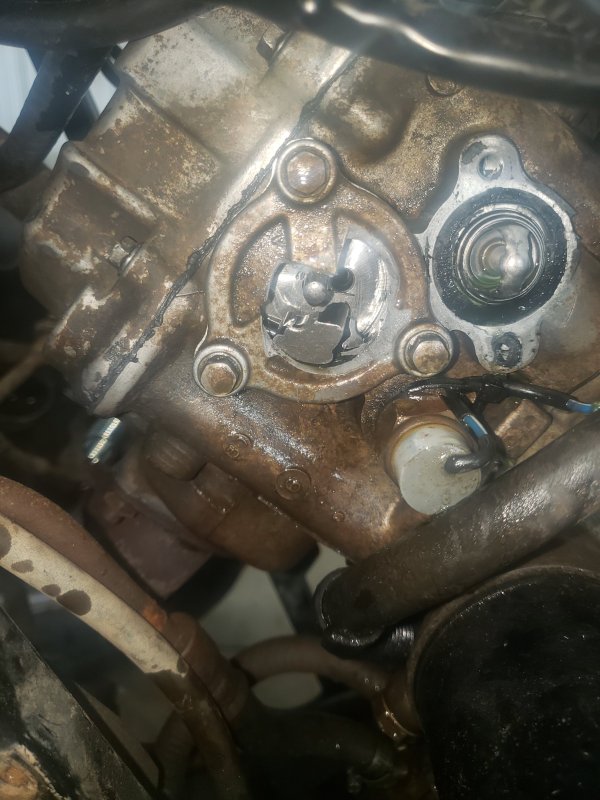

I just put in a brand new cam and a brand new cap and it just did the same exact thing is there something that holds that cam or decompression ring in place. Also I noticed another thing when I started it disconnected the battery ran like it was supposed to hook battery back up couldn't hit the gas again. I'm getting so frustrated with thing its unreal about the hundredth time I've taken it apart.

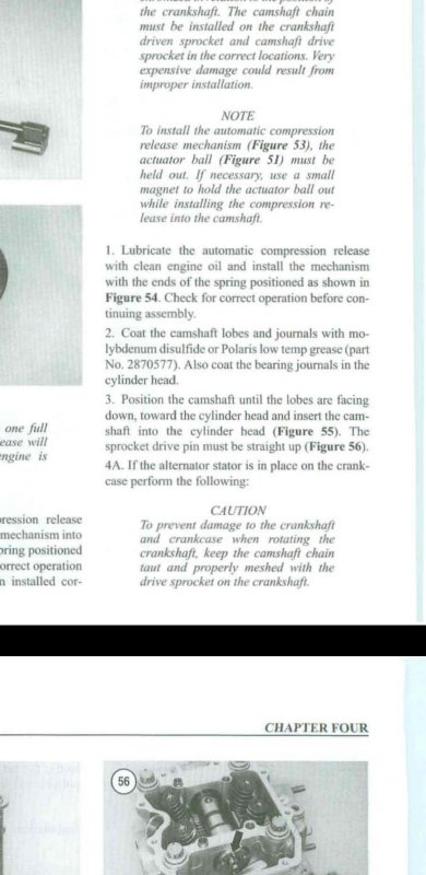

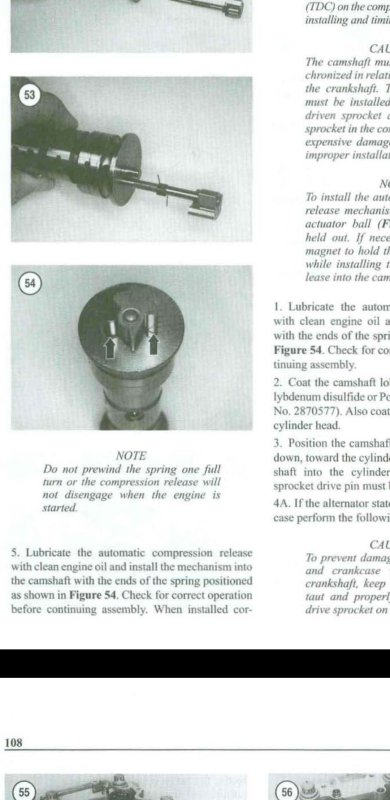

It will go in 2 different ways but I put it in exactly how the service manual showed it both times now before I put it in and wounded the spring once never had this problem now manual says put it in with spring in relaxed position do not wind it once it will not work right but both times broke the case out like something is throwing it out the busting the weight off and weird thing it started running perfectly when I unhooked the battery its getting so much juice from stator it blew my neutral light out this is crazy I just keep throwing money at it and just keeps costing me more its insane

Can you screen shot the page that explains the cam and spring installation and post it here ? I want to read it. I don’t have time to start looking for the manual
