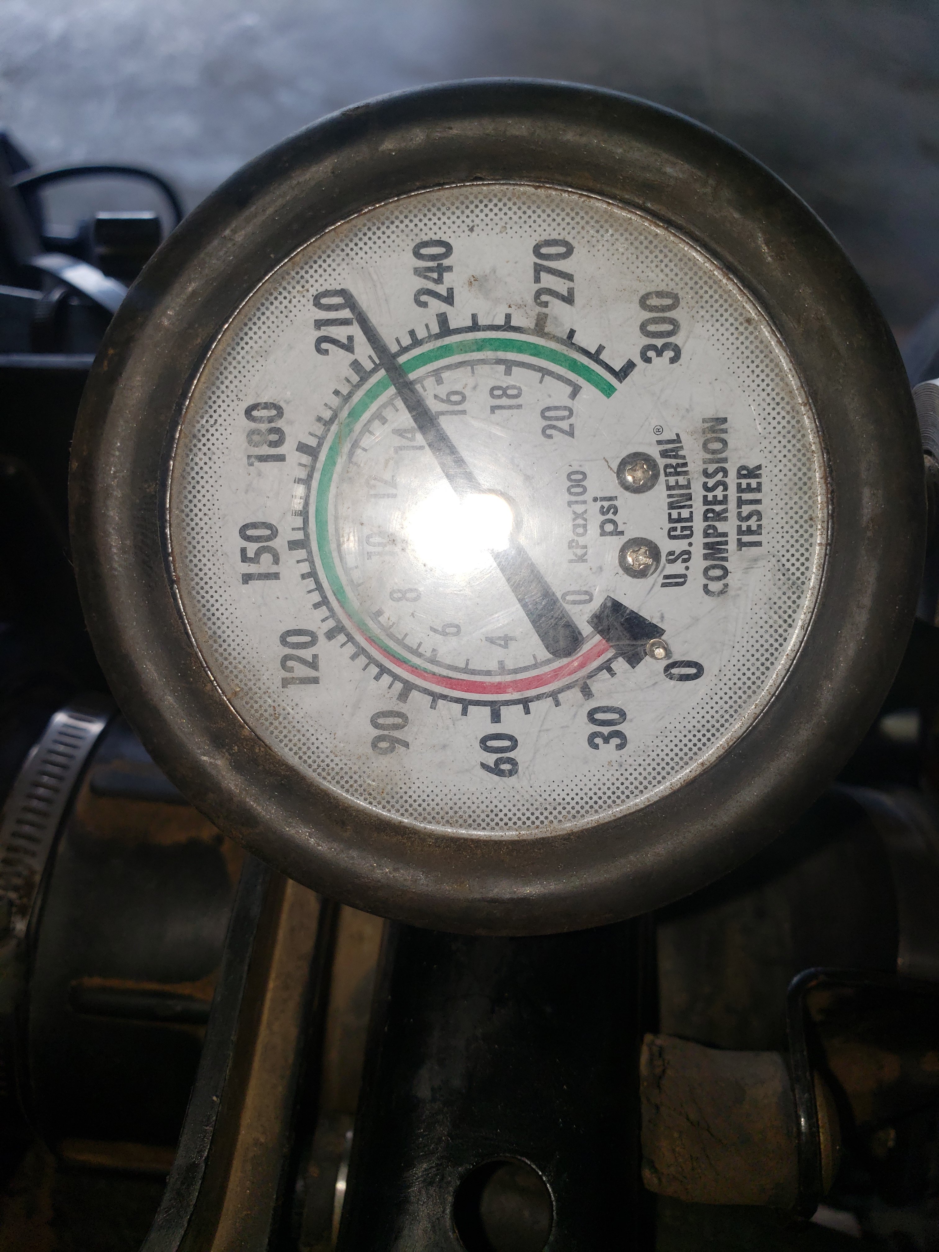

Everything every forum has spoken of I've bought sealed airbox completely tight unplugged black wire on trans. I have literally done everything in the book.Checked oil today full of gas anyone no anything what might b wrong. Next I'm taking head off and making sure valves seat any ideas.
A leaking valve isn't going to fill the oil with gas. Plus you can check valve leakage with a leak down test with the head on.
I would be looking at the carb. The needle and seat is not working right and I bet the seat of the needle is leaking. I posted about this problem recently on here in the Polaris forum. Booth units I had that problem with were Polaris 500's.
Be sure to pull the oil drain plug on the bottom side of the crankcase to drain the oil from the crank case. Just draining the oil from the bottom plug of the oil tank will not empty the crank case that is full of fuel.

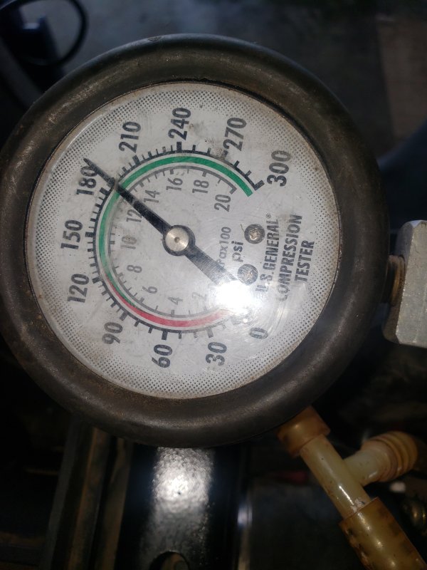

No it starts and idles perfect but when you give it gas it starts backfiring through the card horribly bad and it takes it forever to start keep turning it over it will pop a few times then it will eventually start and idle smooth as rain until you hit the gas replaced everything you can think of still same thing and its perfectly in time I don't understand it how can you do bleed off to check the valves with a compression tester
No that's the only test I haven't done yet been reading all the forums so figured that stuff was what was wrong its doing same exact thing so didn't put much thought I have checked time and its smack dab on so I'm stuck besides compression check and make sure valves are seated. I have a top end gasket kit just blows my mind cause any other 44-wheeler main jet or sec jet is clogged I went over this one with a tooth brush so not sure where I went wrong
If that compression is what your showing the the only way at this point for fuel to get into your crank case is from a carburetor leaking fuel into the cylinder head and it’s making its way down the cylinder walls.  It has to be. Maybe separate the carburetor from the engine leaving it completely hooked up but pulled away from the manifold connecting it to the cylinder. As if it were in place but pulled a bit away from the engine.  See if you  notice any gas dripping out of the carb where it connects.  I would put a small piece of cardboard under it since cardboard shows moisture right away when it’s wet with the dark brown spots.
Not too sure about your make of quad but the Yamahas have a mikuni carb.  The brass plug which contains the seat has an o-ring around it which breaks down eventually.  This causes fuel to bypass the needle and seat and can flood the carb.  Notice any fuel in your air box?  Also the high compression readings make me wonder if you are partially hydro-locked.  If possible pull the seat out and check for that o-ring.  It happened on my 03 Kodiak.

Had a similar issue with a Kawasaki once.  Crankcase is full of gas as a symptom of hard starting, so that's easily resolved once it starts correctly.  That compression is also a bit high so that's odd.  It's either a carb issue or bad plug. If you haven't replaced the spark plug yet, do that.  That ended up being the issue with my Kawasaki.  The plug wasn't firing hot enough under compression.

I don't care if the carb is brand new. You have a leaking needle seat like I and the previous poster mentioned. Your compression tests are extremely high because the motor is flooded with fuel and almost to the point of liquid lock, further cranking of a liquid locked motor can also cause rod bearing damage and failure.
The needle and seat will be where it's supposed to be yet it is not stopping fuel from flowing from the back side of the seat where the o-ring that is suppose to seal and hold the seat in place. If you take the needle and float off and the seat is easily pulled from the carbs body it is leaking.
Even a good sparking spark plug will not spark when the carb is delivering too much fuel.

Well put it 100% in time got the compression down to 138-140 but that's all it did still doing the same exact thing. Question though will it still give gas to the carb if your not turning the bike over like if I take gas line off to the carb gas still comes out. I checked the carb it is not leaking gas any where pulled the spark plug and nothing blew out of it it's not getting liquid locked at all. So I'm tearing the head off of it today to take s look at it. I lashed all the valves at .006 just figured I would ask you guys if it sounds right that's what my book says.
