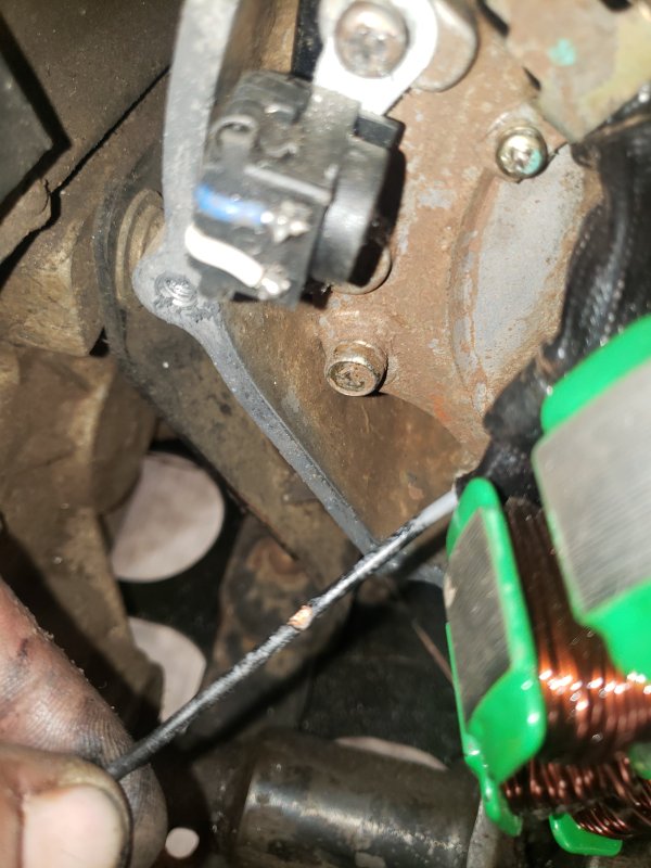

From the post I quoted it looks like the stator plate has to go on in a specific position ( otherwise your timing would be off) I’m not sure what it looks like from you perspective, did it have some indexing marks or anything? Also, are you using the stock fuel pump or do you have it directly run from the fuel tank to the carb?
Edited by BuggyMasters
I'm using stock fuel pump I tried running it straight to the carb and it did the same thing I didn't see no Mark's on stator plate but then again I wasn't looking for any either I just put it back where the old washer mark were from the bolts. I'm just stumped idled great with other electronics on put brand new on not cant get it to stay running for more than 30 seconds now weird
On the new cdi box and stator theres a white and white/red from pickup coil where the 2 plug together I think the clips molded wrong goes from the white from stator to white/red of cdi box then white/red from stator goes to white of cdi box wiring diagram says the colors should match so I'm thinking polarity to cdi box is backwards opinions anyone and there molded ends
