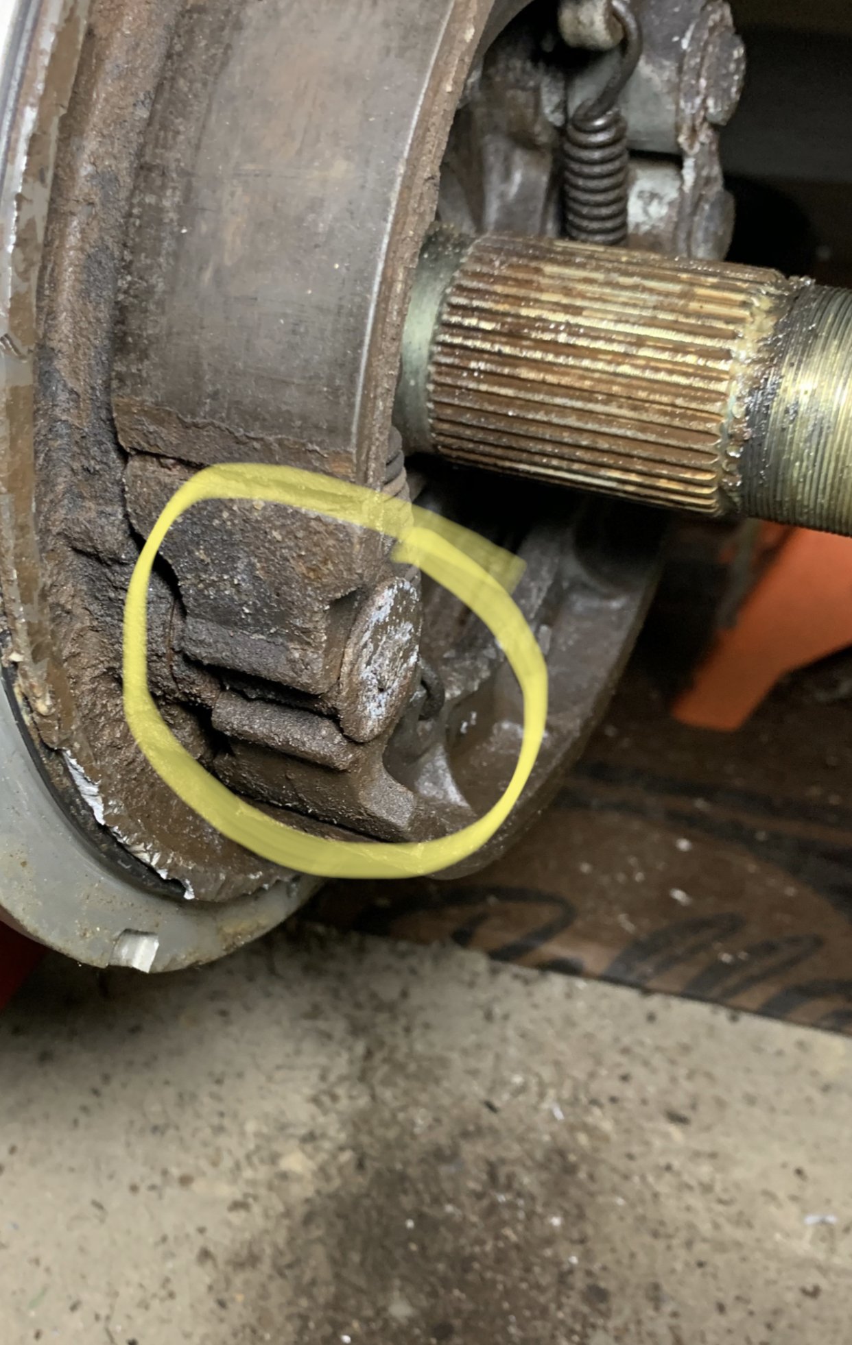

drum just needed to soak I guess.  I sprayed it down real well lastnight with lube and tonight it slid right off.  The pads look like they have plenty of pad left.  Now I don’t know what needs to be done to free the brake up.  Does the cam turn pushing the pads out against the drum?  Do I just need to lube up the cam and try to work it back and forth?  I don’t really see anything else that would move.  As you can see from the pics, I messed up a few places of the backing plate.  I’m wondering if that matters?577105B3-ABB0-45E0-96D8-44932F930716.thumb.jpeg.a2cd3007ba6b55c0a0d6513f5bf49e3a.jpegB2AC9940-5D57-48D8-9C70-AE8C2F51BD6D.thumb.jpeg.2cbccf34257f41d32da4dd617cb1c1bb.jpegBFB92477-A803-4ED7-8DD7-E1757C38D196.thumb.jpeg.8fff11e9f2e41072f7096ff633638b66.jpeg
Nice work brother. So spray the cam lobe with penetration oil as well and let them sit. The cam should rotate with the brake lever and expand the cam in between the brake shoes thus expanding them.
There is a brake grease you can and should put on the lobe when your all free and moving and ready to close it all up.
The area I circled should move. Spray the sh** out of everything except the surface of the brake pads and hit everything with a wire brush.  You can out blue painters tape on the brake pad surface before spraying it all down.
Ok, kind of what I thought but can honestly say I’ve never really messed with drum brakes before so wasn’t 100% sure.  Will lube it all up this weekend and hopefully get it put back together.
spent some time in the garage this weekend.  I ended up completely disassembling the entire rear brake; pulled the brake pads off, removed the brake lever and pulled the cam out.  The cam was all rusty and nasty.  I steel wooled the sh** out of it and got it nice and clean and smooth.  Put a very generous amount of grease all over it and slid it back into place.  Put it all back together and boy is it rolling smoothly and brake working nice now.  I just need to adjust the parking brake as it has too much slack and the lever doesn't engage the brake.  The foot brake pedal works good though.  It's now back down on all four wheels.  I believe all that's left to do is top off the oil and some fresh gas and should be ready to fire up.  Stay tuned.
