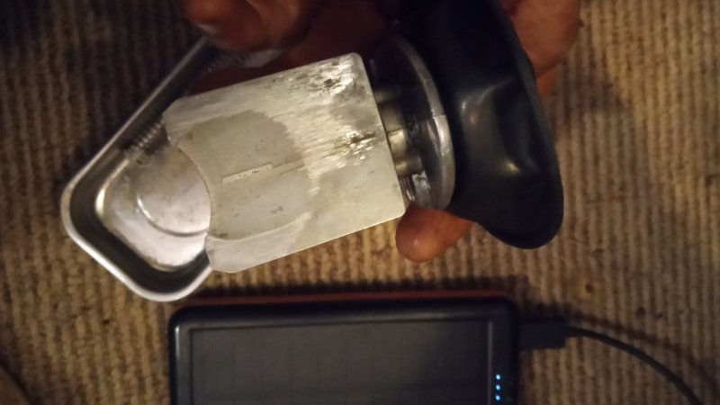

Oh actually, that spring you are holding will be the 10mm one.. so you have a steel cover..  Ok, so that spring goes down into the needle tower and is meant to keep the needle down.
12 minutes ago, Mech said:
Without the O ring the needle jumps up and down and fuel gets chucked in there in a completely random fashion, and generally far too much of it.. And that doesn't look like any part I've ever seen in there for the job. It normally is about 20 mm long, has an O ring on the bottom then a flange and a flatter part that's serrated so it can be grabbed with a pair of pliers..
Find a bit of rubber hose about 6mm diameter and use that to jamb down on top or that spring temporarily and see if that fixes it. If it's held down by the spring it will move up, but against the spring pressure, not completely freely.
The spring sits in a bulb under the carb lid and it sits pretty firm it pops the cover once the screws are loose
Yes
Just now, Mech said:
Yeah, and the spring goes down into the slide and presses the needle down into the slide so the needle can't jump up and down...
I ordered a rebuild kit with the gaskets and o rings and all the Jets so I can replace them, so there is supposed to be an o ring under it?

I did check the float and it was off a bit but I adjusted it and the needle is set 4th from the bottom, the slide does have some wear on it from rubbing the housing
Before you put the needle back in see if it has some numbers on it.. let me know what they are.
Yup I saw about the float height.. If it's as the book says it won't be the problem.

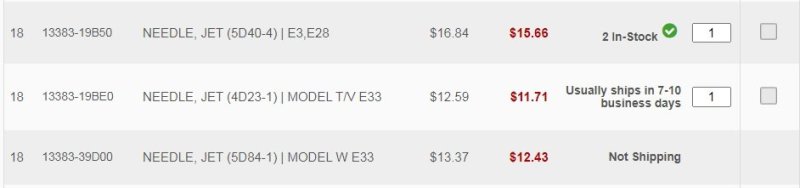

I have wondered that same thing about carb kits, i bought a more expensive kits to rebuild mine that had good ratings, because i didnt know anything about the carb, both ebay carbs, wheather it had already had a cheap kit put in it, i guess the only way to know for sure on an old used bike is to but new suzuki jets and needle. Unless i can figure out a way to tell if i have original suzuki jets. Still working on that. Yours may not be original either, how do you know.
I cant find any numbers on it or the slide
The jets i took out of the first one i rebuilt had the correct jet # on them for that carb, but the all balls kit i bought also had the correct number on the jets, i dont remember seeing a number on the needle, i will look again with a magnifying glass, they seem to be printing these numbers smaller as i get older.
The important thing Gw is to make sure you have all the jets and needle and settings right for one of the models..  The problem is not so much having the wrong set of jets, it's having muddled sets of jets. You have to have the idle air jet, idle fuel jet, and the idle screw all right for one model, and then the main air jet, main fuel jet,  emulsion tube, slide and needle, all right for that same model

I'm not proposing buying any needle.
If I was, because a needle was bent or lost, I'd check the carb specs and buy a genuine needle for that carb..  No guess-work involved. It would be right.. And japanese !
That's a good policy, especially for a professional working on other people's carbs.  And I would probably buy genuine OEM needles for something I really cared about.
But I've used Shindy kits in the past without a noticeable issue.  And a Shindy kit with needle, jets, float needle and seat, and gasket costs about what an OEM needle costs.  I wouldn't fault someone for using one.
$16.74 at Amazon  https://www.amazon.com/Shindy-Carburetor-Repair-Kit-03-209/dp/B003CK89TE
