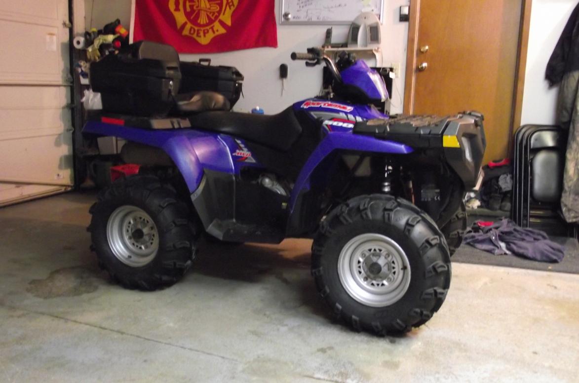

So I broke down and bought some tires today. I picked up ITP Mud Lites XL's 26x9-12 for the front and 26x12x12 for the rear. I mounted them on the stock rims and there was a bit of a clearance issue on the front with the tie rod ends. They rubbed so I flipped the tie rods to the bottom and everything seems to be perfect now. I also did a wheel alignment after I flipped them.
Kind of strange was when I did the alignment and I did my first measurement before I flipped the tie rods the toe was way off. I had probably 1/2 toe in instead of 1/8 toe out. After I flipped the tie rods and the toe was almost perfect with 1/8 toe out with no adjustments. The only thing that I can think of is that the guy that owned it before me had fliped the tie rods and traded it in on a new machine at the stealership. The stealership changed the tie rod ends and put new ones on for me and put them back on top without doing an alignment.
Now all is well and I cant wait untill I can get out and ride next week.

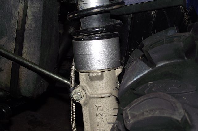

P.S. I also put in the PVC spring spacers tonight to help with the sag in the front end.
Has anyone used these before and how does it change the ride?
