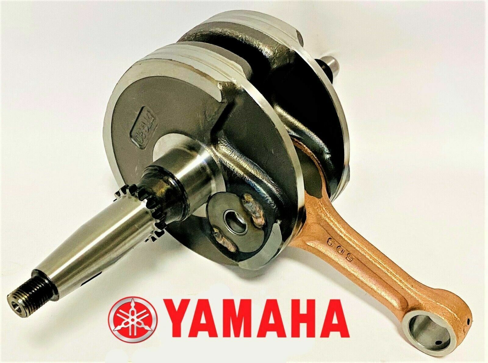

OK Quadrunner motor just sounds yucky turning it by hand.
I always pull a side cover off so I can rock the crankshaft back n forth by hand looking for any slop in the big end rod bearing.  If there is any slop there the motor is junk.  You'd have to split the case and send the crank off to be split and new rod installed and welded.  It's not worth it.
Me and a buddy learned our lesson about buying a cheap quad to fix up and ended up having a bad rod bearing.  We fixed it up and sold it cheap just to get our money back but we didn't feel good about it.  Now if any quad is questionable I always check the rod bearings first thing.

" If there is any slop there the motor is junk.  You'd have to split the case and send the crank off to be split and new rod installed and welded.  It's not worth it.".
They aren't that bad..  The rod kit is often about the same price as a piston, and they are easy to rebuild, it doesn't take much at all, a set of centers is the main thing, to align the crank when you assemble it. My sons used to overhaul cranks by themselves when they were thirteen, using my vices to press them because they found it too awkward to hold the puller, and pressing plate, all at the same time..  They broke two of my vices doing that.. little buggers.
That's interesting.  Thanks.  I don't know much about it.  Just going off what Vince at Vince Cycles told me.  http://www.mrcrankshaft.com/
I was going to send my crank to him for a longer rod and welding.  He said if the engine is revving and the wheels hit something solid the crank twists on the pressed-in bearing which causes the weird vibrations I had, so to prevent that he welds them in place.  Right after that I upgraded to the 250S engine and never pursued it.
But splitting the case is more than most people want to do, then having to split the crank and press it back together is often more work than what a quad is worth.  I'd do it for a something I was racing or something special like that, but not something to flip for money.
Wheels hit solid things all the time..  I think Vince is having you on. If a gear broke and the gearbox locked up maybe.. but a wheel.. Pffff..
Anyway, when I was young and not very careful I put a crank together and didn't align it carefully enough... you know what happened..  It vibrated for about three seconds then started to get smoother and smoother..  My sons have done the same.. After a few revs they are as good as gold.. and go for years.. Weird aye ?  But then I wouldn't have been building race engines like you.. I just overhaul them.
About the minimum you need to do one is some way of pressing them apart, I use a thick disk of steel with a slot in it, and a hydraulic puller, then V blocks or a set of centers, and some sort of dial gauge that reads thou.. A bit of angle iron to align them as you start to press the second half on and then learning how hard to tap them to align them..  basic hand skills. Seriously, a kid can do it..
I don't have enough experience with cranks to judge what you're saying but Vince is MrCrankshaft and rebuilding cranks is his bread n butter.  And what he says makes sense and explains the vibration that kept my motor mounts coming loose.  And if cranks will naturally realign themselves then why do they weld cranks?
It seems plausible to me that if one side of the crank suddenly stops from a shock through the driveline then the other side could twist around the pin.  And it doesn't seem plausible that the two sides would naturally realign themselves back into balance unless the fit were too loose in the first place.  Because if it took a big shock to move it out of balance then merely revving wouldn't be expected to fix it.
I just guessing but maybe your method of splitting the crank causes the holes to wallow out leaving the pin loose enough for the crank to balance itself.  But if that is true then any shock would knock it out of balance.  The back n forth in and out of balance would wear the crank pin and holes.  Maybe that setup is good enough to ride around on for years with minimal driveline shocks, but maybe not for hard riding on rocky mountain trails.

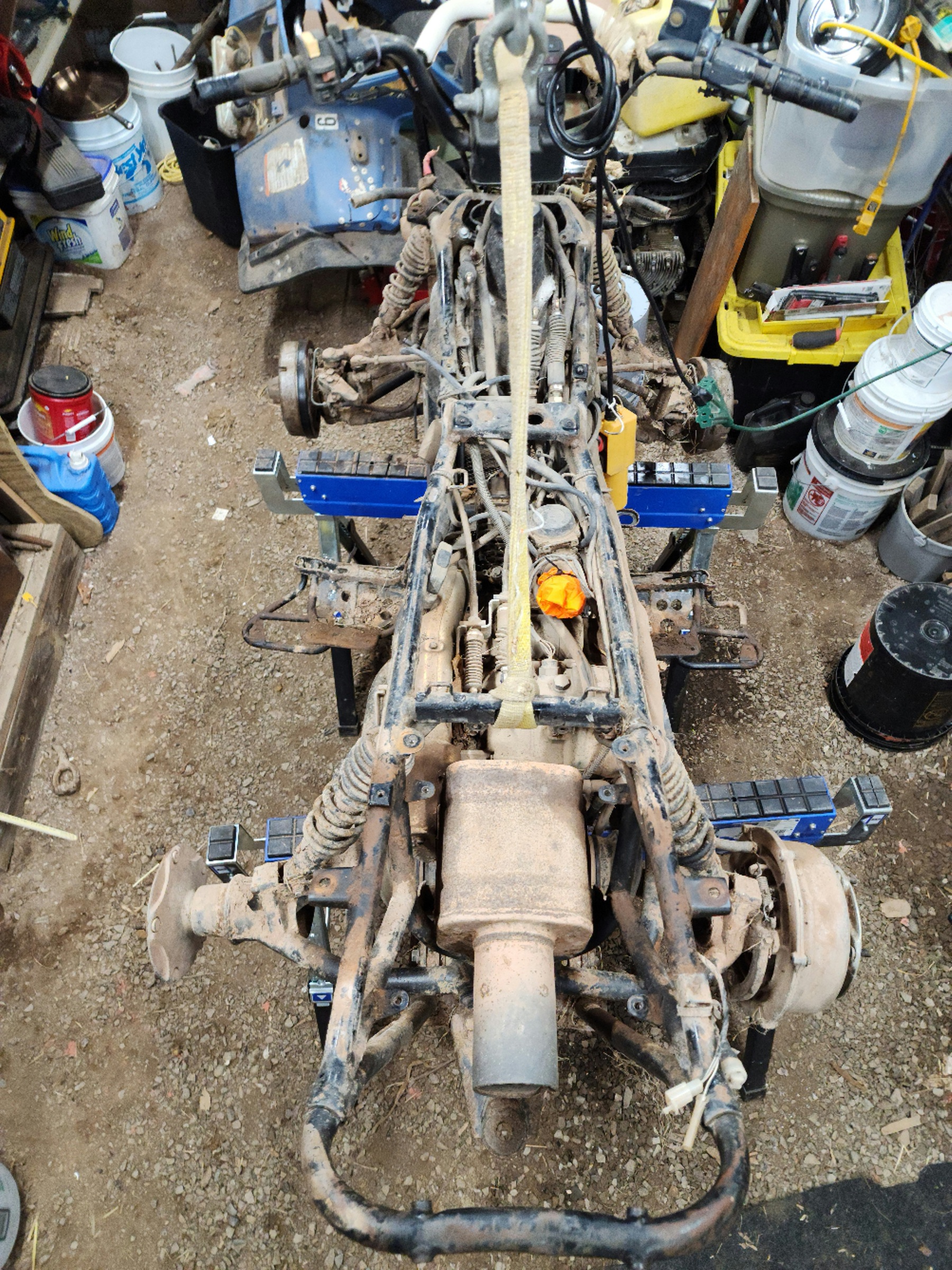

King Quad ready for a bath. A couple of hours work. So far I think I might have a good one. It spins in neutral and first. Front diff shifts and spins. So far no crazy noises.
That's good news.  They are fairly durable machines.  The weak links are the intake valve and regulator.  And speedo cable.
There are mods you can do to get the front diff locked in any range.  I forgot how but I know it's possible.  Also a mod to start in any gear.

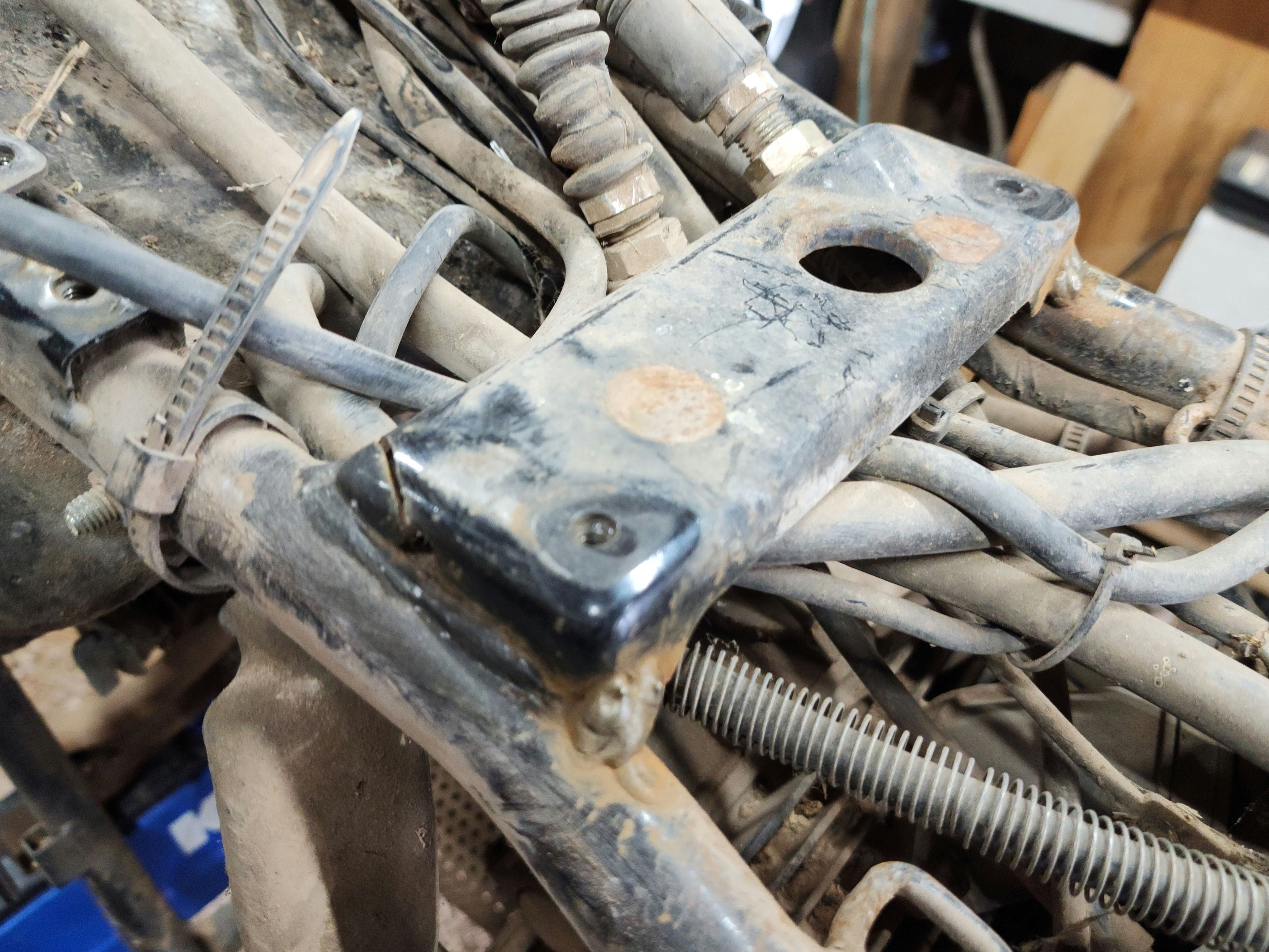

That hole in the frame in the picture is where I put the funnel to add oil to the engine.  Just take the intake valve cap off and put the funnel there.
