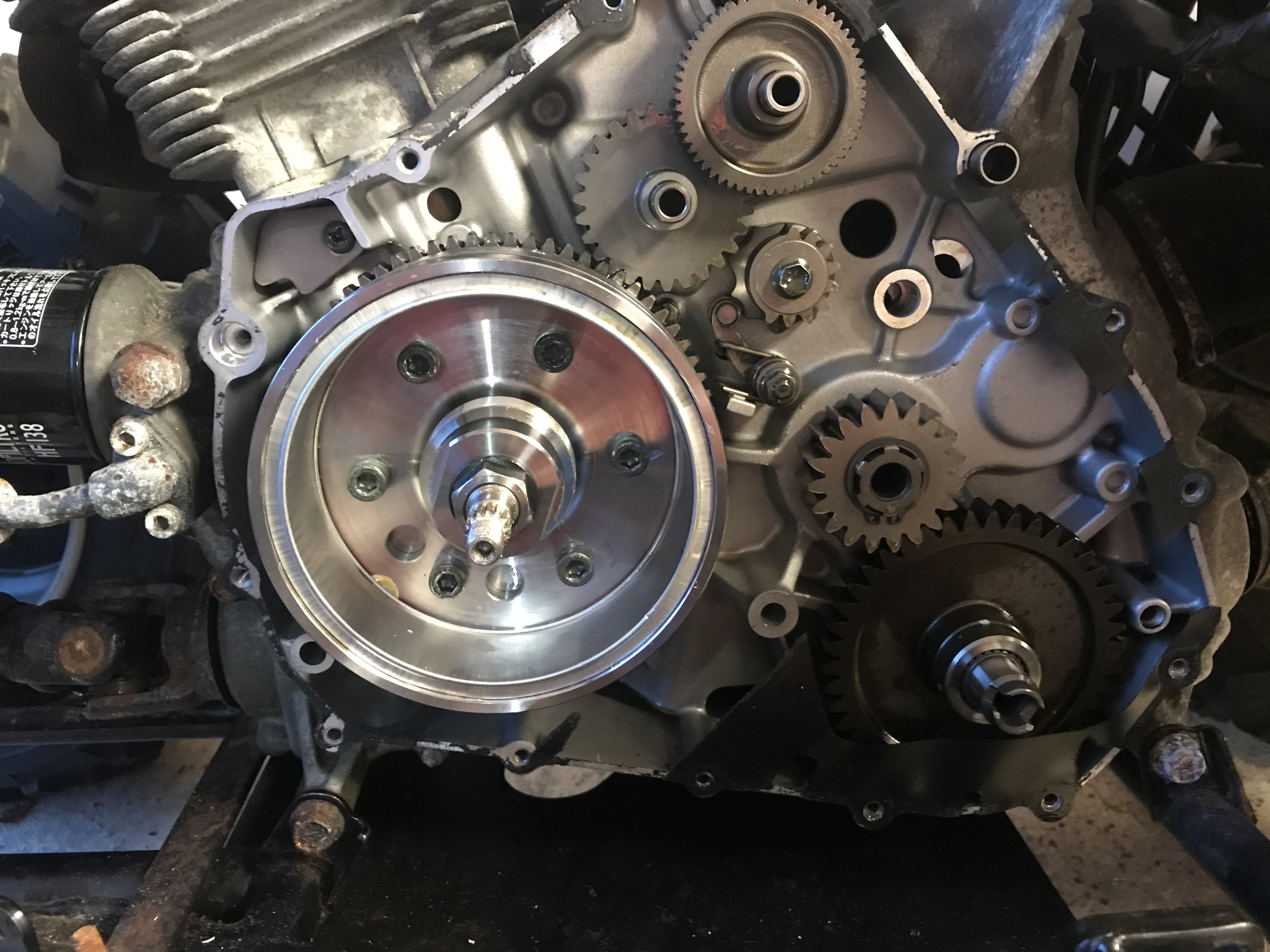

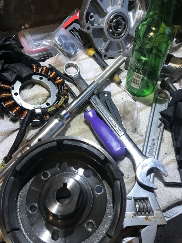

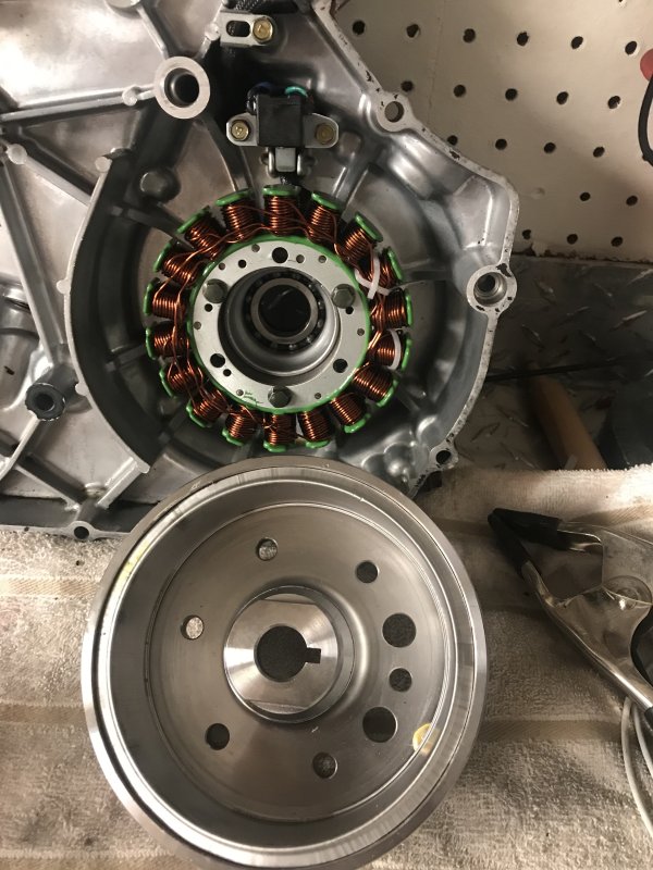

Ok so new flywheel is in and she fired right up.  Huge difference, i can get to just about 80% throttle without any backfiring.
The carburetor is still in need of tweaking but i think the problem is solved.
Unreal that something like this can happen.  What baffles me the most is the magnets on the old flywheel are solidly in place but yet they are incorrectly placed??? I tried to pry them off the flywheel with no luck.   So strange!
Going to get after the carburetor tomorrow and take it for a spin before i put it all back together.
Keep ya posted.....
  • Thanks 1
@Frank AngeranoWhat are the chances that the glue turned loose from engine heat and then restuck when it cooled off?  Looking at those magnets better, I'm almost positive they bunched together with glue in a liquid state due to centrifugal force.
Either way, that's a first for me.  Seen em cracked, falling apart in pieces, missing chunks, turned completely loose.  But never bunched up like that.
@MarkinAR i am completely baffled. Based on what i have found and what i have replaced makes perfect but no sense at all. There is no way this engine could have ran properly the way it was.  So anyway im going to write this off as an unexplained yet obvious solution based problem. @northernmi thanks pal.  It all worked out in the end.  Now i have the task of re assembling the rest of the atv and i hate that part.
But thanks to all that commented, we are on the uptick!!
Pics to follow.
