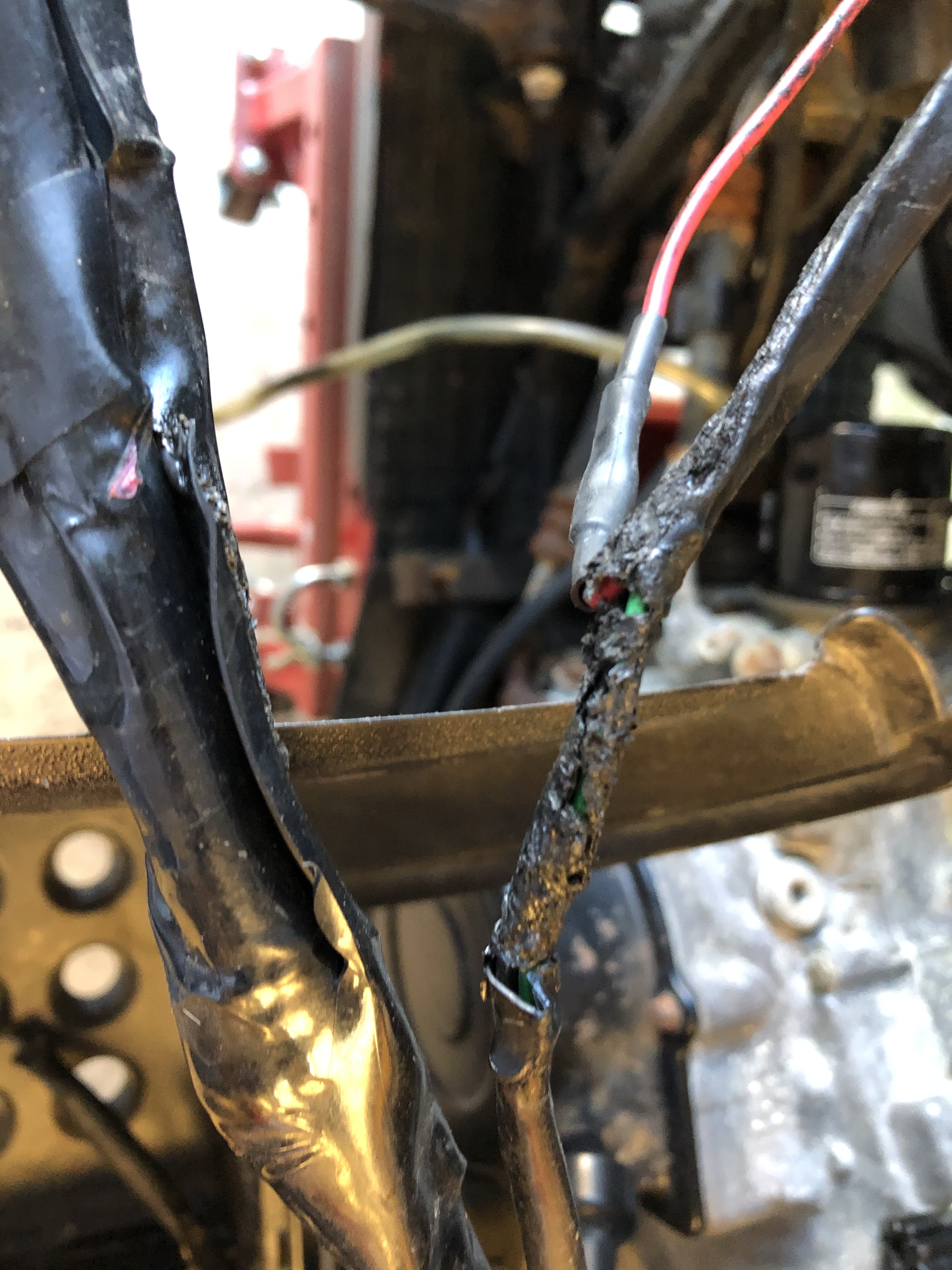

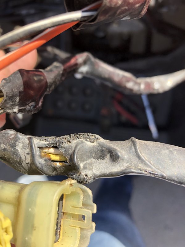

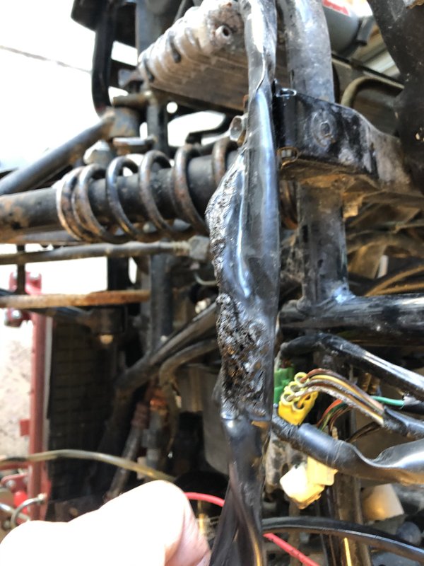

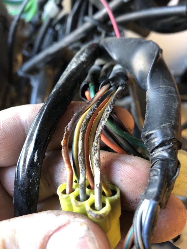

So !!!!! Pulled the carburetor off to clean it up. It was already clean and ready to go.  Found a small fuel leak on the bowl due to to the seal on the bowl not fitting correctly. Ordered a new kit with the gaskets included.  However I found worse, there are patched wires from what looks like a small fire. I picked apart the wires as best possible but it seems theres a short someplace within the harness.   I had it running for a while but will not rev. So im going to dig deeper. Some people suck! The previous owner knew there was a fire and hid it pretty well.

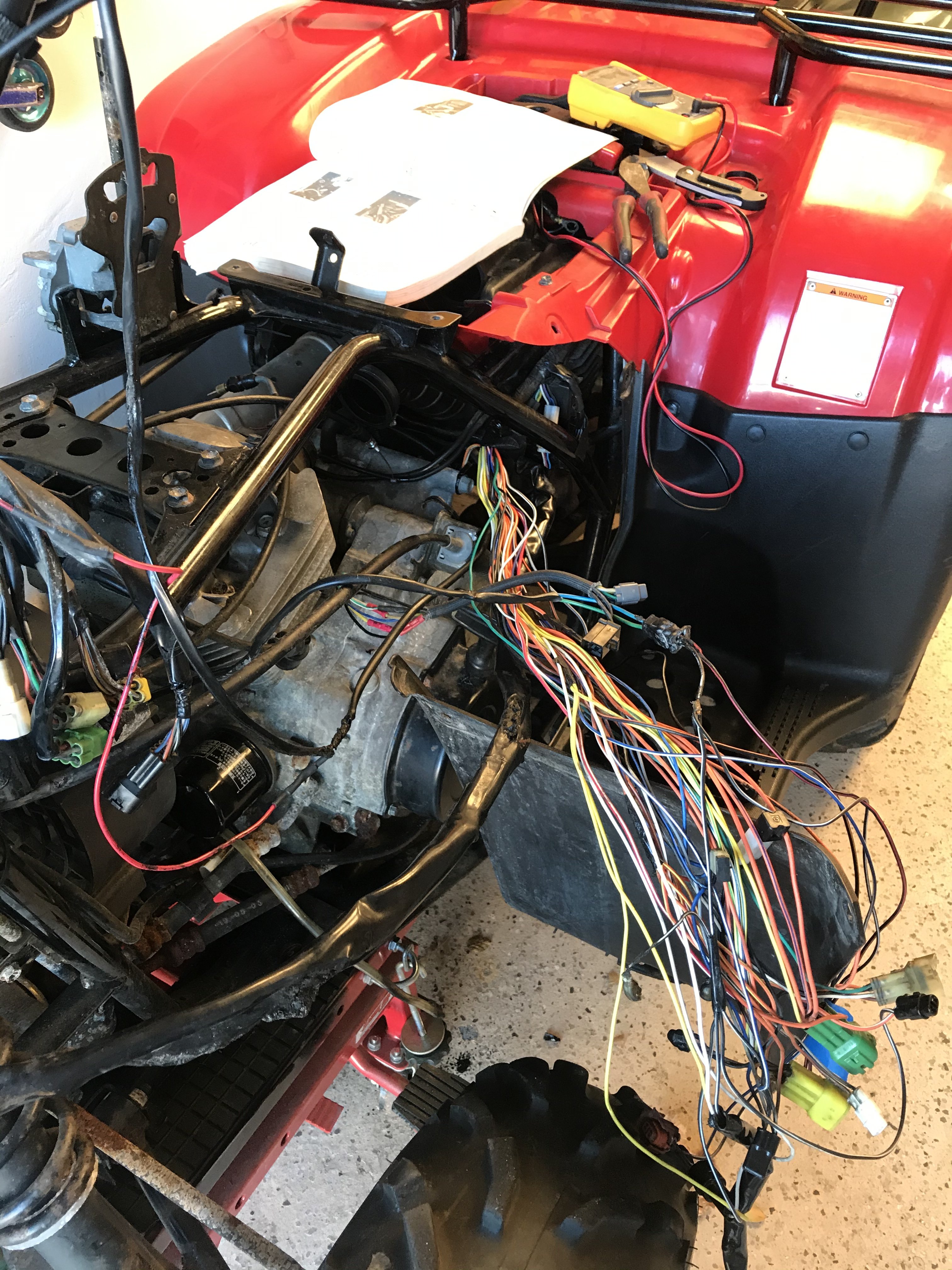

Lol. Found a harness $65 bucks oem. Its on the way. Perfect condition. Canceled the other one.  Also putting a new rebuild kit in the carburetor. The bowl gasket is not sitting in the grove correctly any more so i have  a drip.
Update: New harness is installed and carburetor rebuilt! I thought for sure this would solve the problem since the spark looked 10 times better. NOPE! The engine refuses to rev past half throttle.  Carburetor is 100% good, i have a lot of backfiring as well but that was also going on before all this. Tested all components except the cdi and we all know why we can't test that little fucker, but everything else is well within spec.
