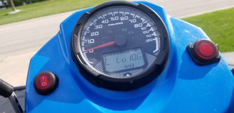

This is an old post and the OP has probably already long since fixed his..  But for the record.. That low battery message is not to be worried about, it can come on any time the battery voltage gets too low, which it can apparently if you idle around or run too many accessories. The manual says to rev the engine in neutral for a few minutes. If that original posters's bike had sat for a bit the battery may have been a little low and starting it up might have momentarily dropped the voltage too low..
