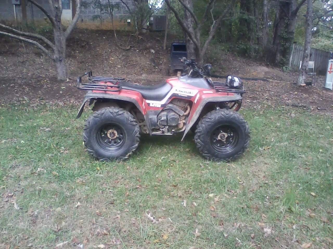

Hey I have a 97 bayou 300 2x4 (klf300b) that i bought for 1000 last June and sunk another 1000 into it already.  When i went to look at it, the seller had warmed it up before hand (he was riding it when I got there).  it ran good so i bought it and took it home that evening... next morning it wouldn't hardly start.  I discovered the carb was clogged, there was chunks of rust in the fuel valve, the choke lever was missing and other things.  I have since cleaned the carb and replaced the fuel valve and gas lines and cleaned out the gas tank and cap.
Enough background on it, the problem is this:  It floods if i push it past half throttle in 4th and 5th gear even going downhill and shifting correctly.  It also has to idle and warm up when you first start it which is really annoying now that its cold...  It also smokes blue smoke for about 15 seconds when started cold-  does not smoke at all once warm but the exhaust still smells like burnt metal.  A friend told me that it didn't have enough compression.  I also found out that the valves are a common cause for low compression on Kawasakis..  I have never adjusted valves before-  the most I've ever got into a engine was a head gasket on a riding mower so I'm new to this.  My goal is to get this bike running and starting cold like a top-  should i tear down and rebuild the top end?  What should i try first?  I tore the carb apart and rebuilt it and fiddled with the air screw and nothing changed.  I also ordered a compression test kit that should be coming in soon.
Ive also considered just selling it for like $500 and taking the hit-  Id rather not sink too much more into this machine..  lol

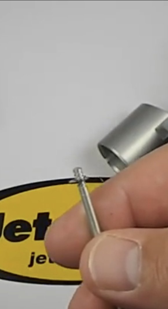

I have cleaned and inspected the carb thoroughly three times now-  the float is not sticking or anything, and its not adjustable to my knowledge.. correct me if im wrong tho.
You are not wrong just not aware. I have attached a pic for you to see.  This is an adjustment to the needle hight inside the carb.  To high the carb will result in too much fuel being delivered.  So take a look and see. Maybe a long shot but def worth looking into. Put the clip at the second to last high spot on the needle and try that. Most common spot is in the middle or second to top. Also Manley sure all the meats are clean.  After that I would go with a fresh plug and check the spark. Just to be sure it’s a good clean spark.

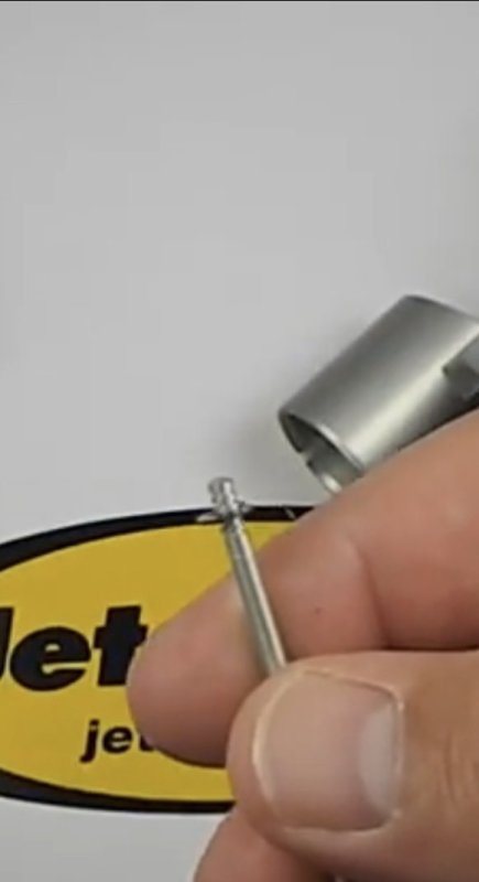

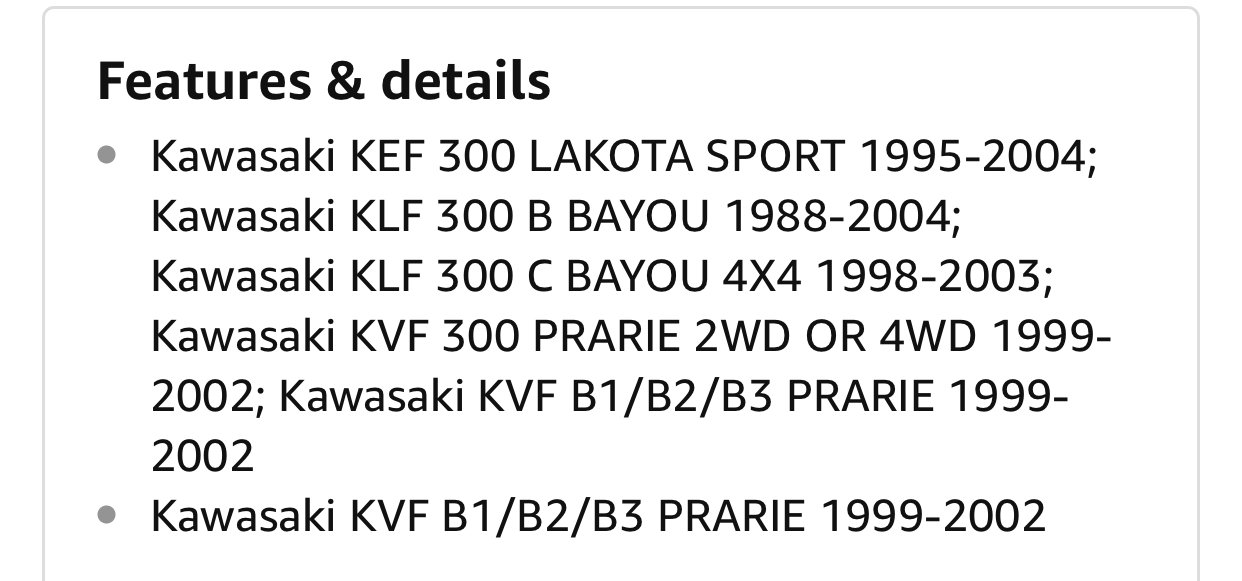

Athena (P400250600300) Top End Gasket Kit https://www.amazon.com/dp/B00PLS6ZXW/ref=cm_sw_r_cp_api_77R6BbVRTF3VG

Thanks, that's a lot better price than the rebuild kit I looking at for $140.  Thanks.

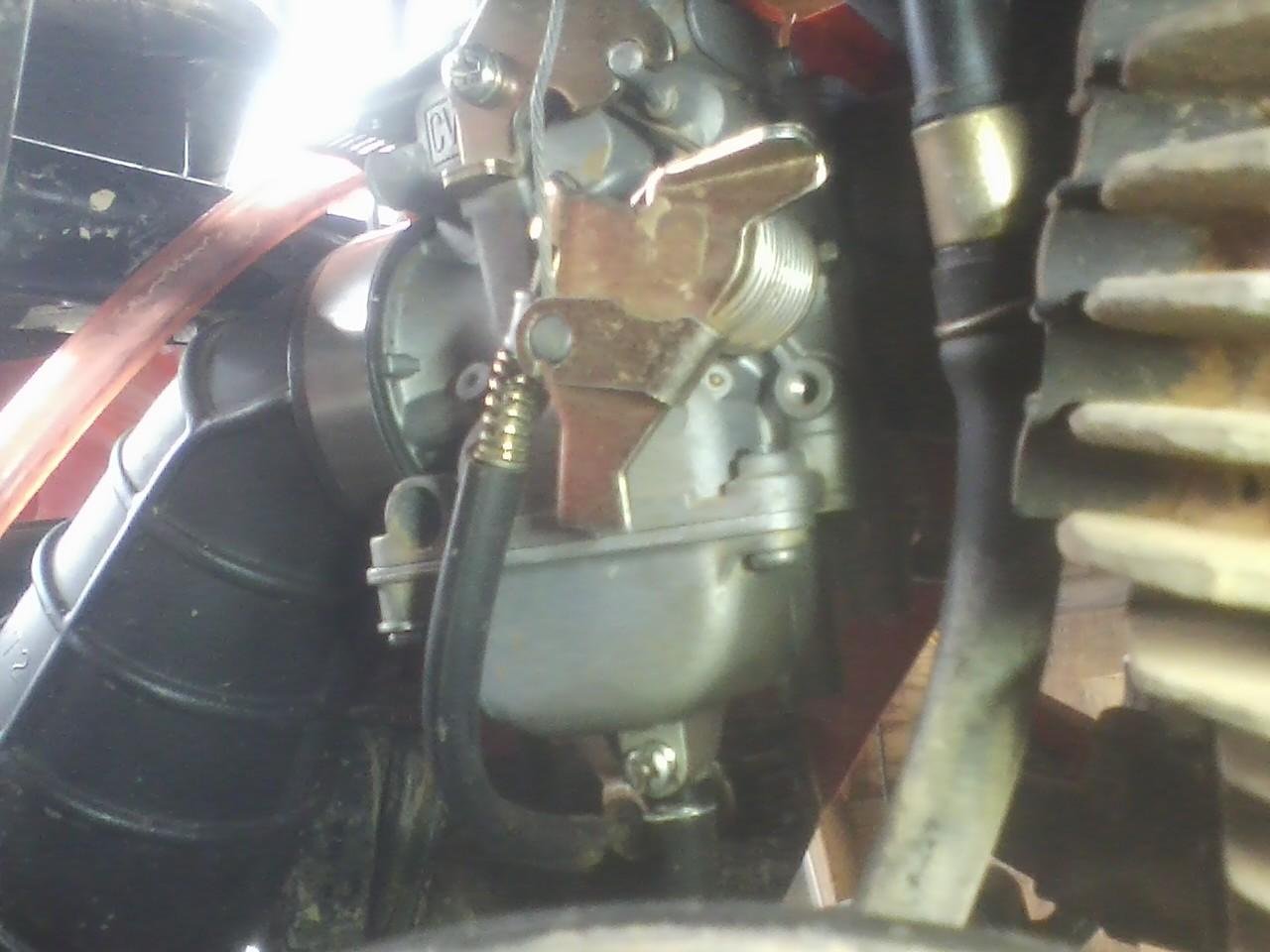

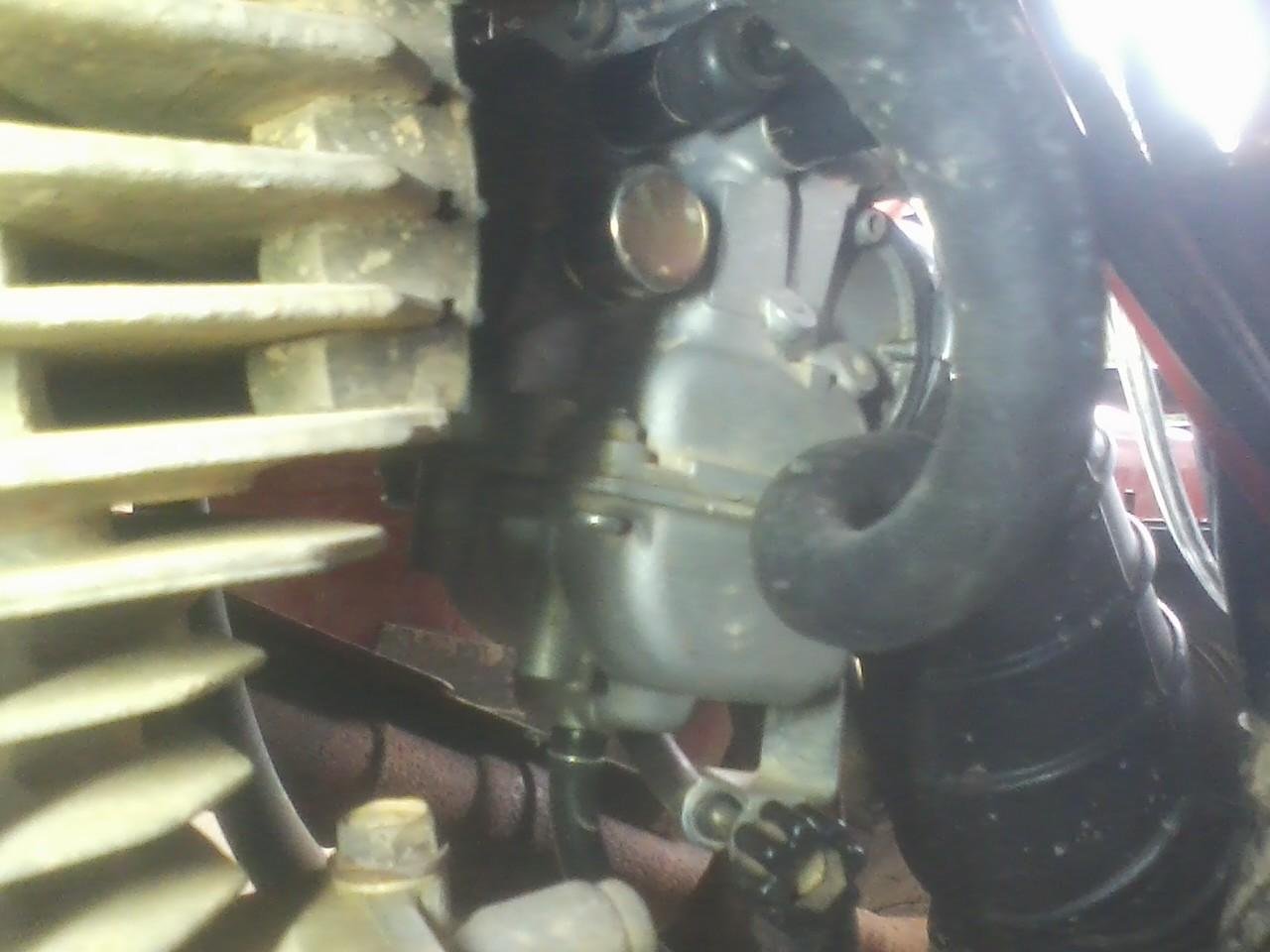

So, I will check the compression, replace the sp, and get this kit for the valves.  I will attach a picture of my carb-  It doesn't look like the one the YouTube vid..maybe the former owner put in the wrong carb?  I dunno..
It’s very possible it’s a cheap aftermarket carb.  Is there a name on the carb ? A pic would be great.

It’s posable that it’s an aftermarket but I can’t be 100%. But by the looks I would say yes. Hears my issue with the aftermarket if it is one.  I’ve purchased one before and put it on my Polaris 90. Bike fired right up and ran good for the first 3/4 throttle. After that it was a hot mess.  So I picked up a used factory carb and rebuilt it and put it in the bike.  It ran great.  I took the cheaper one apart to see what was going on and found nothing!!!!  I put it back on the bike to see how it performed and the same thing.  Go figure.  Not quite sure what’s what but it was def someplace in that carb causing a problem. Maybe the casting when made but not sure.  I am a big fan of oem replacements. Just the way it is. I would try to locate a used factory carb, rebuild  and put that on so you can put that end to rest.  As far as valve seals....  that should stop the burn off you are getting once replaced.
Loop the carb and all the used/new carbs look exactly like my current carb.  And all of them are at least $75.  Should I just eat this or what?  There doesnt look to be ANY difference between the oem carb, the stock used carbs, and my carb.😰
If Im gonna have to pay that much for a carb, I'm probably gonna try that valve seal kit first:     https://www.amazon.com/dp/B00PLS6ZXW/ref=cm_sw_r_cp_api_77R6BbVRTF3VG
That’s the thing with the cheap aftermarket carbs. They look identical and appear to be spot on. I’m not saying not to go ahead and try it but I’ve just had no luck with them.  I like using the oem carbs.
